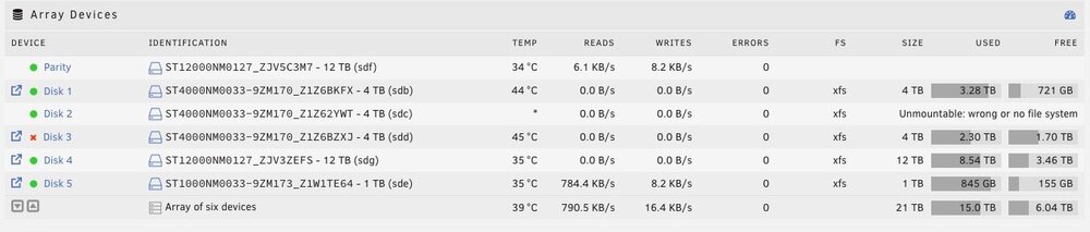

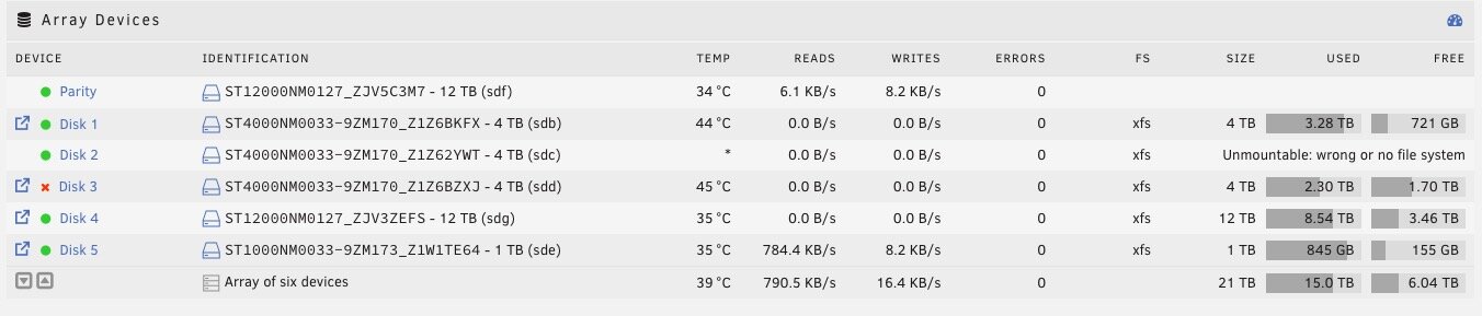

I'm not sure what happened - at this time I am unable to reach two of my disks.
Disk 2 shows Unmountable, wrong or no file system; and
Disk 3 shows a red X and that it is emulated.
I did receive some emails about parity checks that started and these were unscheduled, I didn't think much about it as my daily status update emails had all said Healthy/Pass.
Until they didn't, I guess.
I'm loath to make any changes to hardware or run fixes until I get some direction - for which I thank you in advance.

Connection problems with multiple disks, looks like those are all on the motherboard controller.
Maybe power problem. How are these disks powered? Any splitters? Ideally no more than 4 disks per PSU cable.
Can't make any progress on disk2 or disk3 until your hardware is working.
Check all connections then post new diagnostics.

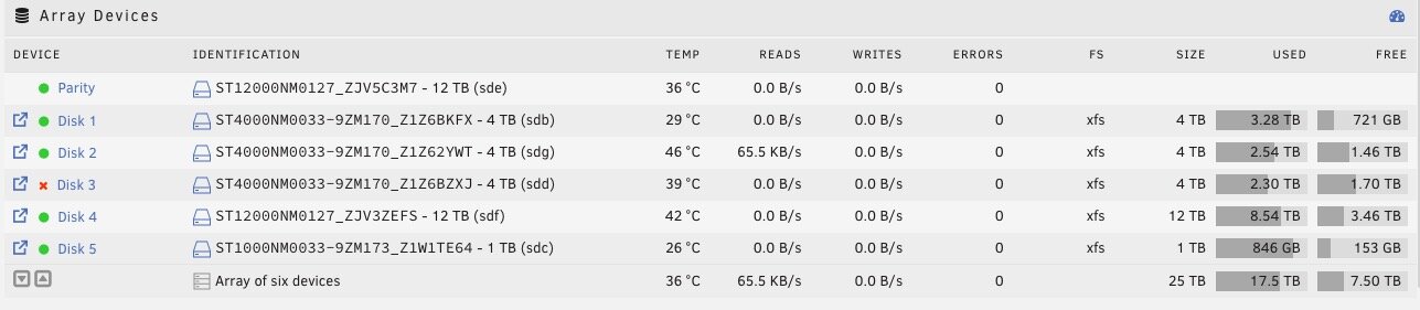

Thank you @JorgeB for the reply and for looking at the diagnostics.
I put the array into maintenance mode and repaired the file system on Disk 2.
The array is now started and Disk 2 is back in the array, which means my Docker containers are back up.
There is about 7GB of files in lost+found on the drive, mostly Linux ISO files that I can download again.

Disk 3 doesn't have a filesystem issue, the disk is disabled, SMART looks mostly OK, if you are happy with the emulated disk contents, you can rebuild on top, recommend replacing the cables first to rule that out if it happens again.
Thank you @JorgeB.
The array is rebuilding on top of the old disk in maintenance mode.
I will move all the remaining drives off the motherboard controller onto the RAID controller.
