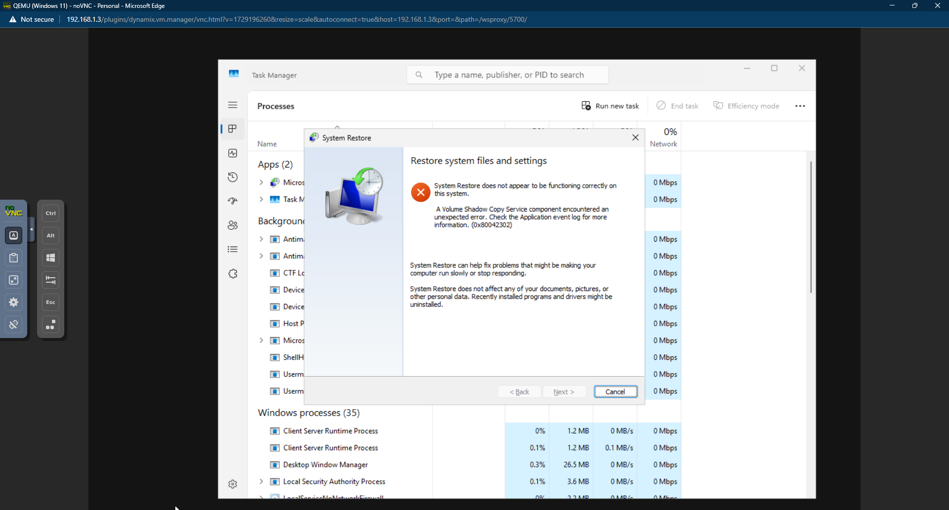

I have a Win11 VM which was working ok up until yesterday. This morning it wouldnt connect to any of the network shares mapped.
Rebooted, still nothing, tried to do windows restore but it failed.
I can log on but I get a black screen with cursor, if I send ctrl+al+del using VNC it shows up and I can go on task manager but cant seem to anything. Now explorer.exe running
Did msconfig and set to Diagnostic start up but no difference and trying to rstrui.exe
Any suggestions on how I can get it running agian?
Just noticed the VM log is showing
