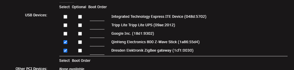

Hoping someone can help me address this issue.  I run Home Assistant in a VM, and have two USB's that run in it.  A Z wave and Zigbee switch.
The Z wave switch loads into it fine, and when the server restarts it loads into it automatically like it should.
The Zigbee switch will load into it if I do it manually, but wont do it automatically on restart.  I am trying to correct that.
Any thoughts?

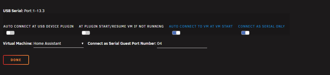

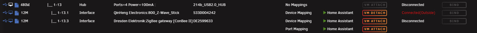

Here is USB manager, and the settings setup for that device, is one of the settings wrong?

You need to remove the mappings off the VM template and let usb manager do it. The mapped outside is because it was mapped in the template.
Thank you sooo much!! That was it, I removed it from the template and updated the USB manager and it's working now!!
