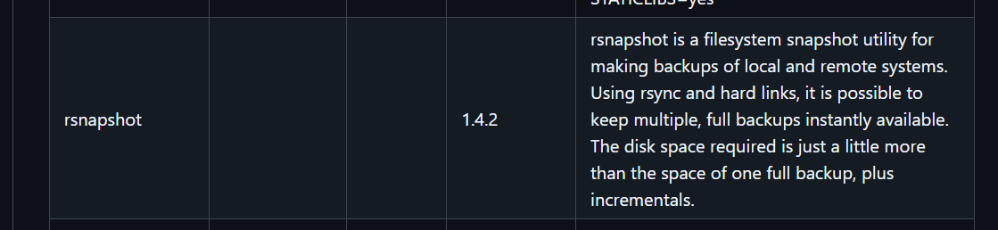

so install unget and add shinji257 repo... then unget-install rsnapshot (this will give you rsnapshot back to unriad v7

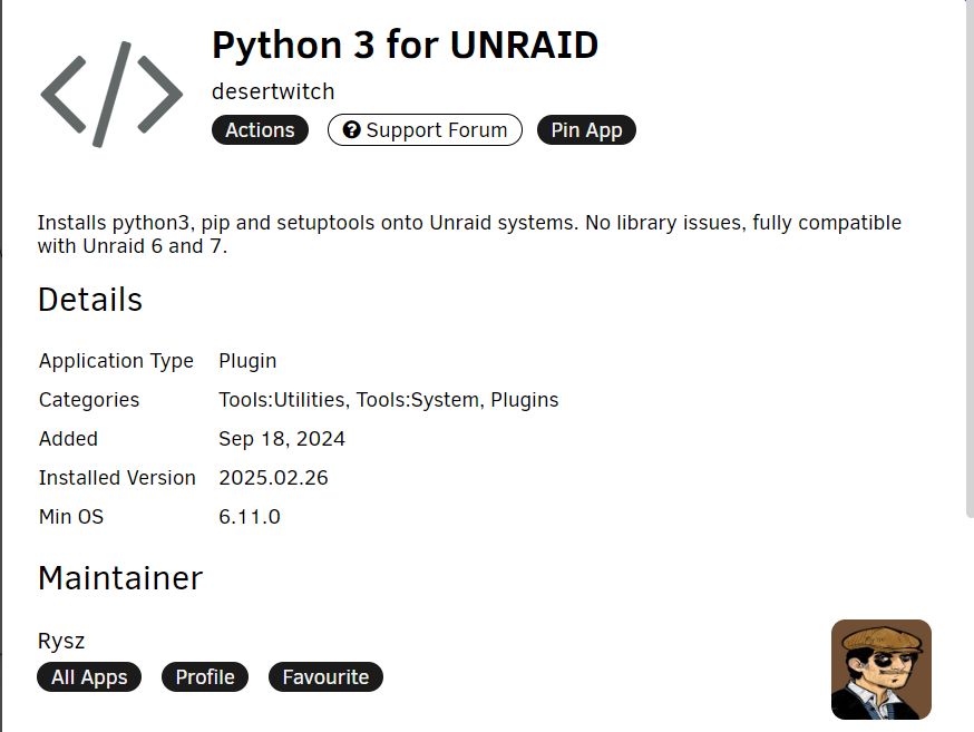

if you need python install

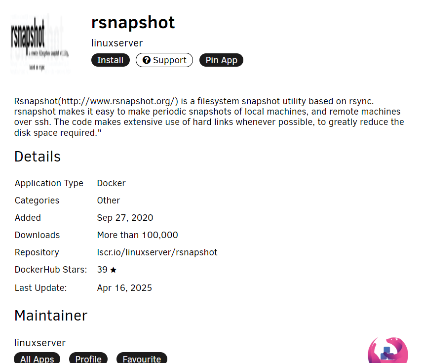

So... did you read linux server's rsnapshot github page...
https://github.com/linuxserver/docker-rsnapshot#readme
they recommend usind a docker compose router... so install teh docker compose plugin and use it to mange... and the github give examples however a docekr tempalte does exist inthe CA...

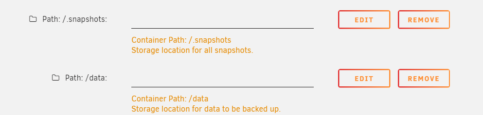

as the docker is all about setting the folder rsnapshot will use...
