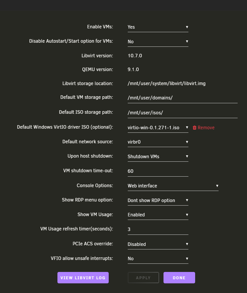

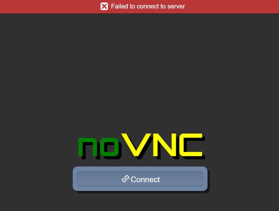

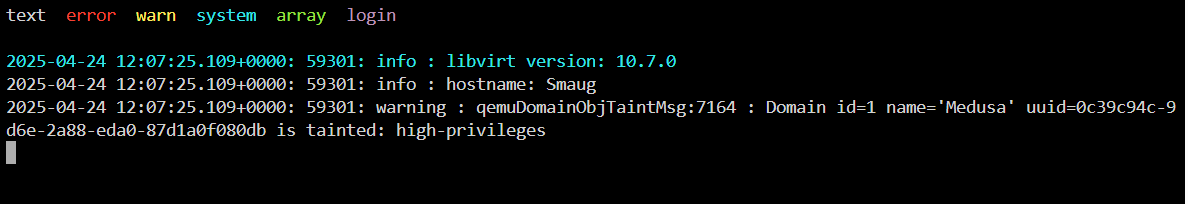

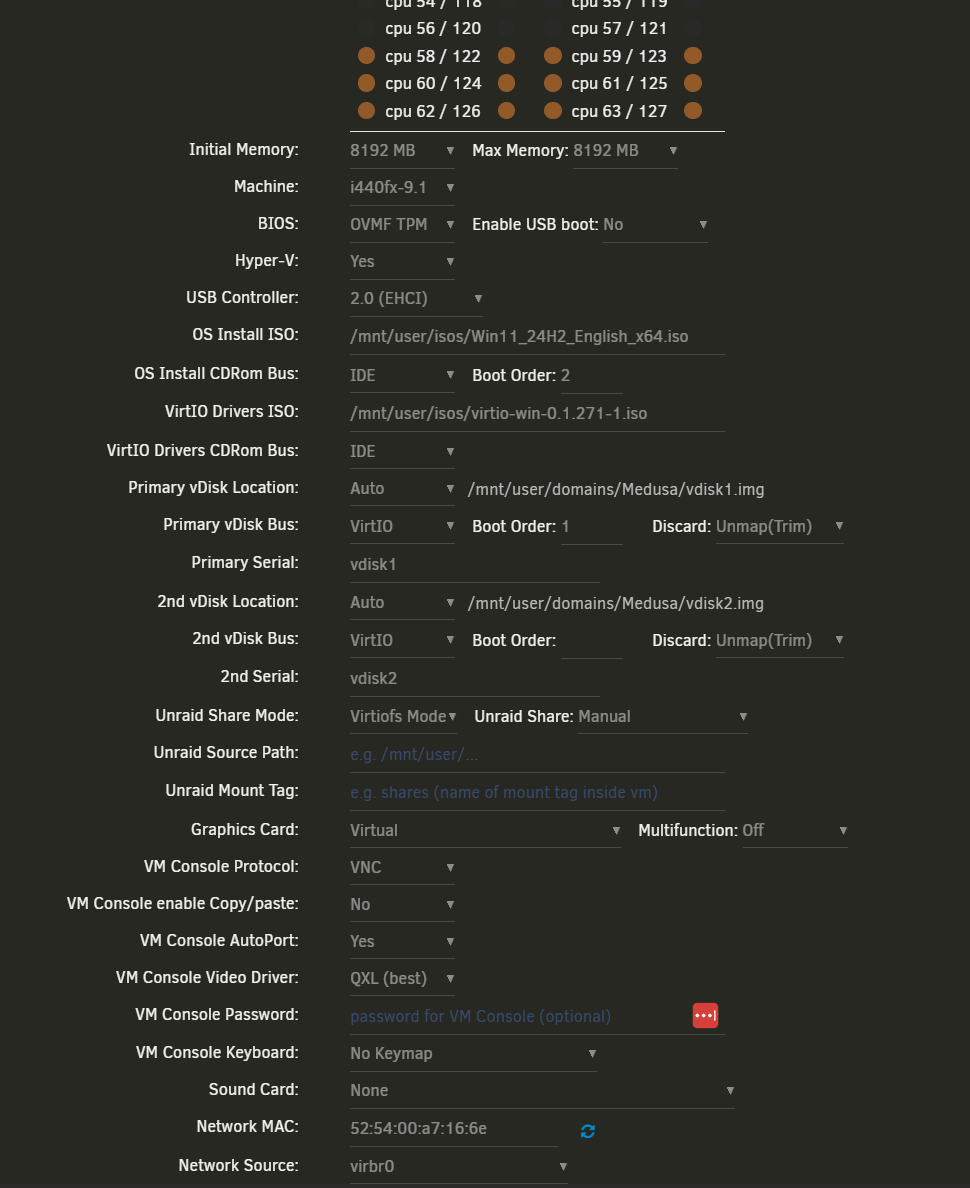

Yesterday i set up a windows 11 VM so that i can install Blue Iris.  i got it up and running and had my first camera set up including codeprojectAI.  was running for awhile just fine then i went back to tinker with it some more and now i cant get the VNC.  it gives me an error that the VM "Medusa" is is tainted: high-privileges.  i have no idea how to fix this or what caused it.  i tried wiping everything in domains and starting from scratch and that didnt help.  Did a little bit of google searching and even tried doing a full system reboot and that didnt help either. Could really use some help here as i normally am able to fix Unraid issues with google and space invader one.  As i dont normally post here please let me know if you need extra data and where i would go in Unraid to get it but all the stuff i currently have is in the pictures down below.

Try clearing the browser cookies, that tainted error is normal and harmless.
ugh i hate how its always something so simple :(
thanks for the help it works again
