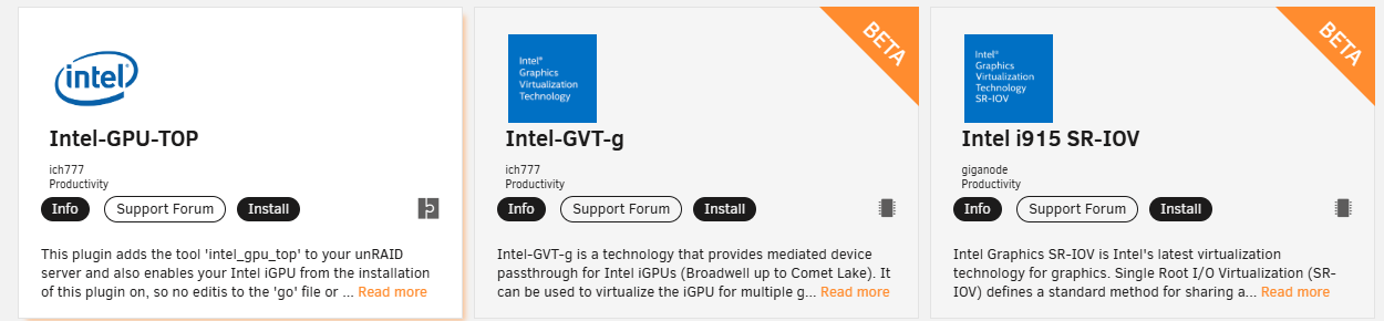

With Unraid, Jellyfin requires a Docker mod option to use the Intel Arc GPU, as seen here:
In Unraid, you may (or will) need to install plugin drivers as well.
