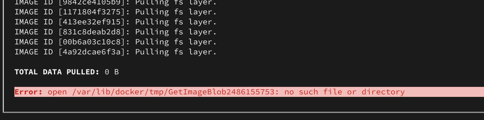

I had a similar problem, but I think I have made it worse. I was having an issue with a different docker container, so I rebooted the server (after some other troubleshooting steps) My docker file was corrupt, so I tried to reinstall Nextcloud AIO, but I get an error
I cannot reinstall the container.
RESOLVED: I had to recreate the Docker share (don't ask how I broke it) and reinstalled the AIO mastercontainer. I was able to restore everything from backups.
