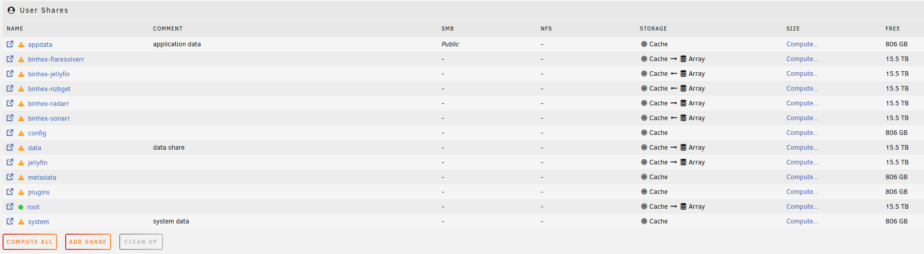

Hi All,
New UnRAID user getting used to how everything works. My array is up and running with several Docker containers for media. Current setup is a 5 disk array (1 parity, 4 storage) with a 1 TB NVMe cache drive under UnRAID 7.0.1.
The Fix Common Problems utility is reporting the following message, but I am unable to locate a setting for the "log" share, as it is not visible via the WebUI.
"Share log is an implied array-only share, but files / folders exist on the cache"
Attaching a screenshot of the visible shares and their current settings. I am open to any feedback on how things are currently configured, as I said I'm getting used to the system and probably making common mistakes.
I appreciate any assistance/guidance you are able to provide.
Thank you.

A lot of your user shares appear to be folders that I would expect to be under appdata. Why did you do it like that?

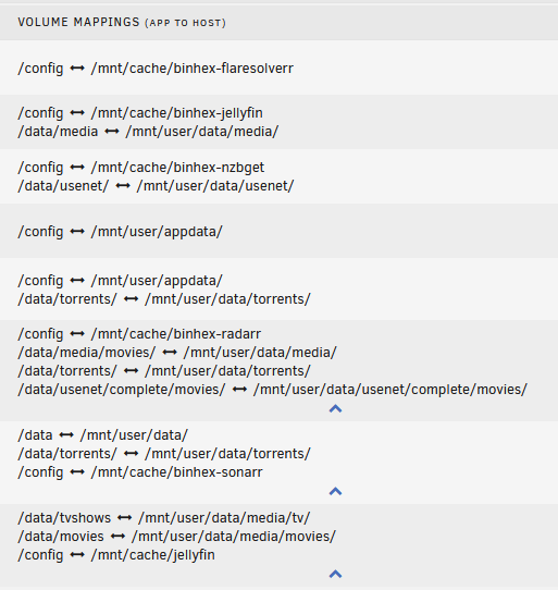

Are any of your container host paths /mnt/user ?
Honestly, attempting to follow Docker guides and misunderstanding the correct way to do things. I'm well versed in Linux but am a total Docker noob. I'm not confident that any of my cache setup is valid/accurate/best practice.
Yes several are /mnt/user, see attached screenshot.
Those are /mnt/user/data. I was just wondering if something had access to /mnt/user so it would be able to create a log folder there.
All of those /config paths should really be under appdata
So that likely requires a rebuild of the containers then? Or is it a matter of changing them, restarting the containers, then deleting the originals?
Unless you move their "appdata" under appdata, then they would be starting over.

Wouldn't be that hard to do. Would just require some attention to detail. Here is a basic outline:
Settings - Docker - Disable
For that first container, map /config to /mnt/cache/appdata/binhex-flaresolverr
Use Dynamix File Manager to move /mnt/cache/binhex-flaresolverr to /mnt/cache/appdata
Similar for each of the others.
I attempted this for the first container, seemingly successfully.
I tried again for the Radarr container as it is relatively new/unused, but I think something went wrong with appdata as it did not populate any information I'd set within the container for configuration, treating it as a new setup. At first I disabled Docker as suggested, however that means I am unable to change the mapping.
So instead what I did was the following:
1.) Stop the container
2.) Use file manager to move the files to /mnt/cache/appdata/binhex-radarr/
3.) Map /config to /mnt/cache/appdata/binhex-radarr/ and apply to start the container
It seems like the existing appdata information was not read so I have avoided further moves for the time being.
Maybe this is what you mean.
Move the folder /mnt/cache/binhex-radarr into the folder /mnt/cache/appdata, so that all of the binhex-radarr appdata folders and files are in /mnt/cache/appdata/binhex-radarr
