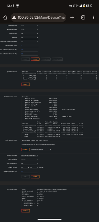

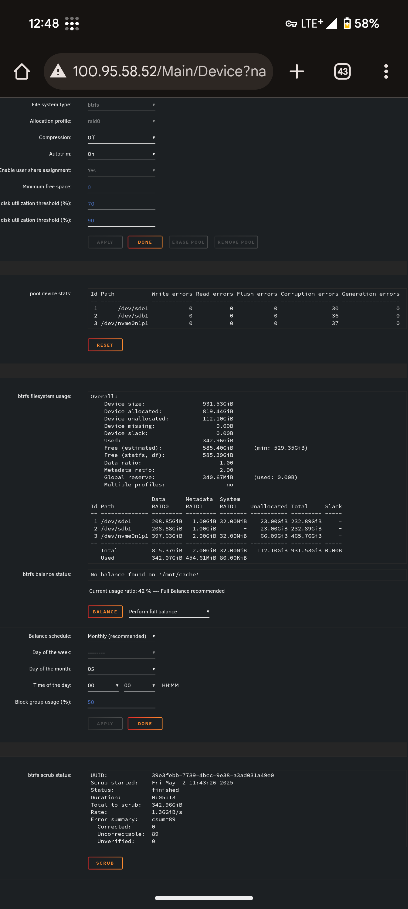

Hi, so I changed ram speed to 1866 and made sure c state is disabled. I ran a scrub on cache pool. But today I was on plex and it crashed. In kernel I had message "Kernel panic - not syncing" I forced a reboot and it started fine.
guniv3rs-diagnostics-20250501-1720.zip
Reset the pool stats then scrub the pool and post the results.

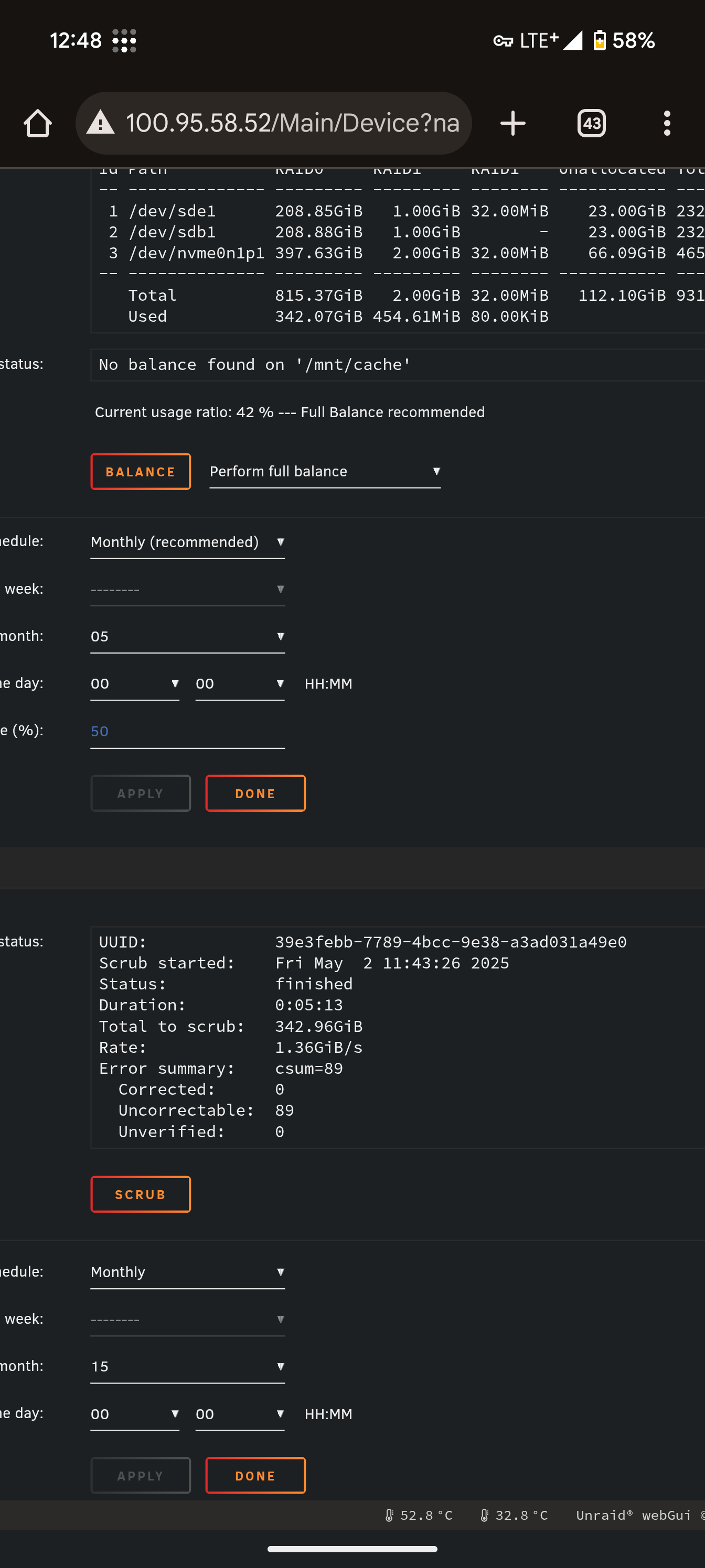

Please post the result of the scrub, what shows in the GUI
There are uncorrectable errors, look in the syslog for the list of affected files, e.g.:
path: Media/Movies/Alarum (2025)/Alarum (2025) WEBDL-2160p.mkv
Those should be deleted, restored from a backup, then reset the stats again and run a new scrub to confirm 0 errors.

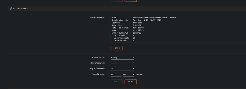

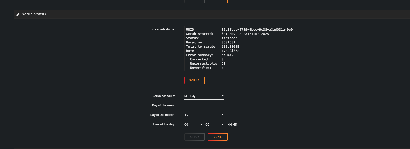

So I erased the docker image in successfully reinstalled dockers. I deleted files in syslog that were showing that they were corrupted. All media files (movies and tv shows). I reset cache stats and ran a scrub again. Here are results.
guniv3rs-diagnostics-20250503-2328.zip
There are still corrupt files, e.g.:
path: appdata/binhex-plexpass/Plex Media Server/Media/localhost/a/10cef22f5170746e854c5519d74a5883f106e43.bundle/Contents/Chapters/chapter5.jpg
Delete/restore then or restore from a backup, then reset the stats and run another scrub to confirm 0 errors.
