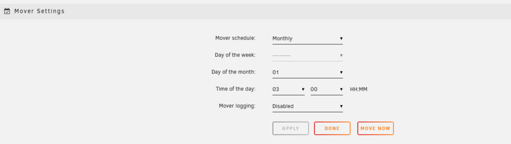

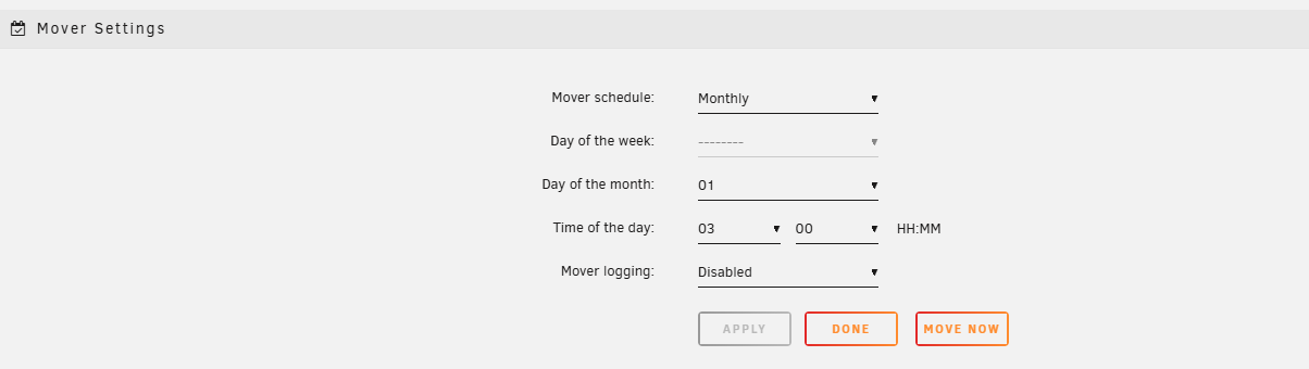

This is based on your settings and schedules you set...

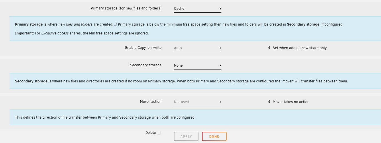

primary share is where new files are created...
secondary is where the files are removed from primary and sent to the sedcondary storage when mover scheduled is called and ran...
you control and set that before you started your file copy...
This is all based on how you handle your shares
and when you tell mover to run:
/Settings/Settings/Tools/Scheduler
