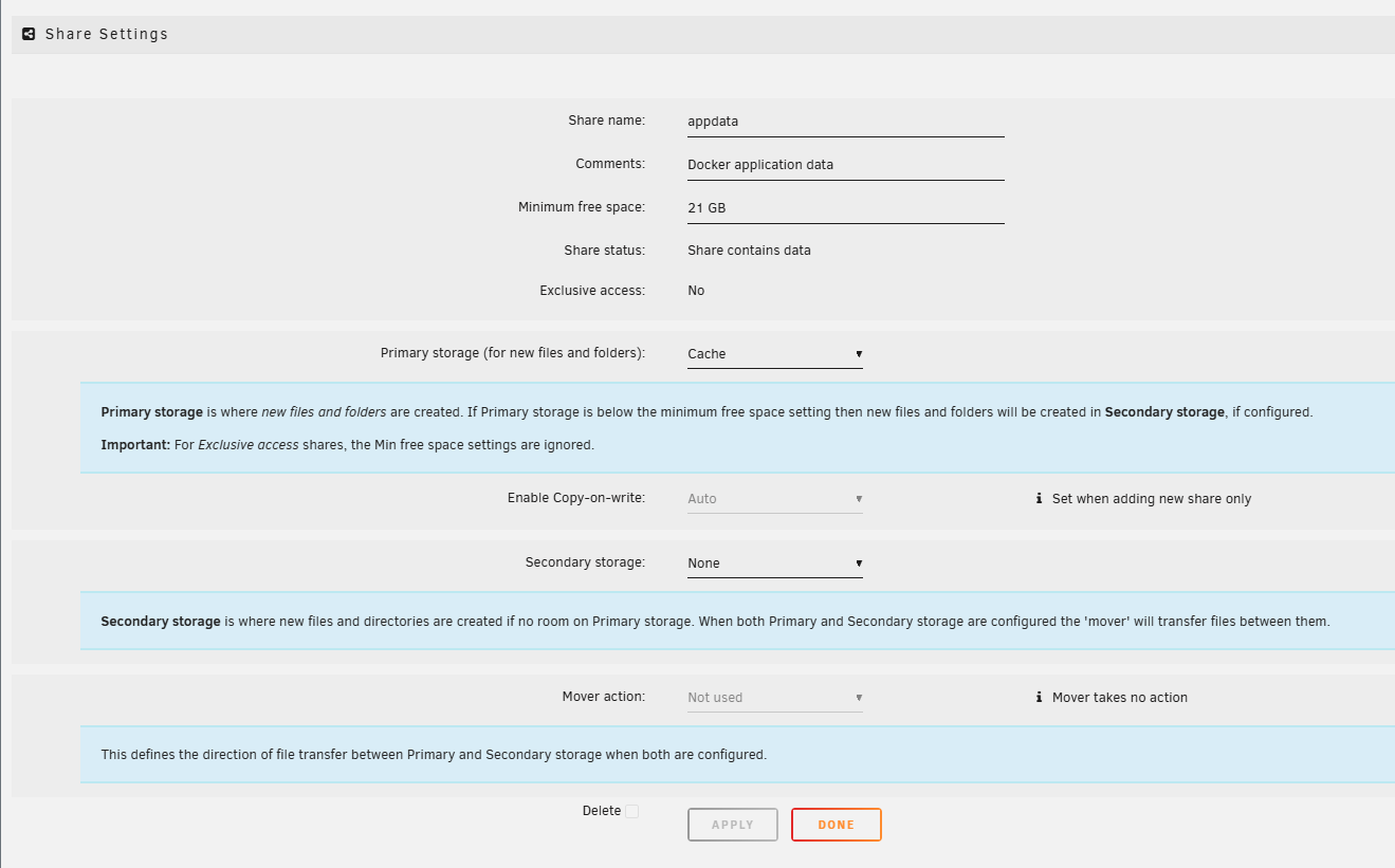

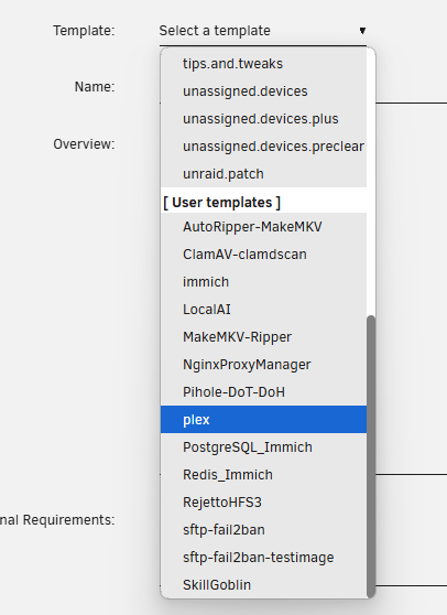

It worked but I needed to re-add my plex docker.  I am not sure if that is expected or not.
The last question is the correct setup for the appdata, system, and domains shares.   When I started they were setup as Array primary, Cache secondary and mover set to move to cache.   Now they are cache primary, array secondary and mover set to move to cache.    As long as mover is set to move to cache, does it matter what is primary or secondary?
I also have an isos directory that is empty, no VMs so expected.   Is that just a standard directory and if so is it supposed to be setup like the appdata, etc.?
Thanks,
Ross
Correct which should be listed in the docker tab by clicking add container and selecting the plex template from the list.
Normally data is set to be on 1 primary disk.
example default appdata share used for unraids default place to set docker data.
yes by default data is set to be used to caches as usually cache is the faster disk. and secondary to the array for long-term storage, latter.
With unraid v7 and the ability to ditch the array and with the pool implementation of zfs disk, this is now user preference on how they want to handle data and shares...
Ideally you only want a single primary storage set.
