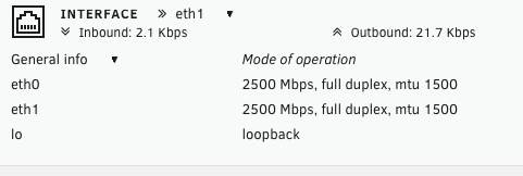

woo woo woo!! It's back. Thank you again @JorgeB!!
