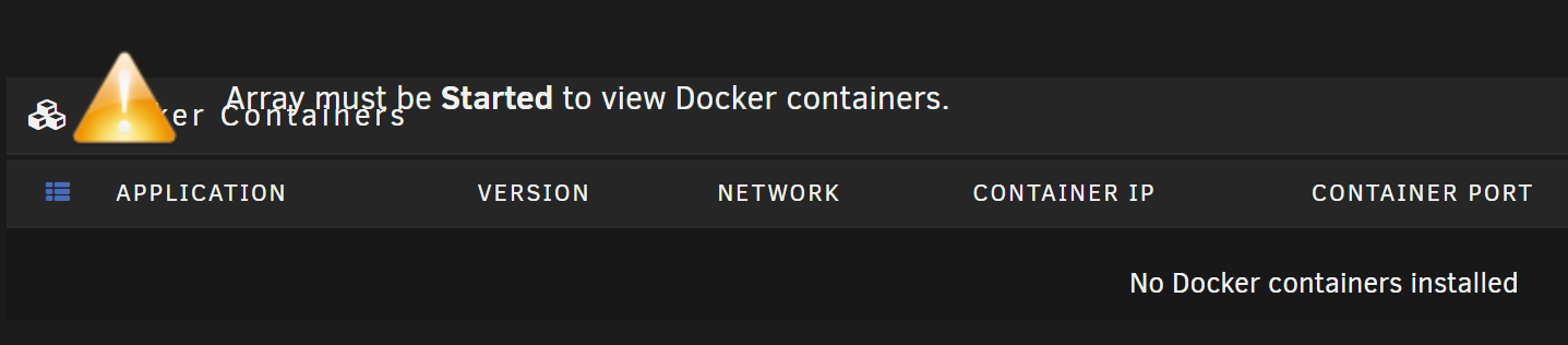

Docker service failed to start - BTRFS error - docker.img is in-use, cannot mount
Occasionally Docker service just won't start. I don't know what needs changed to fix this.

EDIT: Also, I just tried to stop the array and it can't unmount the appdata cache drive I use:
Apr 26 10:09:10 Dwigt emhttpd: shcmd (625): umount /mnt/cache_appdata
Apr 26 10:09:10 Dwigt root: umount: /mnt/cache_appdata: target is busy.
Apr 26 10:09:10 Dwigt emhttpd: shcmd (625): exit status: 32
Apr 26 10:09:10 Dwigt emhttpd: Retry unmounting disk share(s)...
Apr 26 10:09:15 Dwigt emhttpd: Unmounting disks...
Apr 26 10:09:15 Dwigt emhttpd: shcmd (626): umount /mnt/cache_appdata
Apr 26 10:09:15 Dwigt root: umount: /mnt/cache_appdata: target is busy.
Apr 26 10:09:15 Dwigt emhttpd: shcmd (626): exit status: 32
Apr 26 10:09:15 Dwigt emhttpd: Retry unmounting disk share(s)...

Apr 26 03:15:45 Dwigt kernel: XFS (sdi1): Corruption detected. Unmount and run xfs_repair
Check filesystem on this pool, would also recommend after that, recreating the docker image.
