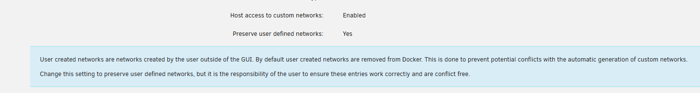

First double check your docker settings and make sure preser user is set to yes
if you did the commands there to rebuild you lost every docker network and config. you will need to rerun the docker network create command to make thoese dockers again.
The setting is on since years and I never turned it off.
