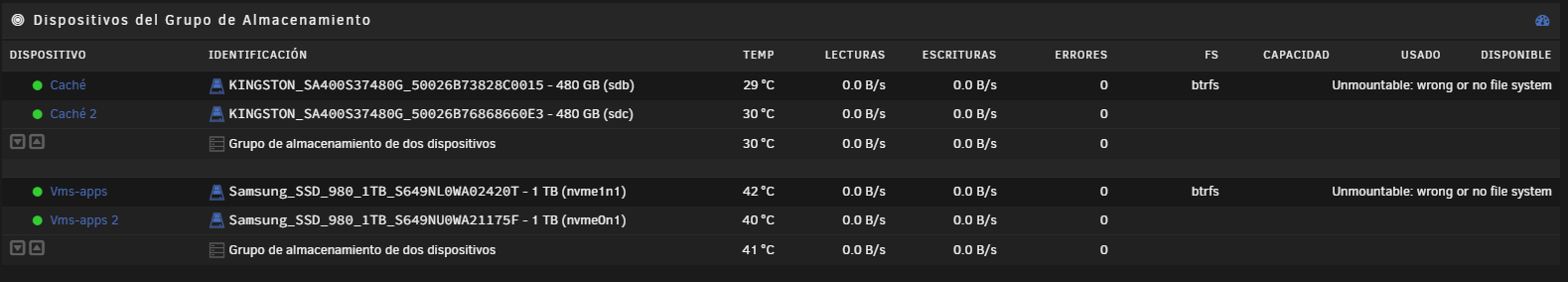

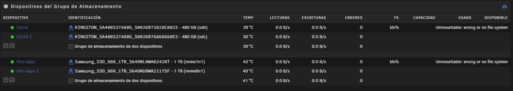

Hi, Due to bad connection of USB port to motherboard, my pendrive got corrupted and after recovering it, my Cache pool and Vms-apps pool shows "Unmountable: Bad or No System File System".
Please, can you help me recover them?

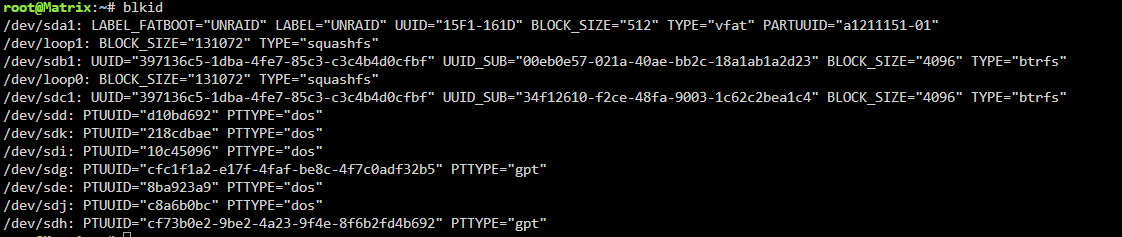

Second one doesn't have a valid btrfs filesystem, post the output from:
blkid
and
fdisk -l /dev/nvme01
This is the ouput of blkid:
I understand that the execution of the other command is on nvme0n1. If so, the result is:

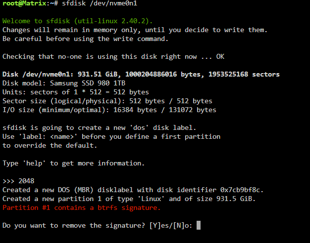

Sorry for the delay but was without power almost all day yesterday, if just the partiion was deleted it may still be able to recover the pool, type:
sfdisk /dev/nvme0n1
then type 2048 and hit enter, then capture and post the output, don't type anything else
Don't worry, I was in the same situation. This is the output from the command execution, and I need to know what do I need to answer to the question it asks me:
Edited by javierpm
Type N to keep the signature, then type write and enter to save the changes.

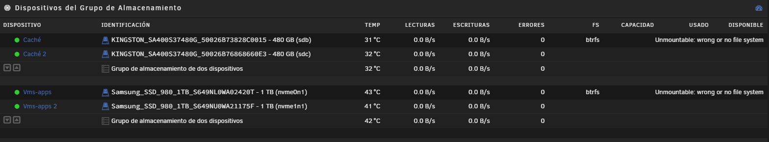

Try restarting the array now to see if the second pool mounts, if it doesn't, post new diags.
I have restarted the array and then tried restarting the server but unfortunately, I still can't mount it (I haven't done anything with the cache pool yet). Here are the new diagnostics:

The second pool has similar corruptions as the other one:
Apr 29 13:12:11 Matrix kernel: BTRFS error (device nvme1n1p1): bad tree block start, mirror 2 want 24068096 have 0
Apr 29 13:12:11 Matrix kernel: BTRFS error (device nvme1n1p1): bad tree block start, mirror 1 want 24068096 have 0
So it wasn't just the partitions that were deleted, looks like some metadata was deleted in both devices (have 0 means it's not finding the tree locations it's looking for), you can also try the recovery options I posted before for the 1st pool

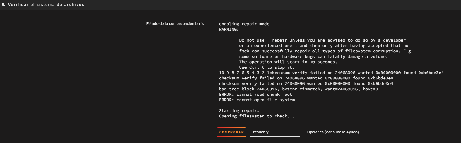

Finally I had to use the option to use BTRFS check --repair, and it's been going on for about 2 hours now:
Edited by javierpm
Typically, it doesn't take more than a few minutes.
So should I wait or cancel and delete the storage pools? I don't see it going past the point of "opening filesystem to check".
Anything in the syslog? It may have crashed.
No. This are the las lines:

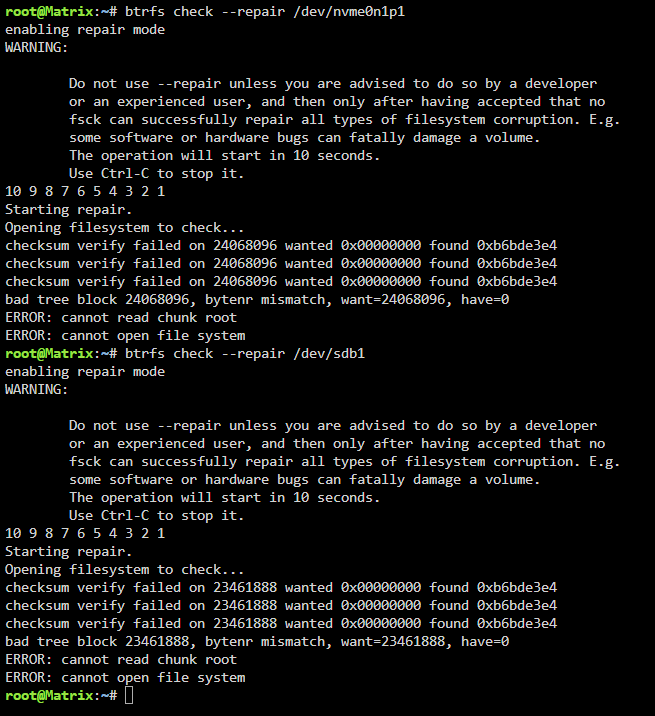

I doubt it's doing anything, try rebooting, then running that command on the CLI:
btrfs check --repair /dev/sdb1
or
btrfs check --repair /dev/nvme0n1p1
Depending on with pool you are running it, you just need to run it on one of the pool devices.
With the arrays in Maintenance mode, correct?
Nod needed, since the pools are not mounting anyway.
It doesn't look good:
I'm afraid so, you will likely need to reformat.
