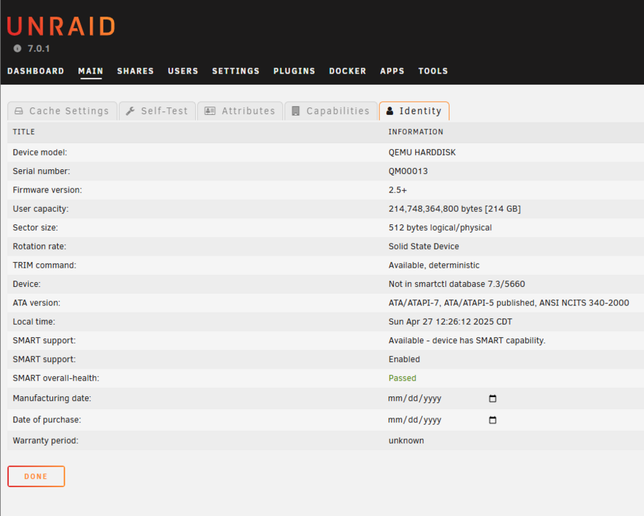

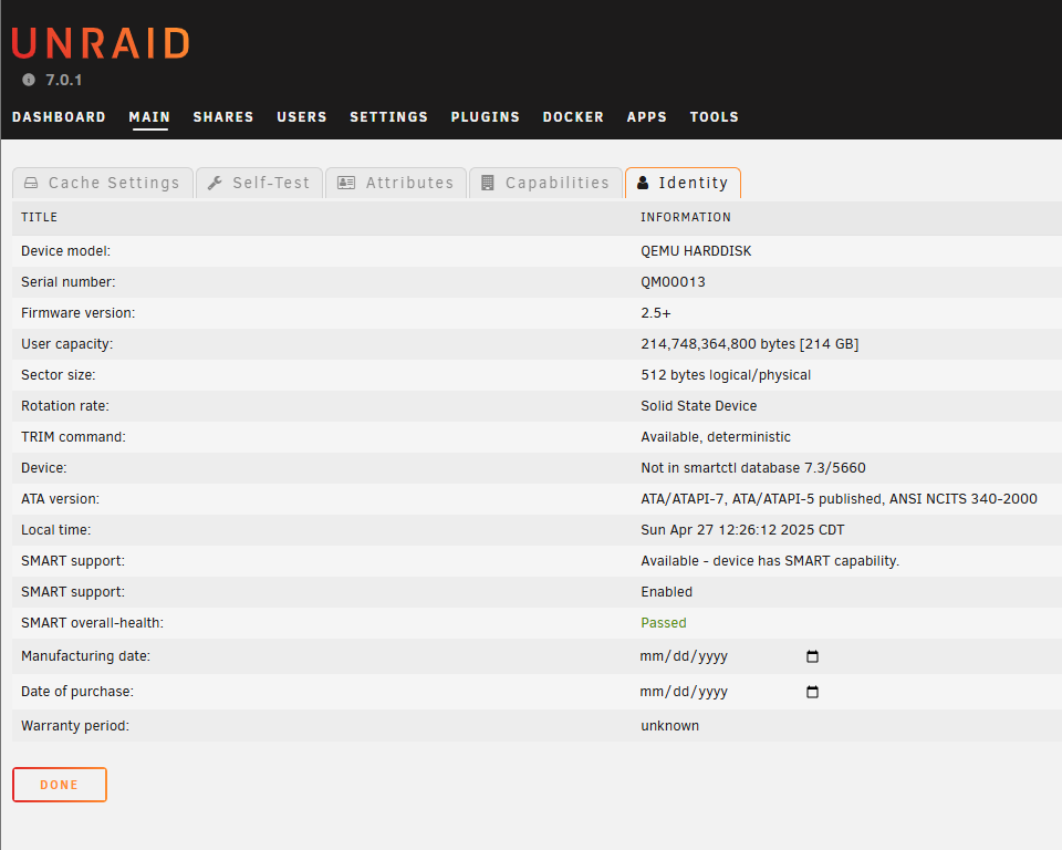

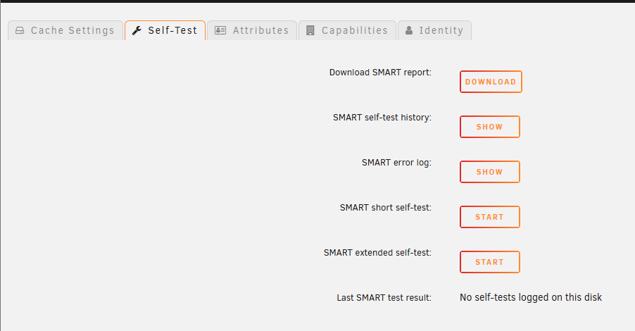

➔ You need SMART monitoring or filesystem checks outside of rsync:
Use Unraid SMART Reports (Dashboard > Disks > click on a disk > SMART).
Set threshold triggers to get alerts if reallocated sectors, pending sectors, or other errors appear.
You can schedule Parity Checks and Filesystem Checks too.

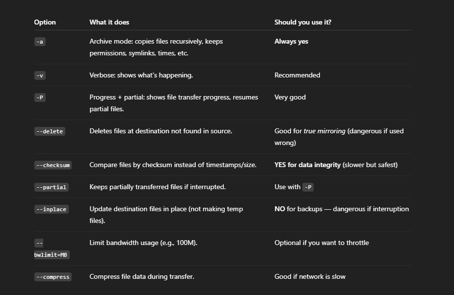

If you want to rsync safely in the future, consider using:
review: https://linux.die.net/man/1/rsync
rsync -avP --delete --checksum /source/ /destination/
-a = archive mode
-v = verbose
-P = show progress
--delete = delete extraneous files
--checksum = compare files based on checksum, not size and timestamp.
This prevents corrupt files from overwriting healthy ones if the size didn't change but content did.
We’ll review important rsync options first (to make sure your backups are as safe as possible), then I’ll write you a "smart rsync watchdog" script that auto-stops rsync if a disk shows signs of failure.
