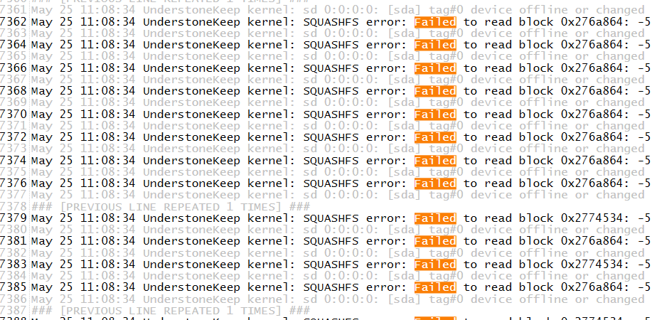

How has it been since you replaced the reader? I have very similar issues although I don't have an adapter, just a regular USB drive. Exact same symptoms.

Ok, thanks for the reply. I ran the diagnostics and it appears I'm looking for a new drive as well. Thanks again!
