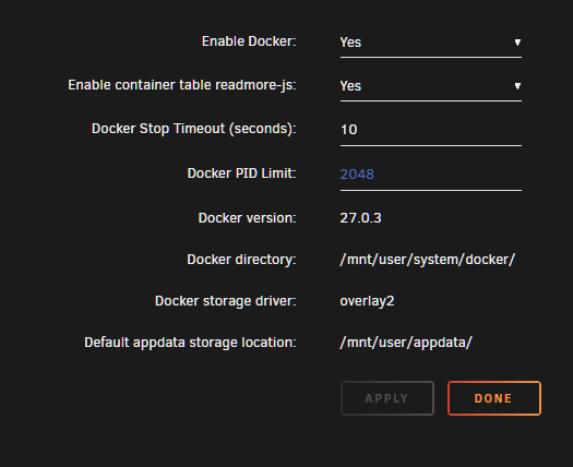

thanks @bmartino1 for the comprehensive review. For the meantime I have first tried changing my Docker settings as per your suggestion to the following:
Regarding the Plex issue, I'm not quite sure. I currently have my transcodes going into this path
Now that I have updated the Docker settings I'll keep monitoring to see if that Docker change fixed it.

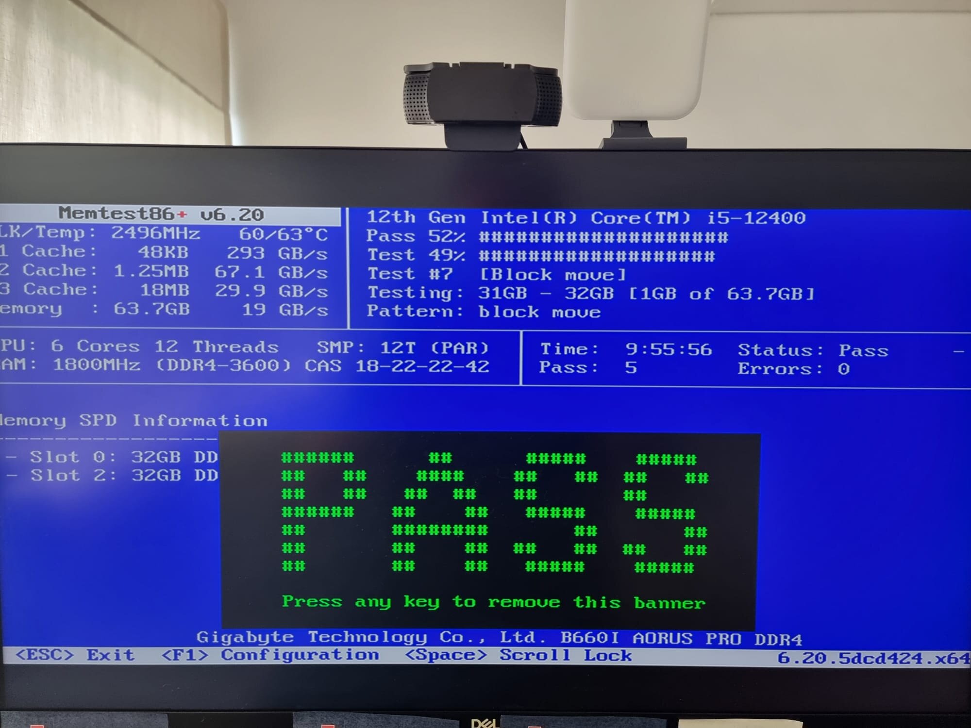

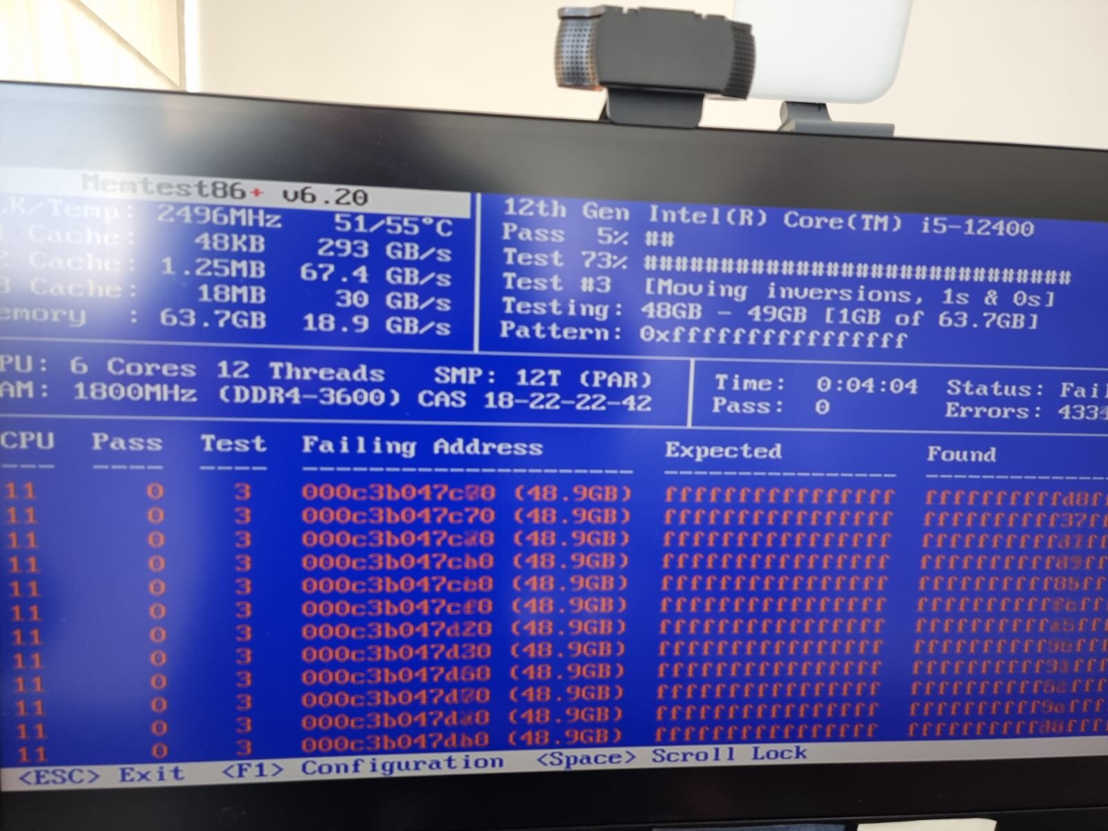

Spoke too soon from my previous edit/update!
So it seems to have crashed again despite making the above changes.
Here's my latest diagnostics and logs:
text  error  warn  system  array  login
May  7 17:36:39 mars kernel: docker0: port 5(vethde6cc3e) entered disabled state
May  7 17:36:39 mars kernel: vethde6cc3e (unregistering): left allmulticast mode
May  7 17:36:39 mars kernel: vethde6cc3e (unregistering): left promiscuous mode
May  7 17:36:40 mars kernel: sh[680006]: segfault at 1545b31f3d00 ip 00001545b3f1e05f sp 00007fffa042e228 error 4 in ld-linux-x86-64-2.41.so[205f,1545b3f1d000+2c000] likely on CPU 2 (core 1, socket 0)
May  7 17:36:40 mars kernel: Code: 66 2e 0f 1f 84 00 00 00 00 00 90 ff 13 48 89 d8 48 83 eb 08 49 39 c4 75 f2 48 8b 95 a8 00 00 00 48 85 d2 74 16 48 8b 45 00 5b <48> 03 42 08 5d 41 5c ff e0 0f 1f 84 00 00 00 00 00 5b 5d 41 5c c3
May  7 17:36:43 mars kernel: docker0: port 5(veth39a1061) entered blocking state
May  7 17:36:43 mars kernel: docker0: port 5(veth39a1061) entered disabled state
May  7 17:36:43 mars kernel: veth39a1061: entered allmulticast mode
May  7 17:36:43 mars kernel: veth39a1061: entered promiscuous mode
May  7 17:36:43 mars kernel: eth0: renamed from vethc8a10e4
May  7 17:36:43 mars kernel: docker0: port 5(veth39a1061) entered forwarding state
May  7 17:37:07 mars kernel: notify[682089]: segfault at 125ecb0 ip 00000000008de1e0 sp 00007ffc1131b490 error 7 in php[4de1e0,600000+3db000] likely on CPU 11 (core 5, socket 0)
May  7 17:37:07 mars kernel: Code: 00 00 eb 99 66 0f 1f 44 00 00 48 83 c4 08 48 89 df 5b 5d e9 32 6d d2 ff 66 90 48 83 c4 08 48 89 df 5b 5d e9 22 fc ff ff 66 90 <89> 07 e9 65 ff ff ff e8 a4 f7 fd ff eb c2 66 90 48 83 ec 18 48 89
May  7 17:37:57 mars kernel: pgrep[685078]: segfault at 9490b8 ip 000015516bc8ffd2 sp 00007ffc1f945c00 error 4 in libc-2.41.so[aafd2,15516bc0d000+17c000] likely on CPU 0 (core 0, socket 0)
May  7 17:37:57 mars kernel: Code: f8 ff 66 0f 1f 44 00 00 48 85 ff 0f 84 7f 01 00 00 41 57 41 56 41 55 41 54 55 48 8d 6f f0 53 48 83 ec 28 4c 8b 25 f6 3d 15 00 <48> 8b 47 f8 64 45 8b 2c 24 a8 02 0f 85 ed 00 00 00 4c 8b 35 76 3d
May  7 17:38:35 mars kernel: sh[687495]: segfault at 14a53082be40 ip 000014a53082be40 sp 00007ffde7370d58 error 14 likely on CPU 6 (core 3, socket 0)
May  7 17:38:35 mars kernel: Code: Unable to access opcode bytes at 0x14a53082be16.
May  7 17:38:40 mars kernel: lspci[687807]: segfault at ca0008 ip 0000145d76f709d4 sp 00007fff52423790 error 4 in libpci.so.3.13.0[79d4,145d76f6d000+b000] likely on CPU 3 (core 1, socket 0)
May  7 17:38:40 mars kernel: Code: ff ff 49 89 c0 4d 85 f6 74 44 4b 8b 04 e6 48 85 c0 75 17 e9 26 01 00 00 66 0f 1f 44 00 00 48 8b 00 48 85 c0 0f 84 14 01 00 00 <39> 58 08 75 ef 39 68 0c 75 ea 0f b6 50 10 44 39 fa 75 e1 b8 01 00
May  7 17:38:56 mars kernel: docker0: port 5(veth39a1061) entered disabled state
May  7 17:38:56 mars kernel: vethc8a10e4: renamed from eth0
May  7 17:38:56 mars kernel: veth39a1061 (unregistering): left allmulticast mode
May  7 17:38:56 mars kernel: veth39a1061 (unregistering): left promiscuous mode
May  7 17:39:07 mars kernel: docker0: port 5(veth8c0223d) entered blocking state
May  7 17:39:07 mars kernel: docker0: port 5(veth8c0223d) entered disabled state
May  7 17:39:07 mars kernel: veth8c0223d: entered allmulticast mode
May  7 17:39:07 mars kernel: veth8c0223d: entered promiscuous mode
May  7 17:39:07 mars kernel: eth0: renamed from vethf6701f8
May  7 17:39:07 mars kernel: docker0: port 5(veth8c0223d) entered forwarding state
May  7 17:40:55 mars kernel: smartctl_type[695550]: segfault at 1110060 ip 00000000008d73ce sp 00007fff57aea990 error 7 in php[4d73ce,600000+3db000] likely on CPU 8 (core 4, socket 0)
May  7 17:40:55 mars kernel: Code: 00 eb c9 66 0f 1f 84 00 00 00 00 00 48 89 df e8 88 fd 00 00 48 8b 7b 10 48 85 ff 74 0f f6 47 04 40 75 09 8b 07 83 e8 01 74 12 <89> 07 48 89 df 5b e9 27 db d2 ff 0f 1f 80 00 00 00 00 e8 1b db d2
May  7 17:40:59 mars kernel: notify[695718]: segfault at 1a31b14 ip 00000000008de146 sp 00007fff7a8c8b20 error 4 in php[4de146,600000+3db000] likely on CPU 8 (core 4, socket 0)
May  7 17:40:59 mars kernel: Code: ff e9 31 fe ff ff 66 66 2e 0f 1f 84 00 00 00 00 00 0f 1f 00 55 53 48 83 ec 08 48 8b 1f 80 3b 02 0f 84 8e 00 00 00 48 8b 7b 08 <f6> 47 04 40 74 14 48 83 7b 10 00 74 20 f6 43 07 02 74 67 48 83 c4
May  7 17:41:17 mars kernel: notify[696514]: segfault at 15cf7b98 ip 00000000008f7d7a sp 00007ffcc4b37610 error 4 in php[4f7d7a,600000+3db000] likely on CPU 6 (core 3, socket 0)
May  7 17:41:17 mars kernel: Code: 08 f6 c2 0c 0f 85 2e 01 00 00 4d 8b 74 24 10 41 0b 44 24 0c 48 98 41 8b 1c 86 83 fb ff 0f 84 8d 00 00 00 48 c1 e3 05 4c 01 f3 <48> 3b 6b 18 75 3c 5b 31 c0 5d 41 5c 41 5d 41 5e c3 0f 1f 44 00 00
May  7 17:41:25 mars kernel: smartctl_type[696917]: segfault at 0 ip 00000000008dcd5c sp 00007fff16d3f5d0 error 4 in php[4dcd5c,600000+3db000] likely on CPU 10 (core 5, socket 0)
May  7 17:41:25 mars kernel: Code: f7 ff ff 5b 5d e9 94 f4 ff ff 0f 1f 40 00 41 57 41 56 41 55 41 54 49 89 fc 55 48 89 f5 53 48 83 ec 08 f7 c6 00 00 40 00 74 5c <44> 8b 2f 48 8d 5f 08 41 89 d6 44 0f b6 fa 49 c1 e5 04 49 01 dd 4c
May  7 17:42:01 mars kernel: monitor[698566]: segfault at 1f0000 ip 00000000001f0000 sp 00007ffc7ca1ae78 error 14 likely on CPU 1 (core 0, socket 0)
May  7 17:42:01 mars kernel: Code: Unable to access opcode bytes at 0x1effd6.
May  7 17:42:01 mars crond[1835]: exit status 139 from user root /usr/local/emhttp/plugins/dynamix/scripts/monitor &> /dev/null
May  7 17:45:51 mars kernel: python3[701031]: segfault at b0 ip 00001455b97c1532 sp 000014550eb9b5e0 error 4 in libpython3.12.so.1.0[17e532,1455b96be000+20f000] likely on CPU 8 (core 4, socket 0)
May  7 17:45:51 mars kernel: Code: 63 90 b0 00 00 00 48 8d 84 50 c0 00 00 00 48 39 45 68 0f 82 28 01 00 00 48 8b 7d 38 48 85 ff 74 4e 80 7f 46 01 74 1c 48 8b 07 <48> 63 90 b0 00 00 00 48 8d 84 50 c0 00 00 00 48 39 47 38 0f 82 b7
May  7 17:52:59 mars kernel: smartctl_type[728090]: segfault at 14f6e8400040 ip 00000000008bd997 sp 00007fff92210458 error 4 in php[4bd997,600000+3db000] likely on CPU 8 (core 4, socket 0)
May  7 17:52:59 mars kernel: Code: 1f 40 00 48 89 c7 e9 c8 d2 ff ff 0f 1f 84 00 00 00 00 00 e9 fb d3 ff ff 66 66 2e 0f 1f 84 00 00 00 00 00 48 8b 05 39 52 d6 00 <8b> 10 85 d2 0f 85 4f e3 d6 ff 48 89 fa 81 e2 ff ff 1f 00 74 4c 48
May  7 17:54:47 mars kernel: rc.diskinfo[732580]: segfault at 15af430 ip 00000000008d73ce sp 00007ffd91a83820 error 7 in php[4d73ce,600000+3db000] likely on CPU 0 (core 0, socket 0)
May  7 17:54:47 mars kernel: Code: 00 eb c9 66 0f 1f 84 00 00 00 00 00 48 89 df e8 88 fd 00 00 48 8b 7b 10 48 85 ff 74 0f f6 47 04 40 75 09 8b 07 83 e8 01 74 12 <89> 07 48 89 df 5b e9 27 db d2 ff 0f 1f 80 00 00 00 00 e8 1b db d2
May  7 17:55:32 mars kernel: notify[734479]: segfault at 15142e0ed906 ip 000015142e0ed906 sp 00007ffdf9bbb708 error 14 likely on CPU 8 (core 4, socket 0)
May  7 17:55:32 mars kernel: Code: Unable to access opcode bytes at 0x15142e0ed8dc.
May  7 17:56:30 mars kernel: rc.diskinfo[736760]: segfault at 14716e000040 ip 00000000008bd997 sp 00007ffd62ed48b8 error 4 in php[4bd997,600000+3db000] likely on CPU 2 (core 1, socket 0)
May  7 17:56:30 mars kernel: Code: 1f 40 00 48 89 c7 e9 c8 d2 ff ff 0f 1f 84 00 00 00 00 00 e9 fb d3 ff ff 66 66 2e 0f 1f 84 00 00 00 00 00 48 8b 05 39 52 d6 00 <8b> 10 85 d2 0f 85 4f e3 d6 ff 48 89 fa 81 e2 ff ff 1f 00 74 4c 48
May  7 17:57:01 mars kernel: smartctl_type[738013]: segfault at c60000 ip 00000000008de18a sp 00007ffd6147bd60 error 7 in php[4de18a,600000+3db000] likely on CPU 2 (core 1, socket 0)
May  7 17:57:01 mars kernel: Code: 8b 07 83 e8 01 75 79 e8 94 6d d2 ff 48 83 7b 10 00 75 e0 48 89 df e8 85 ec ff ff 48 8b 6b 30 48 85 ed 74 cf f6 45 04 40 75 26 <83> 6d 00 01 75 20 48 89 ef e8 f8 c7 01 00 48 89 ef f6 45 04 80 74
May  7 17:57:15 mars kernel: notify[738579]: segfault at 13b2aa0 ip 00000000008de1e0 sp 00007ffc27febda0 error 7 in php[4de1e0,600000+3db000] likely on CPU 5 (core 2, socket 0)
May  7 17:57:15 mars kernel: Code: 00 00 eb 99 66 0f 1f 44 00 00 48 83 c4 08 48 89 df 5b 5d e9 32 6d d2 ff 66 90 48 83 c4 08 48 89 df 5b 5d e9 22 fc ff ff 66 90 <89> 07 e9 65 ff ff ff e8 a4 f7 fd ff eb c2 66 90 48 83 ec 18 48 89
May  7 17:57:24 mars kernel: notify[738919]: segfault at 1948b40 ip 00000000008dda22 sp 00007ffe77d83b60 error 4 in php[4dda22,600000+3db000] likely on CPU 8 (core 4, socket 0)
May  7 17:57:24 mars kernel: Code: 8b 6d 58 48 8b 5d 50 49 c1 e5 05 49 01 dd 49 39 dd 75 0e eb 73 0f 1f 00 48 83 c3 20 49 39 dd 74 67 80 7b 08 00 74 f1 4c 8b 23 <49> 39 6c 24 10 75 e7 41 f6 44 24 05 21 0f 85 5b 02 00 00 4d 8b 74
May  7 17:57:27 mars kernel: traps: notify[739039] general protection fault ip:8dcd5c sp:7ffe100a3d80 error:0 in php[4dcd5c,600000+3db000]
May  7 17:58:18 mars kernel: notify[741120]: segfault at 250020 ip 000015357c7cb3f2 sp 00007ffd46d2d2a0 error 4 in libcrypto.so.3[2323f2,15357c67f000+36e000] likely on CPU 5 (core 2, socket 0)
May  7 17:58:18 mars kernel: Code: 48 8b 55 00 45 31 ff 4c 89 e3 48 c1 e3 06 0f 18 0c 1a 48 83 eb 40 4c 89 f9 48 c1 e1 04 48 01 ca 4c 8b 74 13 08 4d 85 f6 74 1a <49> 8b 56 20 4c 89 f7 ff 52 08 ba 71 02 00 00 4c 89 ee 4c 89 f7 e8
May  7 17:58:24 mars kernel: sh[741368]: segfault at 0 ip 000000000042d4ef sp 00007ffdfe94d260 error 6 in bash[2d4ef,426000+cb000] likely on CPU 5 (core 2, socket 0)
May  7 17:58:24 mars kernel: Code: c7 05 61 9f 10 00 ff ff ff ff e8 ec aa 06 00 48 89 05 65 9f 10 00 48 89 c7 48 63 d5 48 8d 04 17 41 83 ff ff 0f 84 d1 00 00 00 <44> 88 38 83 c5 01 41 83 ff 0a 0f 84 41 04 00 00 41 83 ff 5c 0f 94
May  7 17:58:24 mars kernel: notify[741369]: segfault at 24fff8 ip 0000154ea567cfd2 sp 00007fff03d58380 error 4 in libc-2.41.so[aafd2,154ea55fa000+17c000] likely on CPU 8 (core 4, socket 0)
May  7 17:58:24 mars kernel: Code: f8 ff 66 0f 1f 44 00 00 48 85 ff 0f 84 7f 01 00 00 41 57 41 56 41 55 41 54 55 48 8d 6f f0 53 48 83 ec 28 4c 8b 25 f6 3d 15 00 <48> 8b 47 f8 64 45 8b 2c 24 a8 02 0f 85 ed 00 00 00 4c 8b 35 76 3d
May  7 17:58:31 mars kernel: smartctl_type[741650]: segfault at dfff8 ip 0000146108db7fd2 sp 00007ffd419d2ff0 error 4 in libc-2.41.so[aafd2,146108d35000+17c000] likely on CPU 2 (core 1, socket 0)
May  7 17:58:31 mars kernel: Code: f8 ff 66 0f 1f 44 00 00 48 85 ff 0f 84 7f 01 00 00 41 57 41 56 41 55 41 54 55 48 8d 6f f0 53 48 83 ec 28 4c 8b 25 f6 3d 15 00 <48> 8b 47 f8 64 45 8b 2c 24 a8 02 0f 85 ed 00 00 00 4c 8b 35 76 3d
May  7 17:58:40 mars kernel: __vm_enough_memory: pid: 741979, comm: nvme, bytes: 117621856587776 not enough memory for the allocation
May  7 17:58:40 mars kernel: nvme[741979]: segfault at 1503d7872b88 ip 00001503d7872b88 sp 00007ffdd083ecb0 error 14 likely on CPU 0 (core 0, socket 0)
May  7 17:58:40 mars kernel: Code: Unable to access opcode bytes at 0x1503d7872b5e.
May  7 17:58:54 mars kernel: rc.diskinfo[742496]: segfault at 30 ip 000014f7cc8d2bb0 sp 00007ffdf1de4db0 error 4 in libglib-2.0.so.0.8400.1[2fbb0,14f7cc8c5000+a2000] likely on CPU 8 (core 4, socket 0)
May  7 17:58:54 mars kernel: Code: 31 05 00 49 8b 3f 49 89 c6 e8 3c 31 05 00 49 8b 7c 24 08 4c 89 f6 48 89 c2 e8 cc d0 01 00 e9 77 ff ff ff 0f 1f 80 00 00 00 00 <41> 8b 14 24 83 fa 0d 0f 87 a0 0d 00 00 48 8d 0d b0 42 0a 00 89 d0
May  7 18:00:02 mars kernel: smartctl[745402]: segfault at da32c0 ip 0000148d04900916 sp 00007fffb0801b00 error 4 in libc-2.41.so[aa916,148d0487e000+17c000] likely on CPU 1 (core 0, socket 0)
May  7 18:00:02 mars kernel: Code: 2d d7 4a 15 00 73 6d 0f b7 0c 6a 66 85 c9 74 64 48 8d 7d 10 48 8b 04 fa a8 0f 0f 85 64 02 00 00 48 89 c6 83 e9 01 48 c1 ee 0c <48> 33 30 48 89 34 fa 66 89 0c 6a 48 c7 40 08 00 00 00 00 48 83 c4
May  7 18:00:26 mars kernel: __vm_enough_memory: pid: 746586, comm: grep, bytes: 117915076513792 not enough memory for the allocation
May  7 18:00:26 mars kernel: __vm_enough_memory: pid: 746586, comm: grep, bytes: 117915076210688 not enough memory for the allocation
May  7 18:00:27 mars kernel: php[746765]: segfault at 1e43f1e8 ip 00000000008fe82c sp 00007fff6401d300 error 4 in php[4fe82c,600000+3db000] likely on CPU 0 (core 0, socket 0)
May  7 18:00:27 mars kernel: Code: 55 48 89 f5 53 48 8b 46 08 48 89 fb 48 85 c0 74 65 0b 43 0c 4c 8b 63 10 48 98 41 8b 1c 84 83 fb ff 74 7b 48 c1 e3 05 4c 01 e3 <48> 3b 6b 18 75 36 48 89 d8 5b 5d 41 5c c3 66 0f 1f 44 00 00 48 8b
May  7 18:01:25 mars kernel: node[3925821]: segfault at 2a3ec6af7d38 ip 000055b0efa00e43 sp 0000152dd3025480 error 4 in node[1200e43,55b0ef3d8000+2496000] likely on CPU 6 (core 3, socket 0)
May  7 18:01:25 mars kernel: Code: 48 8b 90 90 00 00 00 4c 8b a5 60 fd ff ff 49 8d 44 24 ff 48 39 f0 40 0f 93 c6 48 39 c8 0f 92 c1 40 84 ce 75 62 48 39 c2 74 5d <49> 8b 44 24 ff 48 89 85 30 fd ff ff 0f b7 40 0b 66 2d 03 01 66 83
May  7 18:02:03 mars webgui: docker stats error: Cannot connect to the Docker daemon at unix:///var/run/docker.sock. Is the docker daemon running?
May  7 18:02:52 mars kernel: notify[753814]: segfault at 1afcce4 ip 00000000008d73c1 sp 00007ffc130c5a60 error 4 in php[4d73c1,600000+3db000] likely on CPU 8 (core 4, socket 0)
May  7 18:02:52 mars kernel: Code: 00 48 8b 3b 83 2f 01 75 d0 e8 eb fc 00 00 eb c9 66 0f 1f 84 00 00 00 00 00 48 89 df e8 88 fd 00 00 48 8b 7b 10 48 85 ff 74 0f <f6> 47 04 40 75 09 8b 07 83 e8 01 74 12 89 07 48 89 df 5b e9 27 db
May  7 18:03:03 mars kernel: traps: smartctl_type[754374] general protection fault ip:8dcd5c sp:7ffdf305c100 error:0 in php[4dcd5c,600000+3db000]
May  7 18:03:27 mars flash_backup: adding task: /usr/local/emhttp/plugins/dynamix.my.servers/scripts/UpdateFlashBackup update
May  7 18:03:33 mars kernel: smartctl_type[755762]: segfault at 147969e00040 ip 00000000008bd997 sp 00007ffd86cb6f38 error 4 in php[4bd997,600000+3db000] likely on CPU 1 (core 0, socket 0)
May  7 18:03:33 mars kernel: Code: 1f 40 00 48 89 c7 e9 c8 d2 ff ff 0f 1f 84 00 00 00 00 00 e9 fb d3 ff ff 66 66 2e 0f 1f 84 00 00 00 00 00 48 8b 05 39 52 d6 00 <8b> 10 85 d2 0f 85 4f e3 d6 ff 48 89 fa 81 e2 ff ff 1f 00 74 4c 48

A lot of segfaults, recommend running memtest first.
  • 2 months later...
It immediately started showing all these errors.
Its been some time but I wanted to come back and close the loop on this and thank you for convincing me to finally run memtest. This was indeed the issue and it took some time to RMA and get new sticks back and run them for some time to make sure its all good.
New sticks are fine and have been able to run Unraid without any segfaults or Docker crashes for almost 48 days uninterrupted.
