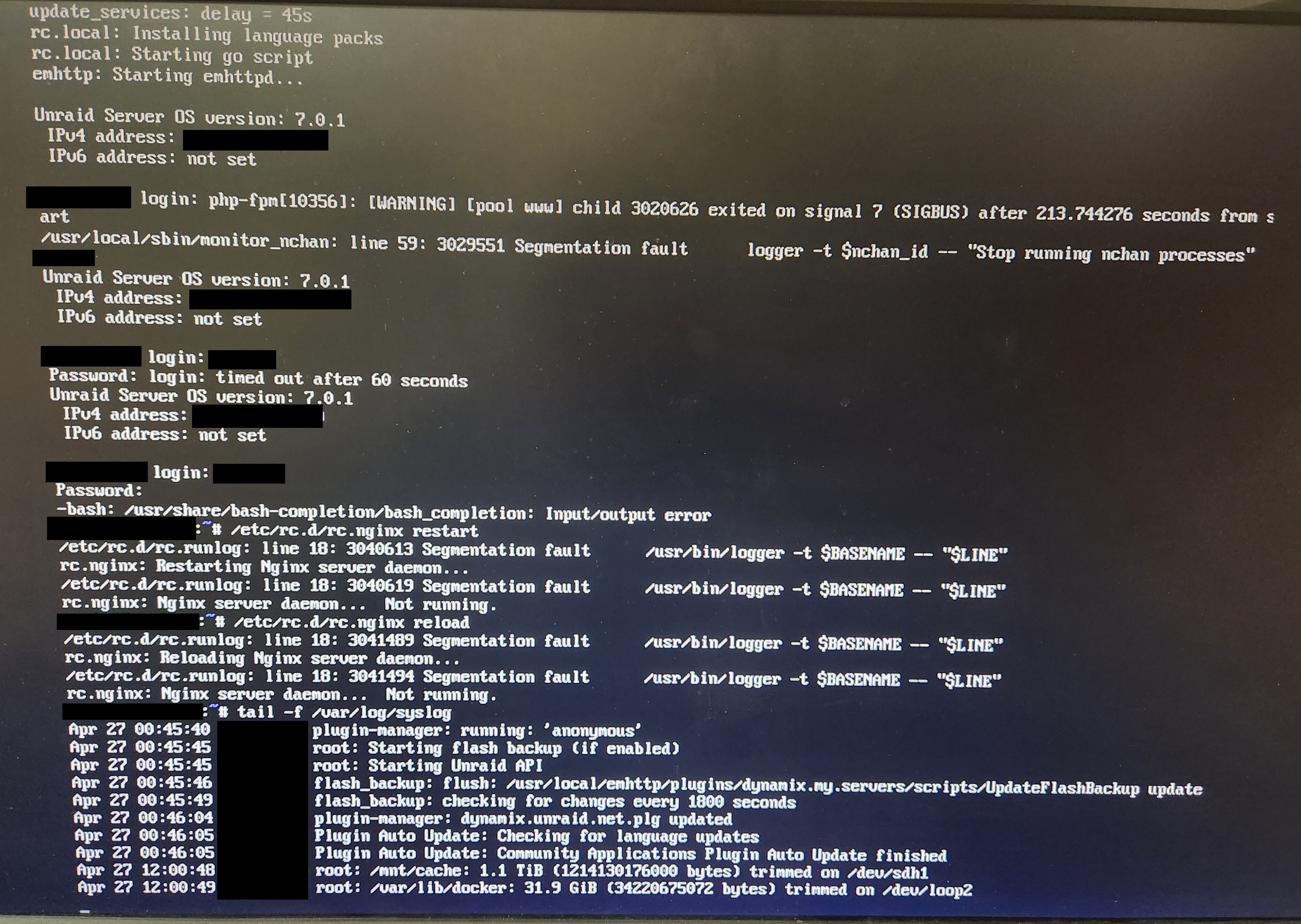

I am unable to connect to the Web UI, but other aspects of the server (Docker, shares) seem to be functioning, at least partially.  I saw a message on the Web UI about problems with the flash drive, but I reloaded the page and lost connection.
I have access to the command line and tried a few commands to fix or identify the issue (attached image).  The diagnostics command is not found.  The /boot folder appears to be empty.
What is my next step?  I've picked up a new flash drive to use if needed.

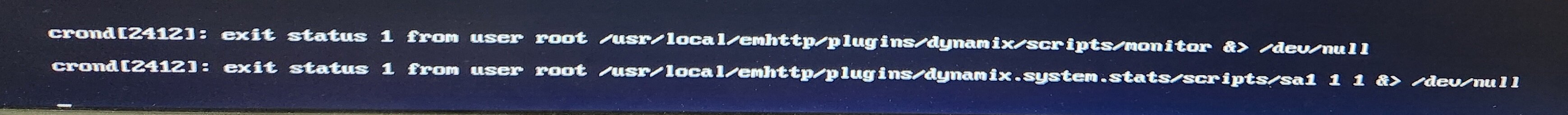

Unfortunately, I lost command line access overnight.  Just see a couple repeated lines on the attached monitor, and login doesn't work.  No SSH access either.
Seems like I'll have to do a hard shutdown now.
