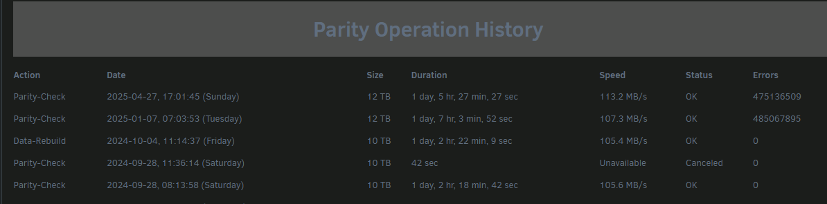

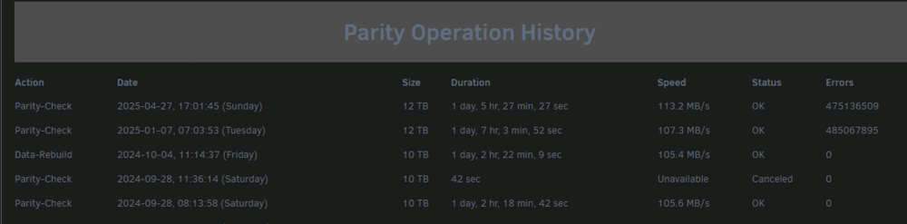

Most recent parity check finished today with ~500 million errors. I was shocked and checked the history  to see that the prior check in January returned similar. I don't know how/why I didn't see that at back then. It would have shocked me then too since I have only ever had 0 errors.
The server has been running just fine as far as I can tell. In the interim, I have upgraded the OS twice, first 6.11.5 -> 6.12.5 then ->7.0.1. Prior to the January check, but after the last "0-error" one, I did a total case migration. During this, all HDDs were moved from old norco hotswap bays to direct mounting and connections in a bigger case. Also upgraded the CPU, added 2 SSDs, and replaced all the sata cables (that aren't connected via breakout cable.
