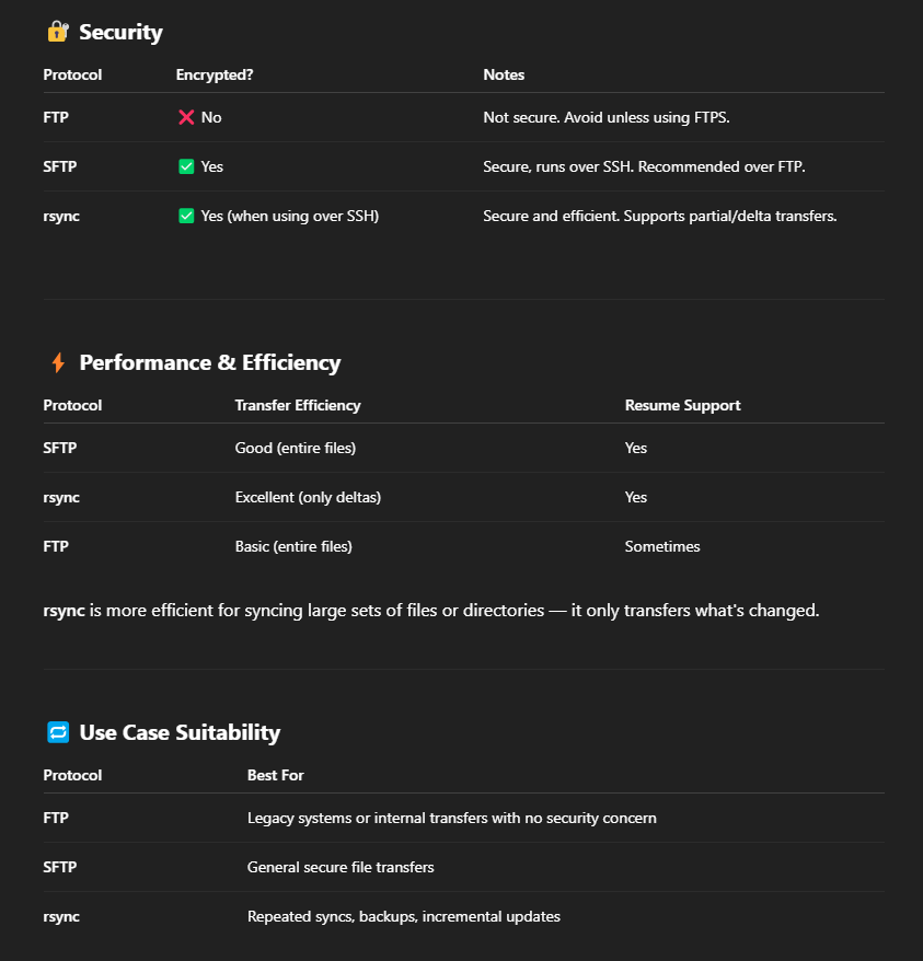

--this is why I prefer to use sftp and a different protcall for theses to have thess features and to guranee that file.

I use a combination of tools, scritps and settings... I'm a fan of sftp. I recenlty made a docker where I can share and use file zilla to access my unraid and move data between pc.
Yes rsync can connect to a sftp remote to pull data and vise vera to send data...
syncthing was a pain and endedup forceing the home folder for defualt synthing to send data. I don't agree withsome of syncthing tor principle and file sahring it does. you need atleast 3-4 machines that need the same data before syncthing is viable...
seafile is another example... then theres the rclone plugin and doceker as example instaead of using a user script.
nerdtool / unget / 3rd party unraid slack ware applciaiton installs for some other tools to use installed things like the rwrapper above...
My systems use zfs and I can even leveragy zfs send snapshot and copies between disks...
It all comes down to how you want to interact with it, and what you want it to do...

Chat example ftp / sftp / rsync
as, how the disk are talking to each other and how you connect to the remote machine can equally be a issue...
Thus I recommend SFTP and its protcall since we are dealing with files...
