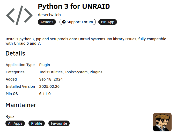

You may need to install python to the unraid host...
Desertwitch / ryse python plugin in the ca should help there...
