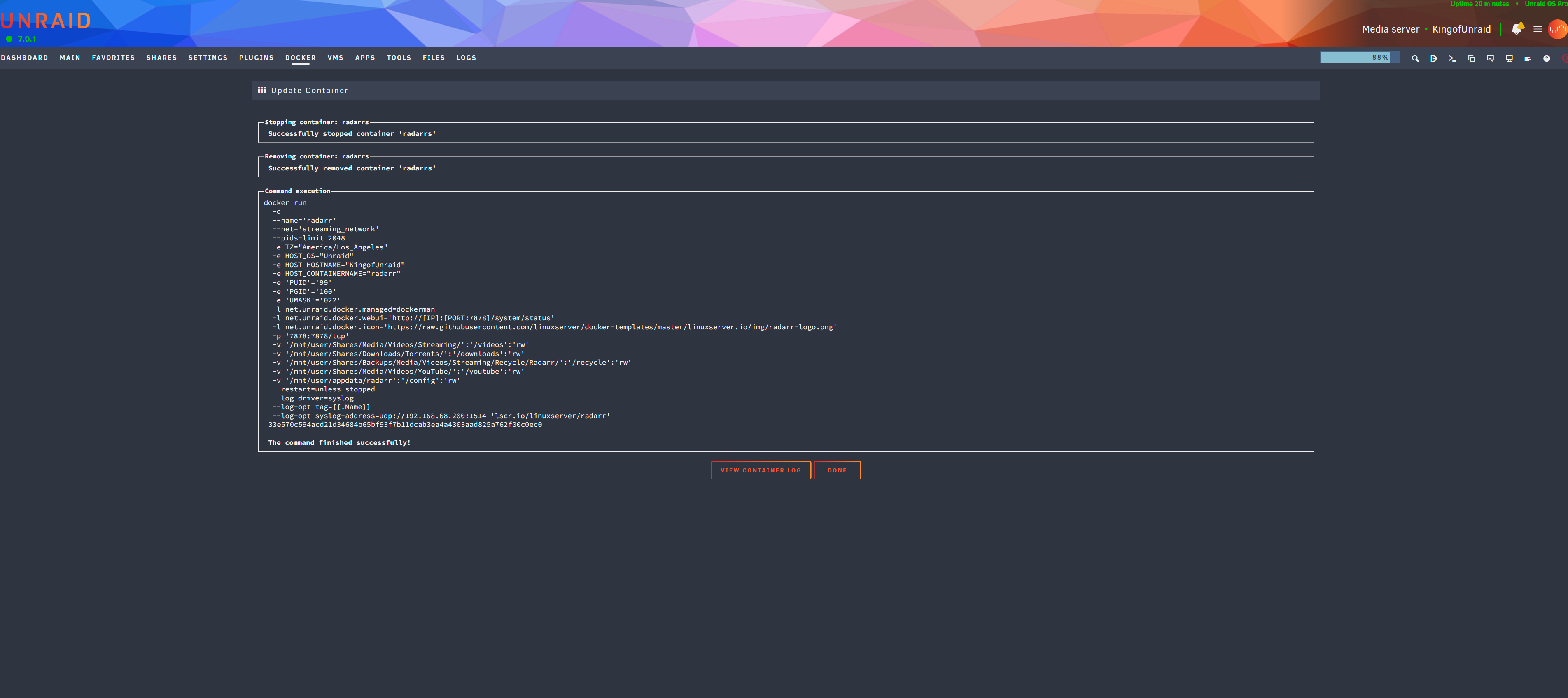

Post docker run
Is this correct?

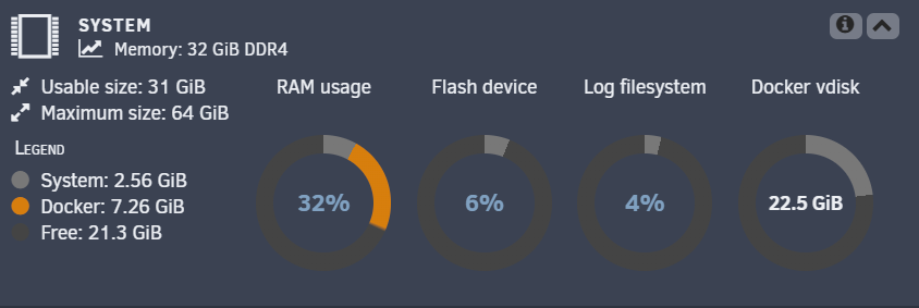

Why do you have 100G docker.img? Have you had problems filling it? The usual cause of filling docker.img is an application writing to a path that isn't mapped.
Docker vdisk is only at 22GB and has not filled up. I do not believe so. I have attached my most current diagnostics as well.

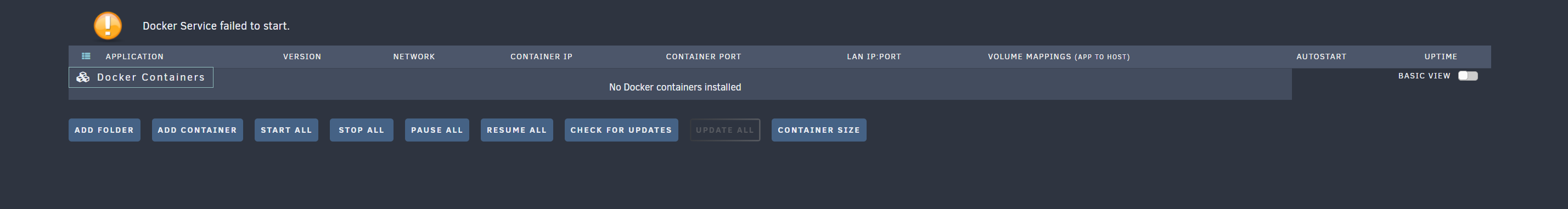

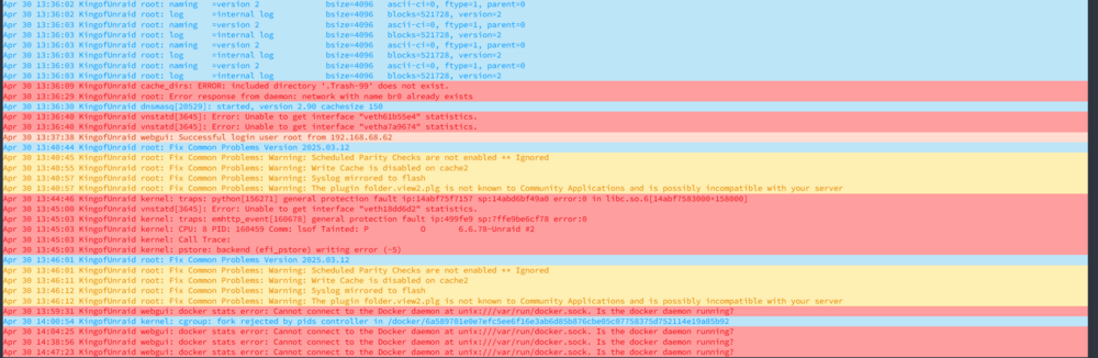

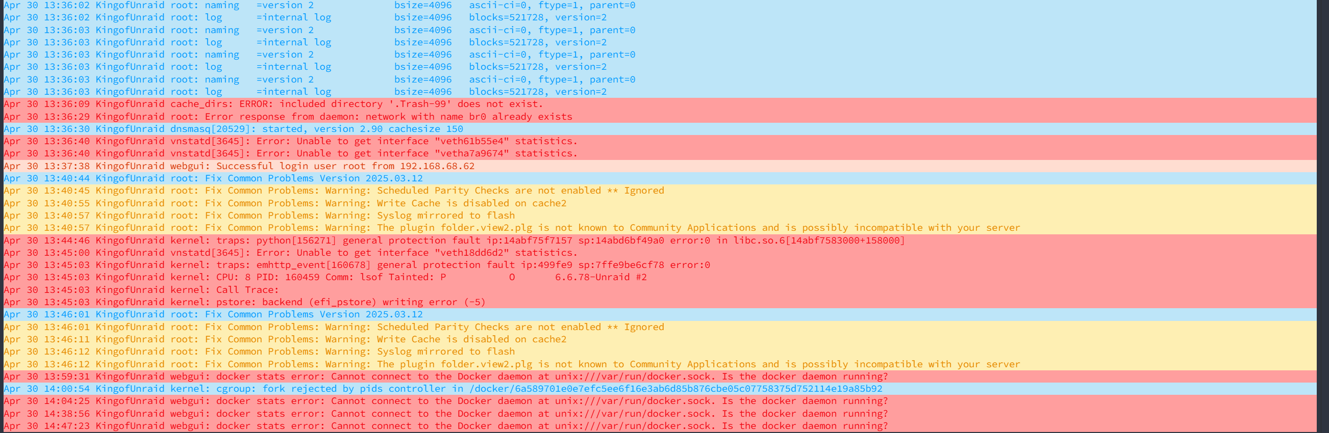

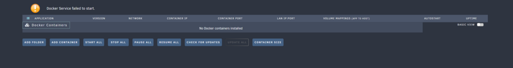

Today, the system keeps becoming unresponsive every time I reboot. This last time that it occurred, the dashboard has not gone offline, but docker is showing in a failed state. Below were the errors within the log as it stopped working. Hope this is helpful.
  • I can still access most docker apps even with docker in a failed state via their URL.
  • The apps cannot connect to each other and I cannot UNC to my shares from another workstation.
  • qBittorrent is still downloading, but they are stuck in a "moving" state once complete.
I have seen this behavior before and at some point the server will go offline and no longer be pingable. Is this all caused by docker becoming unavailable?

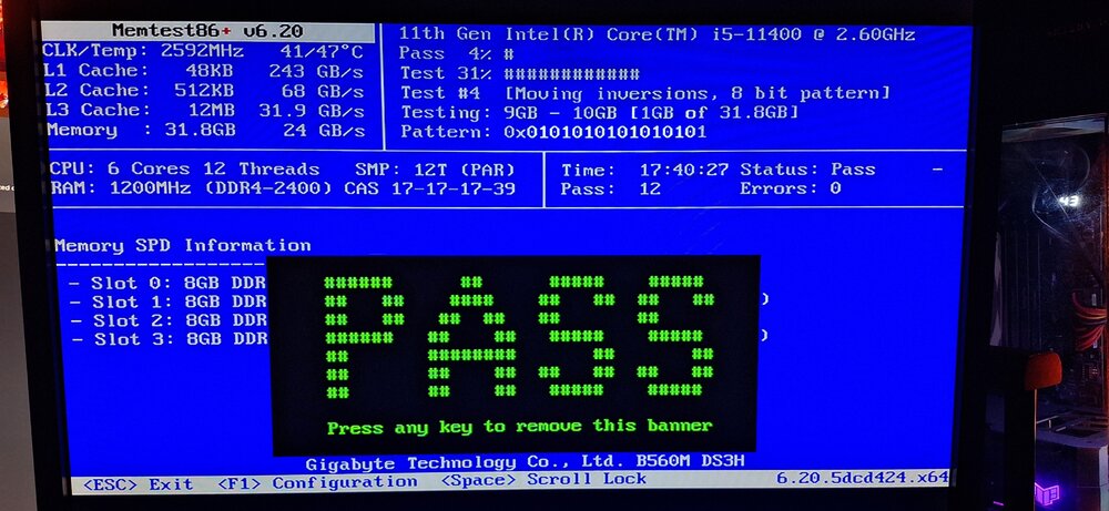

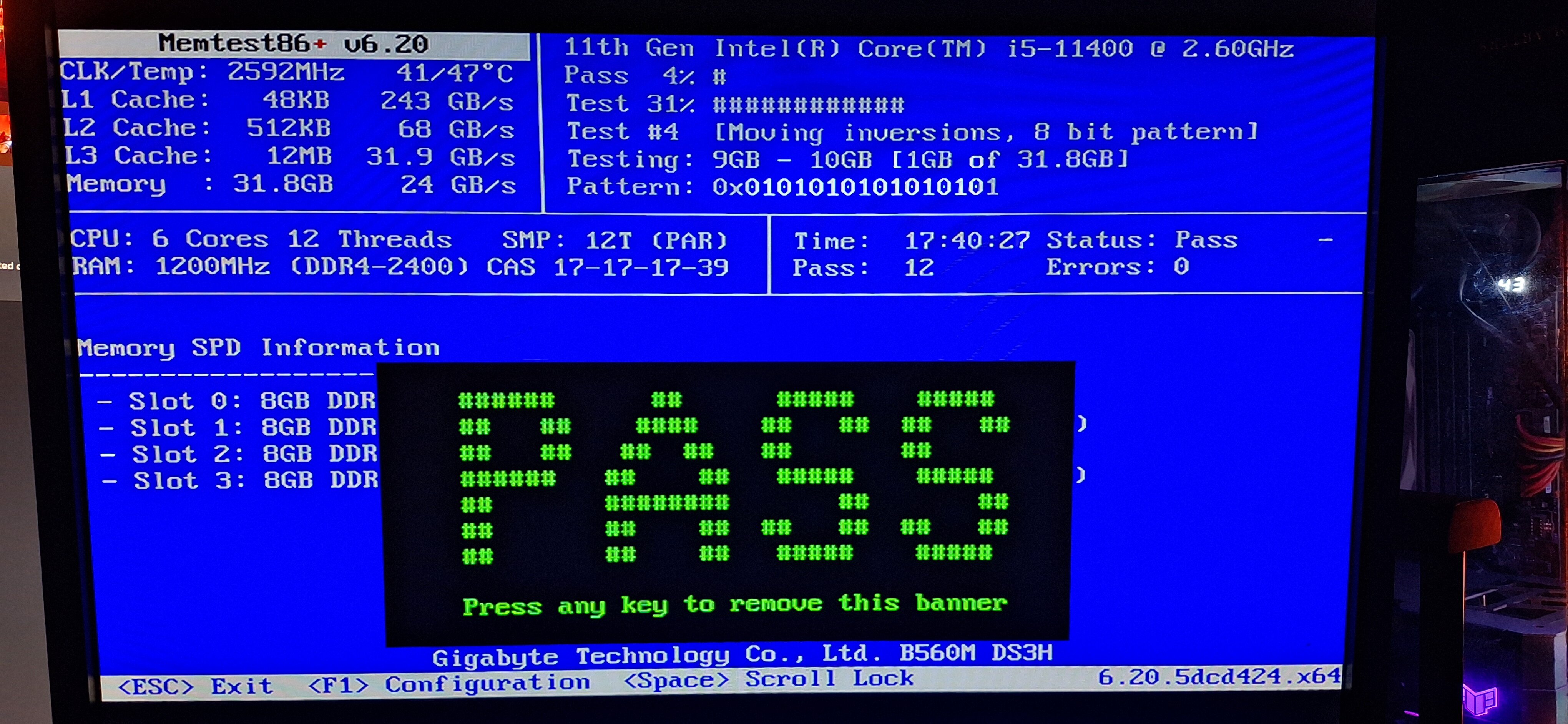

There are some call traces logged, start by running memtest.
Running Memtest now!
Good morning,
I ran memtest for almost 18 hours with no errors.
memtest is only definitive if it finds errors, since you have multiple RAM sticks, try using the server with just one pair, if the same try with the other one, that will basically rule out bad RAM.
It appears to have been bad RAM. I will continue to test overnight and reply tomorrow.
