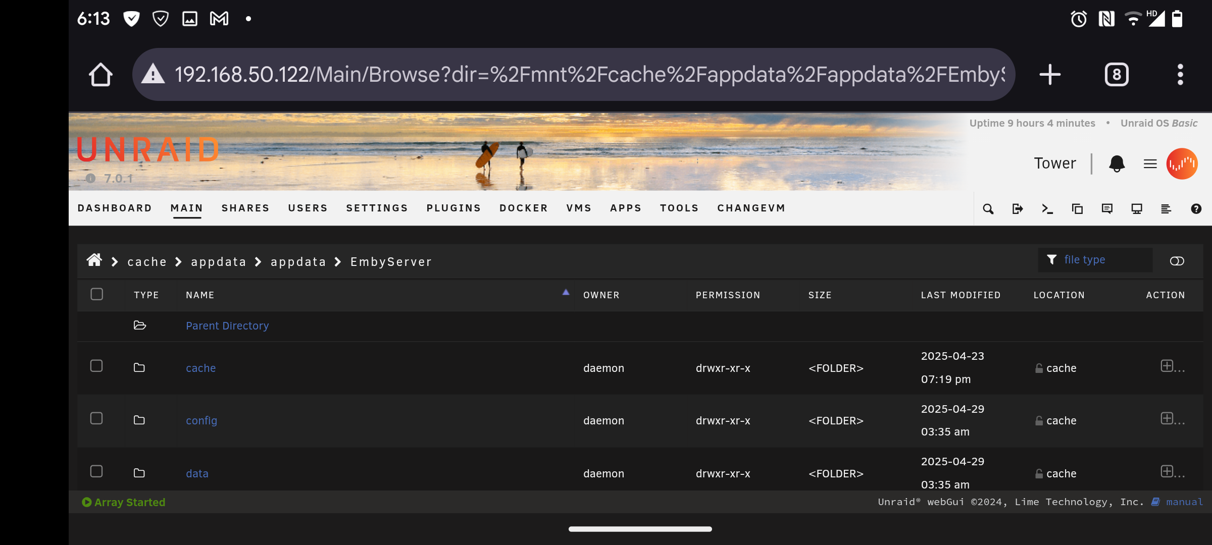

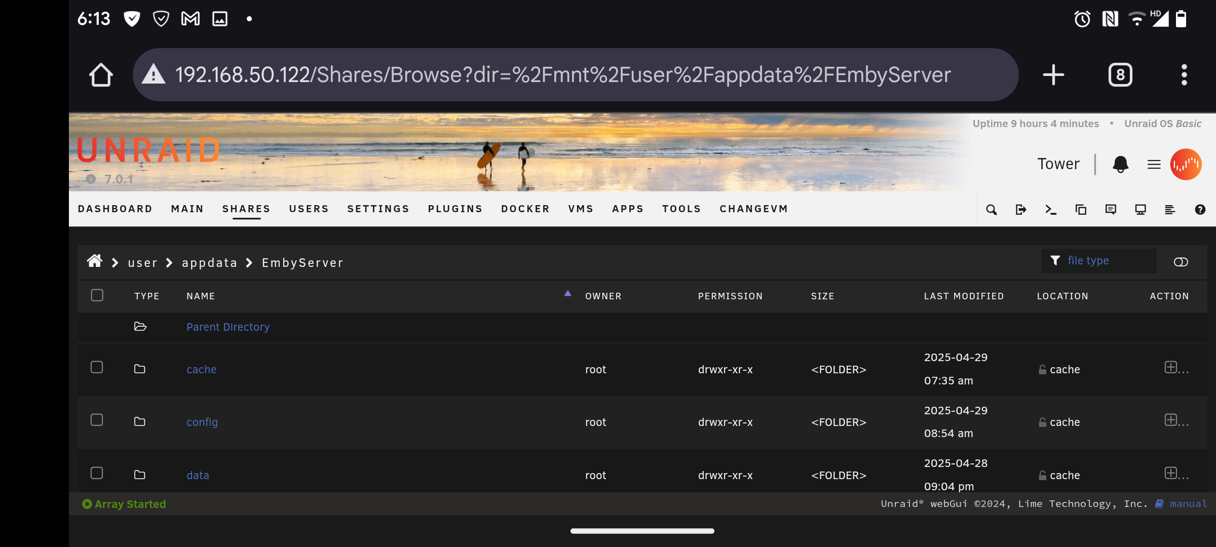

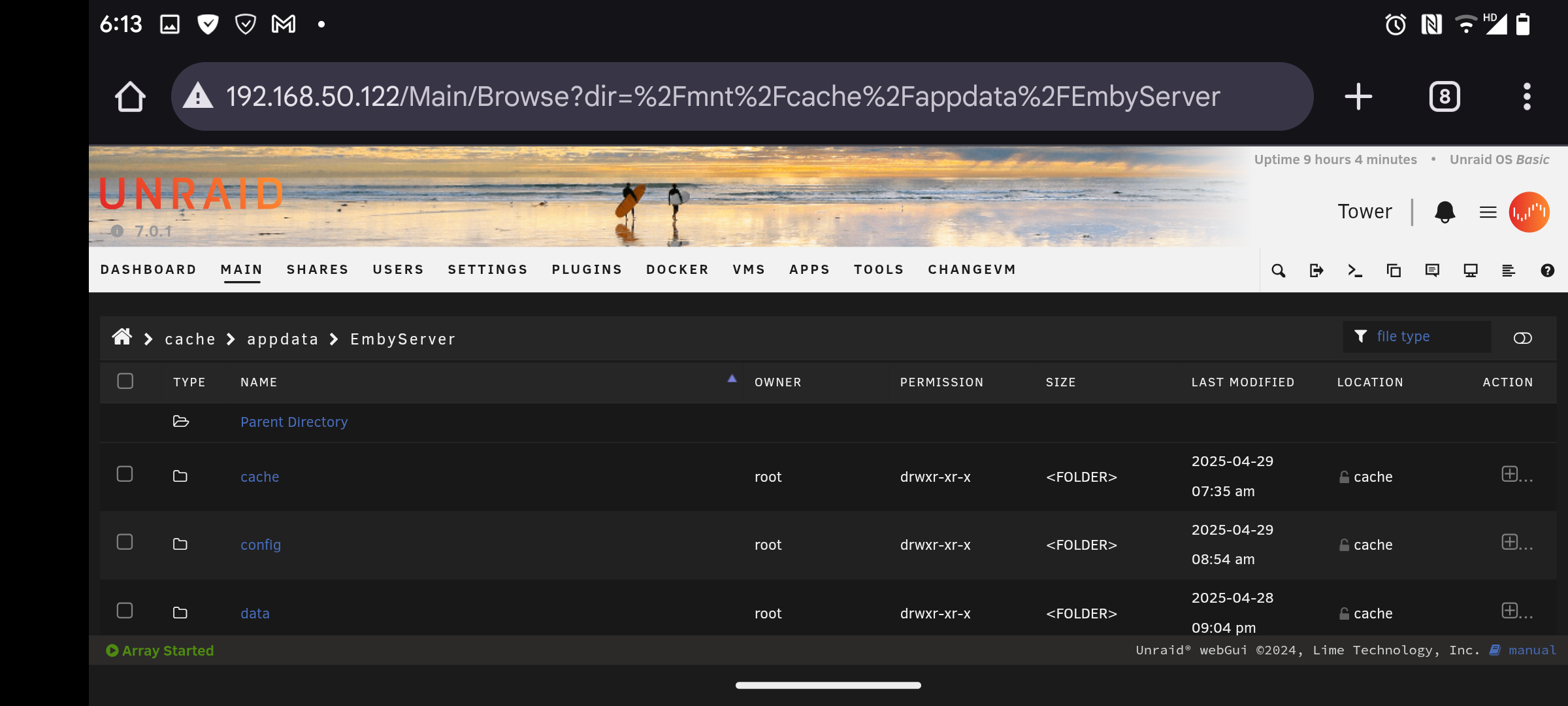

But I now have one small issue. Now I have duplicate appdata folders and locations. How do you recommend I delete the duplicate data without harming my NEEDED appdata folder location?
Currently my dockers only retain information if it's in /mnt/cache/appdata/appdata/whatever docker.
But currently I also have /mnt/cache/appdata whatever docker.
Also I have a /mnt/user/appdata location as well, do I really need this?
See attached screenshot.
It shouldn't really matter if one is /mnt/cache/appdata or /mnt/user/appdata as they both reference the same place. (just a different way to get there)
You might have something that's accidentally set to /mnt/user/appdata/appdata/EmbyServer so you need to double check that

if I point my docker containers to /mnt/cache/whatever the docker containers do not find any user settings and this is for all my containers, so I have a duplicate of everything.
Only when I point containers to /mnt/cache appdata/appdata/whatever then my containers pull in user settings. I just referenced emby here as an example.
I need to figure out how to delete the duplicate data, it's making configuration confusing for me...
You must have tried to reinstall without using Previous Apps, before I posted the links about that. So it created new appdata using the default template for the container instead of the templates you had saved.
If you think your appdata is really in /mnt/cache/appdata/appdata (why?) then you could just change the mapping to go there instead of the (more normal) /mnt/cache/appdata.
Or better, just copy /mnt/cache/appdata/appdata to /mnt/cache/appdata.
Not that hard to figure out and not that hard to do. Just takes some attention to detail.
