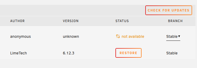

Today I restarted the server due to the UI not showing any of the HDDs in the array even though everything else was running. For some odd reason I also checked to see if there was an update of the system and what you see below is what I got. When clicking on the 'check for updates' button, I get a blank white box with no text and besides the title of the box, the only other thing there is the button 'done'

It is possible that you are on such an old version that the current update mechanism is not working properly?  You can always use the Manual update method if that is the case.
Correct me if Im wrong... but this isnt TOO old...
If a manual update is required... it's going to be a while till I do... I would have to tear apart my entire server because the USB is internally mounted in it

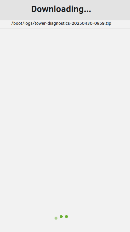

Thinking you're correct. Trying to download Diags now, but after waiting 5 mins for it(never waited this long before) The usb must be on it's last legs
The screenshot is after 5 mins
