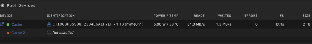

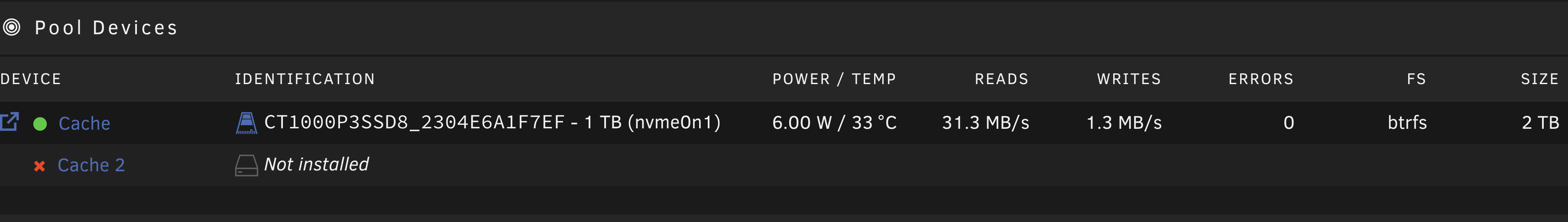

How to remove Cache 2 aftrer installing an extra drive.
I added a  3TB hard drive to the cache pool.  it now shows that the  1 TB NVME card is no 2TB.

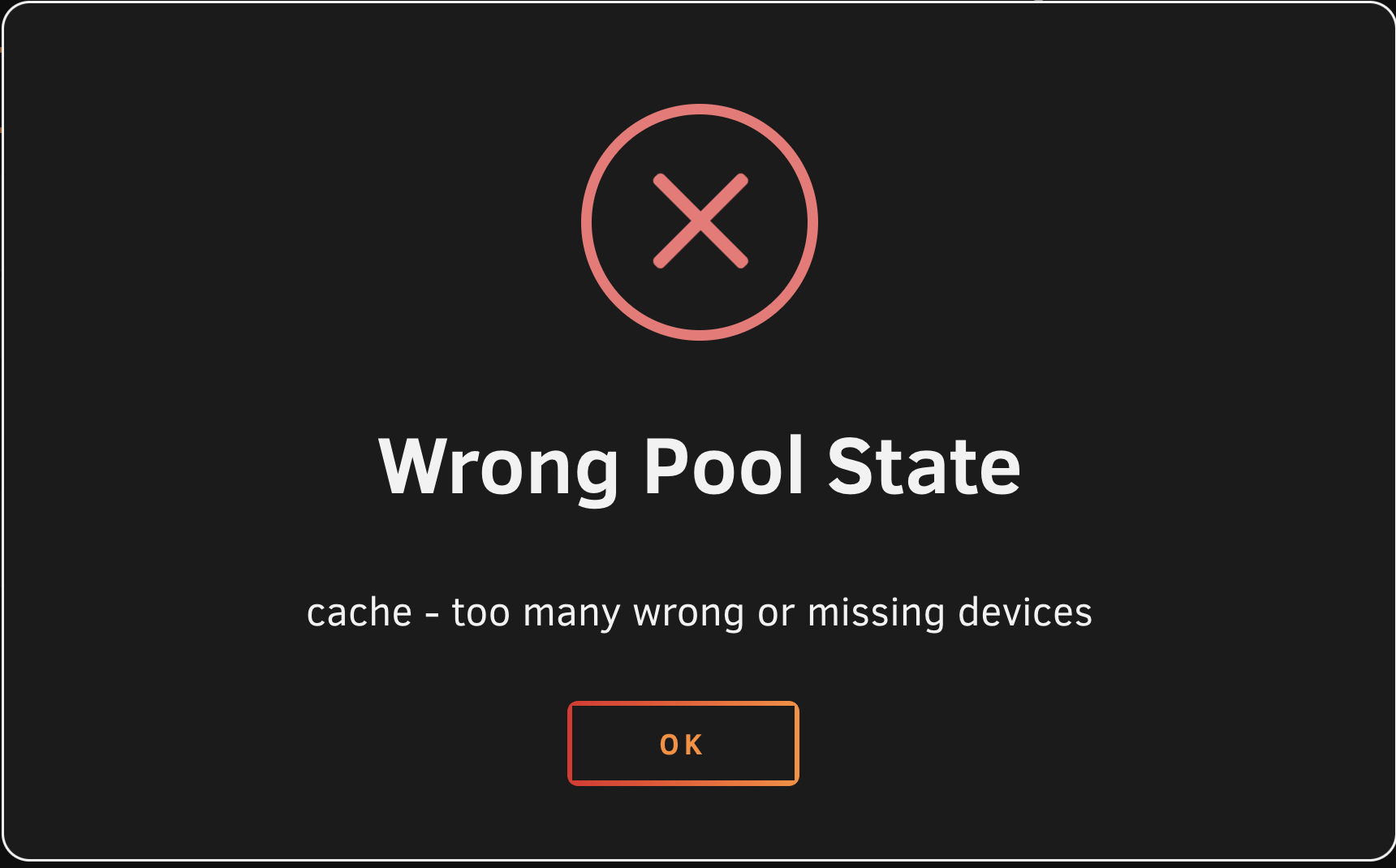

I have tried  to assiagn an old 240 SDD and receive the following error and comments in the screenshots
Is it possble to delete and reinstall it as i am unable to remove it.
Any help would be appreciated.

 Hi Thank you for your reply , sorry that i didn't reply earlier as i have bee away for a few days.  i followed you solution by  pasting the script in to unRaid terminal (hope that this correct) Then the second script there was indication that any thing had happened.  I then  went to the next step and  stopped the array and follwed the info.  I received  the same error and still have the same issue.
 As a newbie could you please explain where i am going wrong, shoould there be some indiaction  does the script just work in the background or have installed the script wrongly?
Thanks for your help .

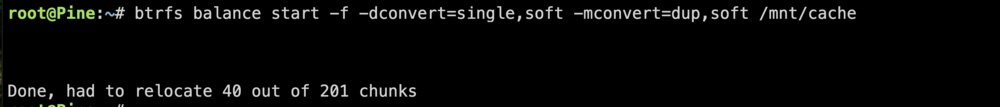

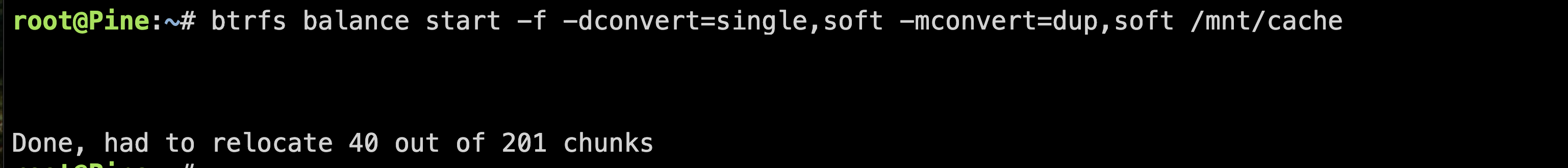

Pool still looks the same, let's try one step at a time:
On 5/1/2025 at 9:19 AM, JorgeB said:
With the array running type:
btrfs balance start -f -dconvert=single,soft -mconvert=dup,soft /mnt/cache
Then post new diags.
 screenshot shows details after pressing return. diagnostic
