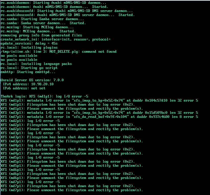

This is what I see 15 seconds after I start the array:
and then I have to shut it down. :(
