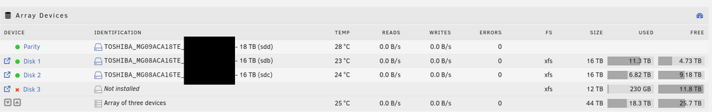

My empty Toshiba N300 12TB drive that I added a few weeks ago has stopped working (I have it from 2023). I will be sending the drive for warranty. Toshiba is sending a courier and the drive is going from me from Poland to Germany. I don't know how long it will take or what the finale will be. There was no data on the drive, except 230GB, which was added by the system. In Unraid I saw that the drive had over 2k errors and would not boot. The disk was making loud noises and I quickly shut down the server and pulled it out. Unfortunately, I did not withdraw it to “Unassigned Disks”. Faulty 12TB disk has in Unraid status "not installed". I want to remove this disk from Unraid and have parity protection on the 2x16TB disks where I have data. How do I go about this?
Of course, I want to keep the data on the 2x 16TB and I want it to be protected by parity. What do I need to do?
1.)Stop Array
2.)Tools --> New Config
And what to set there? In “Preserve current assignments:”
3.)Then I need to run the array and it will start rebuilding by itself with preservation of data?
Will Jellyfin work during the rebuild?

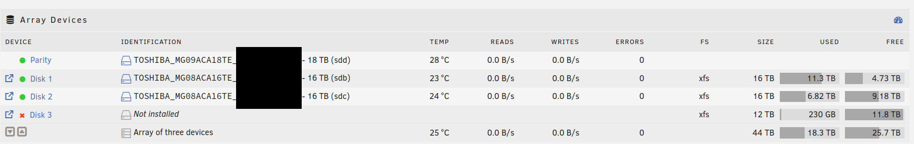

Solved by JorgeB
Keep all, then start the array to begin the parity sync.
Yes, assuming disk3 is really empty

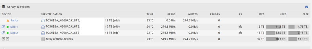

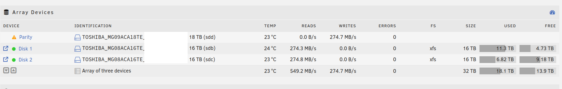

Thanks JorgeB, it is in progress :)
