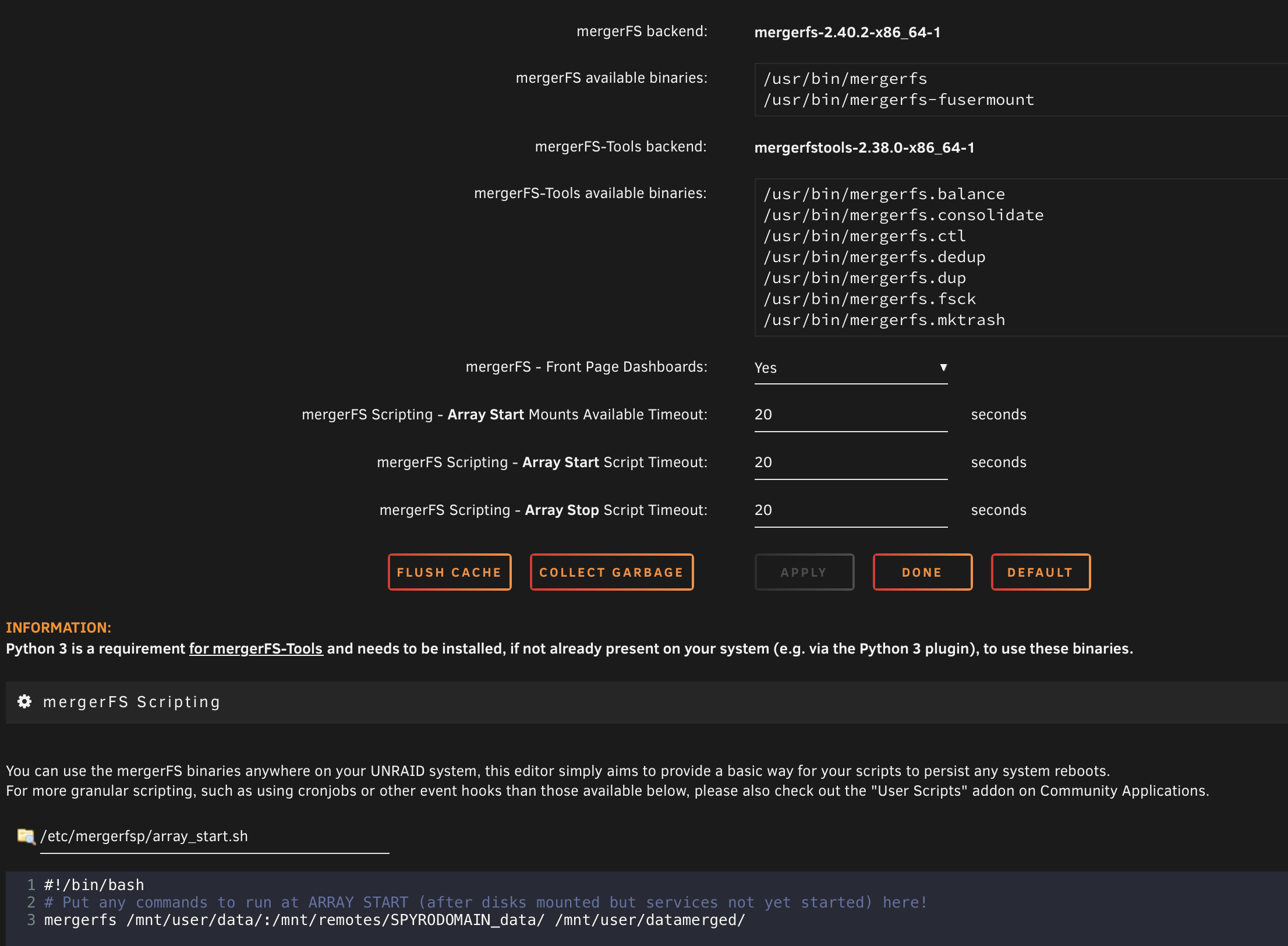

Using the mergerfs plugin, I tried to run this command on Bandicoot:

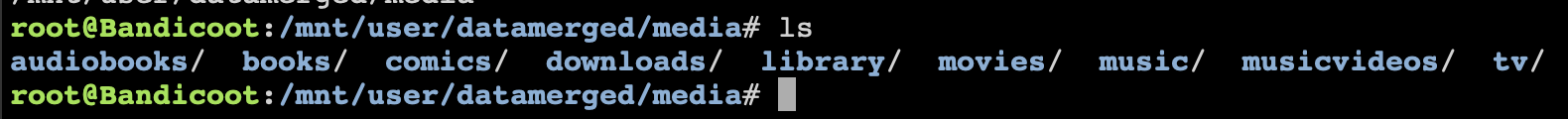

mergerfs /mnt/user/data/:/mnt/remotes/SPYRODOMAIN_data/ /mnt/user/datamerged/
trying to combine my local data directory (on Bandicoot), with the data directory on the Spyro server, saving it under a new directory names datamerged, on Bandicoot.

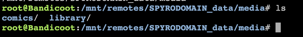

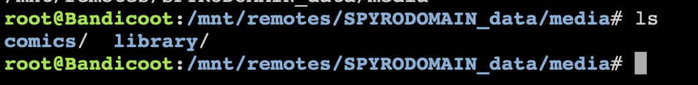

However, I am not seeing any of the data stored on Spyro in this directory and when I go under /mnt/user/remotes/SPYRODOMAIN_data/ directly, it appears to be out of date and not saving information actually visible on the Spyro server.

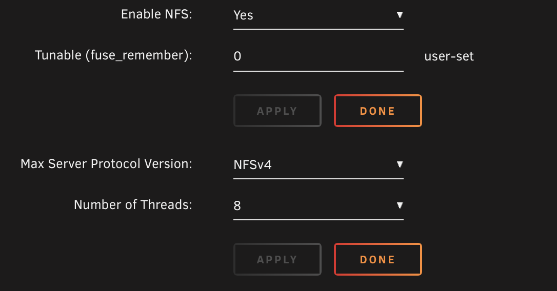

NFS Settings on Spyro:
NFS Settings on Bandicoot:

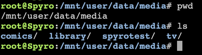

On Spyro directly, inside of the data folder:
On Bandicoot directly, inside of the remotes directory:
On Bandicoot inside of the MergerFS created directory:
Bandicoot MergerFS plugin Settings:Screenshot2025-05-01at2_30_32PM.thumb.png.596a7b72af4bd1cd4a03d31b0c4cebd1.png
