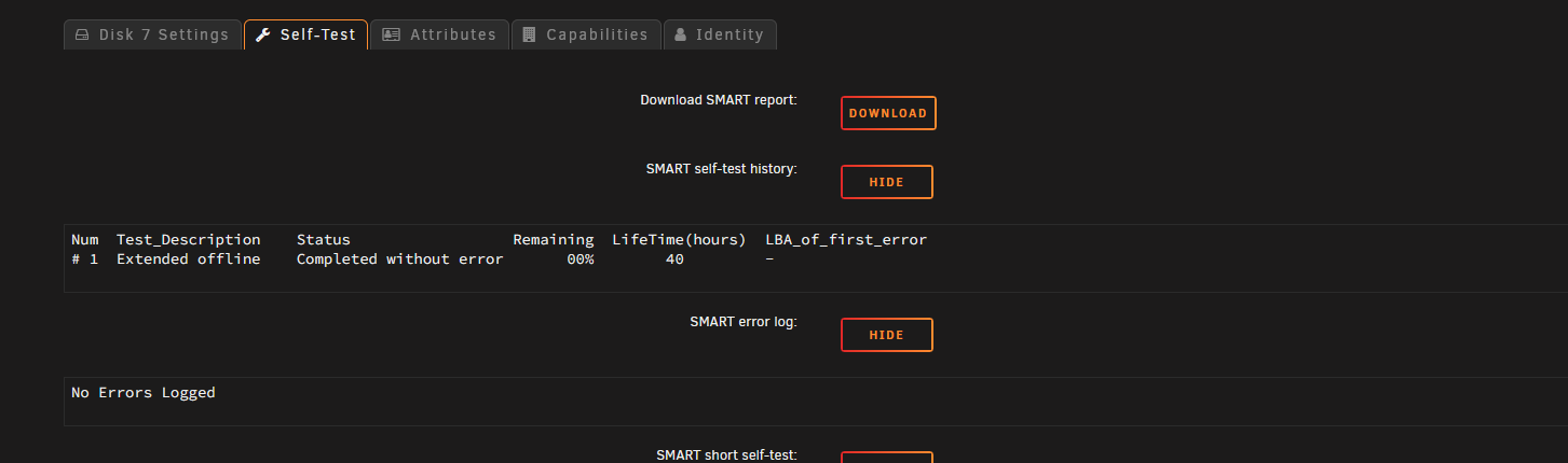

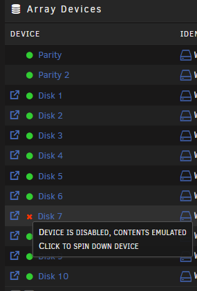

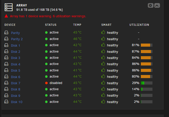

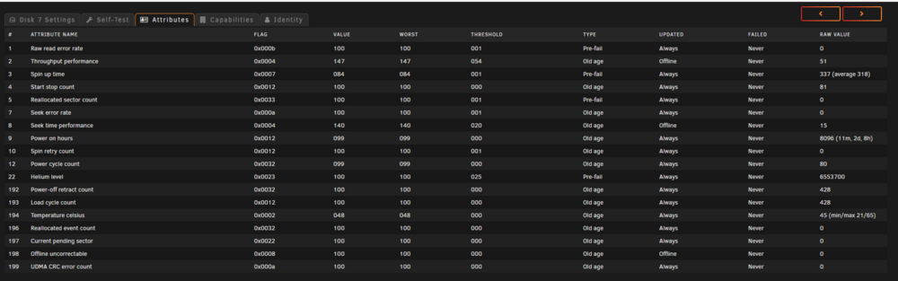

May 2, 20251 yr So I found out that one of my drive was disabled I am not sure if there is something wrong with the drive. I ran a self-test and it said that there was no errors. Can anyone help me check what needs to be done next? Should I hook it up to my windows machine perhaps?
May 2, 20251 yr Community Expert Disk just dropped offline, this is typically a power/connection issue, replace cables and since the emulated disk is mounting and contents look correct, you can rebuild on top. https://docs.unraid.net/unraid-os/manual/storage-management#rebuilding-a-drive-onto-itself
May 2, 20251 yr Author Solution Thanks, I will try swapping it with another drive maybe and check the cabling.
June 15, 20251 yr Author I swapped drived but it did not work. I ended replacing the drive.The funny thing is that I put that disabled drive into my 2nd unraid and it does not have any issues there.So... I am not sure what was wrong
