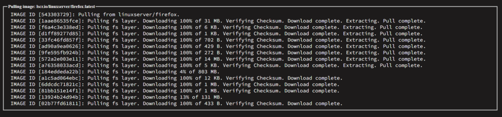

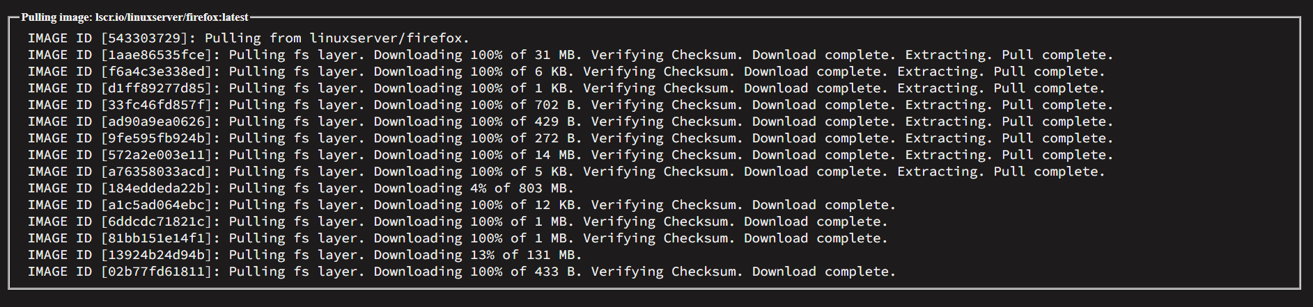

I am also having this problem with large files being pulled over 200MB. A 800MB Firefox took just shy of two hours.

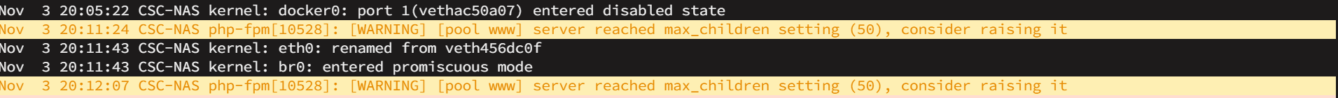

It appears you may have a docker container crashing and restarting over and over which may be why your specific case is causing massive slowdowns. Or it's the php errors. (these two things are probably related)

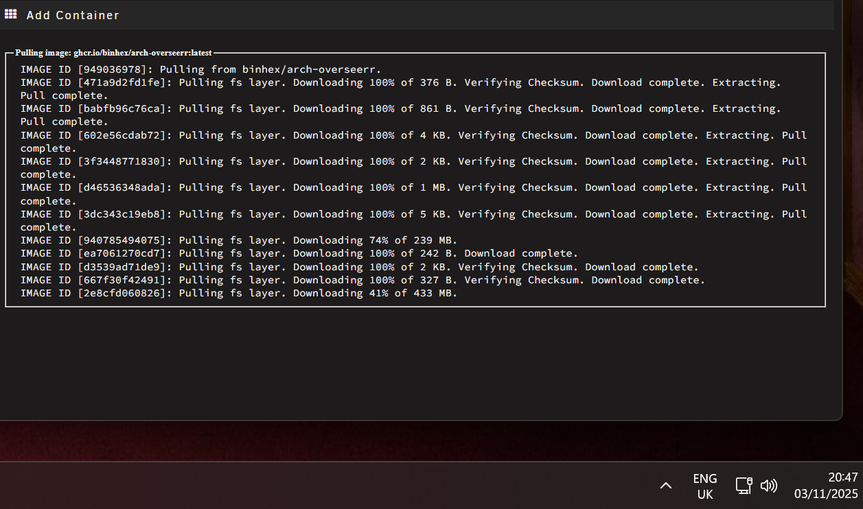

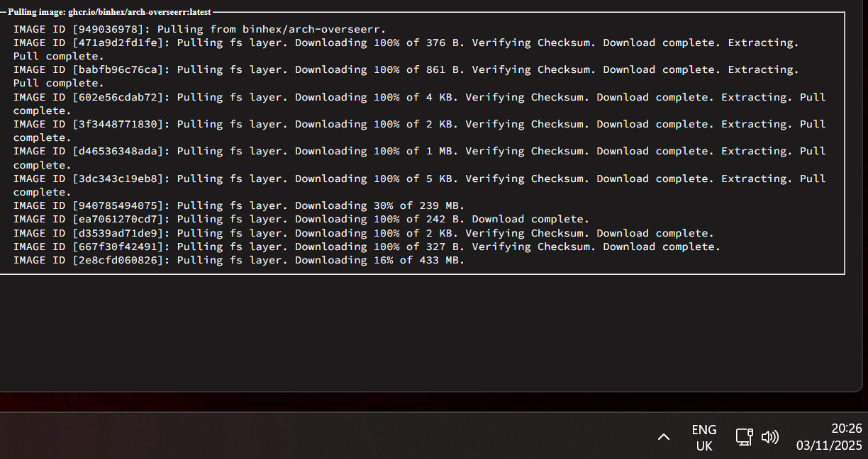

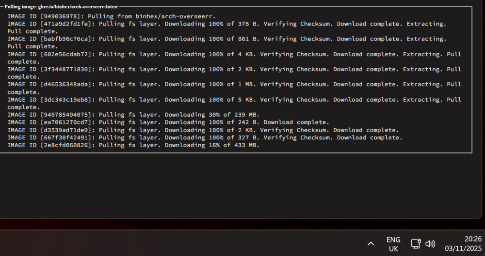

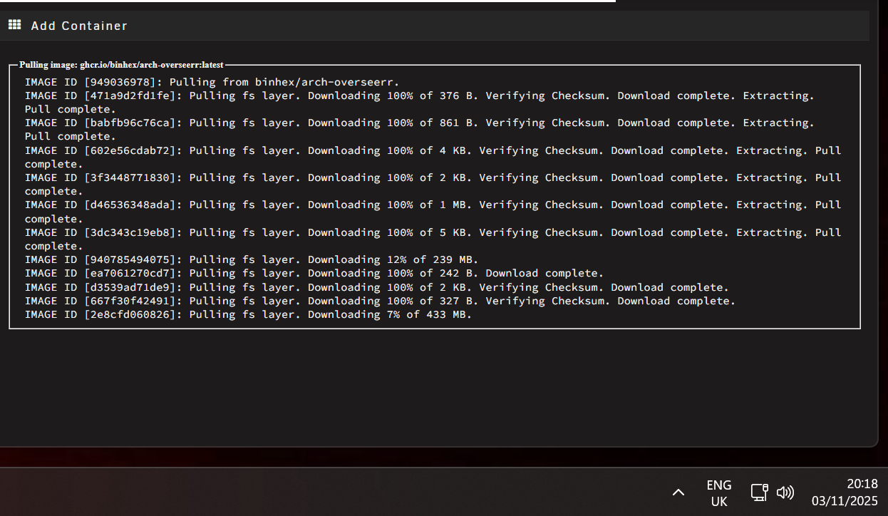

Ok well I've fixed the script @MowMdown thankyou, but the docker speed issue:
This was with all dockers switched off:
Logs:
Nov 3 20:23:19 CSC-NAS nginx: 2025/11/03 20:23:19 [error] 10624#10624: *77743 upstream timed out (110: Connection timed out) while reading response header from upstream, client: 192.168.2.244, server: , request: "GET /webGui/styles/bitstream-bold.woff?v=20220513 HTTP/2.0", subrequest: "/auth-request.php", upstream: "fastcgi://unix:/var/run/php-fpm.sock", host: "ip:port", referrer: "https://ip:port/Apps/AddContainer?xmlTemplate=default:/tmp/community.applications/tempFiles/templates-community-apps/BinhexsRepository/binhex-binhexoverseerr-latest.xml"
Nov 3 20:23:19 CSC-NAS nginx: 2025/11/03 20:23:19 [error] 10624#10624: *77743 auth request unexpected status: 504 while sending to client, client: 192.168.2.244, server: , request: "GET /webGui/styles/bitstream-bold.woff?v=20220513 HTTP/2.0", host: "ip:port", referrer: "https://ip:port/Apps/AddContainer?xmlTemplate=default:/tmp/community.applications/tempFiles/templates-community-apps/BinhexsRepository/binhex-binhexoverseerr-latest.xml"
Nov 3 20:23:48 CSC-NAS nginx: 2025/11/03 20:23:48 [error] 10624#10624: *77743 upstream timed out (110: Connection timed out) while reading response header from upstream, client: 192.168.2.244, server: , request: "GET /webGui/include/OpenTerminal.php?tag=syslog&name=syslog&more= HTTP/2.0", subrequest: "/auth-request.php", upstream: "fastcgi://unix:/var/run/php-fpm.sock", host: "ip:port", referrer: "https://ip:port/Apps/AddContainer?xmlTemplate=default:/tmp/community.applications/tempFiles/templates-community-apps/BinhexsRepository/binhex-binhexoverseerr-latest.xml"
Nov 3 20:23:48 CSC-NAS nginx: 2025/11/03 20:23:48 [error] 10624#10624: *77743 auth request unexpected status: 504 while sending to client, client: 192.168.2.244, server: , request: "GET /webGui/include/OpenTerminal.php?tag=syslog&name=syslog&more= HTTP/2.0", host: "ip:port", referrer: "ip:port/Apps/AddContainer?xmlTemplate=default:/tmp/community.applications/tempFiles/templates-community-apps/BinhexsRepository/binhex-binhexoverseerr-latest.xml"image.png
This might be something one of the LT staff members who are more familiar with the webgui backend might need to look at. Im not sure what this really is coming from.
Does this behavior persist after rebooting? Does it happen with ALL docker containers or just Binhex containers?
All docker containers - firefox was linuxserver, plex was original, binhex was overseer, radarr, sonarr, and qbittorrent,
and good question I will do a reboot after this overseer has downloaded (32minutes in and I am getting 70mbps download when doing a speed test through firefox and glutonvpn).
Its soul destroying slow.
Edited by SmokeyColes
I would check the drive log for the nvme disk and the USB Drive as well.
