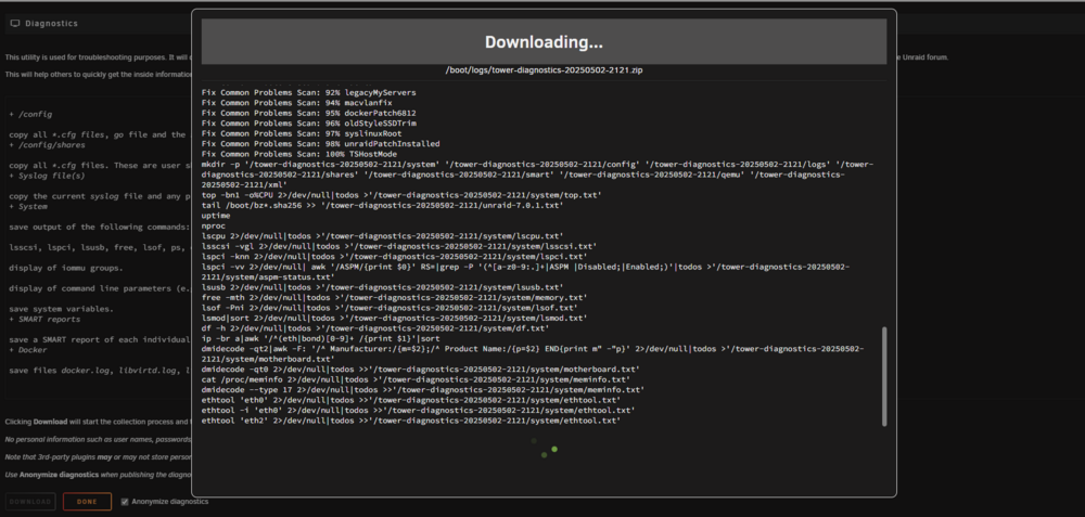

Can't download diagnostic.  Get stuck here:
