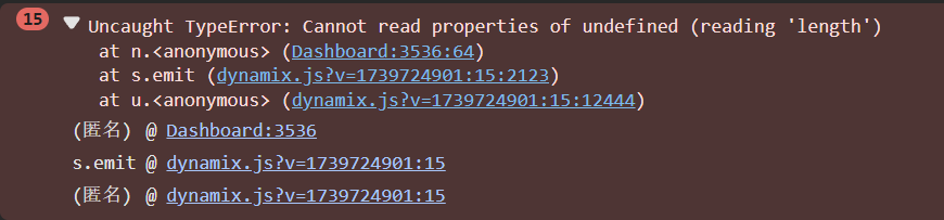

I've been having the same issue, persists after 7.1 update as well. No reverse proxy, I'm direct IP. Using brave browser, but adblocks and stuff all disabled for the site.
Edited by lordsiris
371850423_.png.63fa4efe3c1ed003536b1a747c1ceafa.png同样的问题,从7.1开始

Same thing happened to me, turned out it was something had happened to docker. Deleted it and reinstalled everything, now all is well again.
On 5/8/2025 at 4:12 PM, trurl said:
I fixed it by uninstalling UnRaid connect but here you go. My 2nd server (HP NL40) is running 7.0.1 and Connect is fine but does not run any Docker or VM's if that helps.
