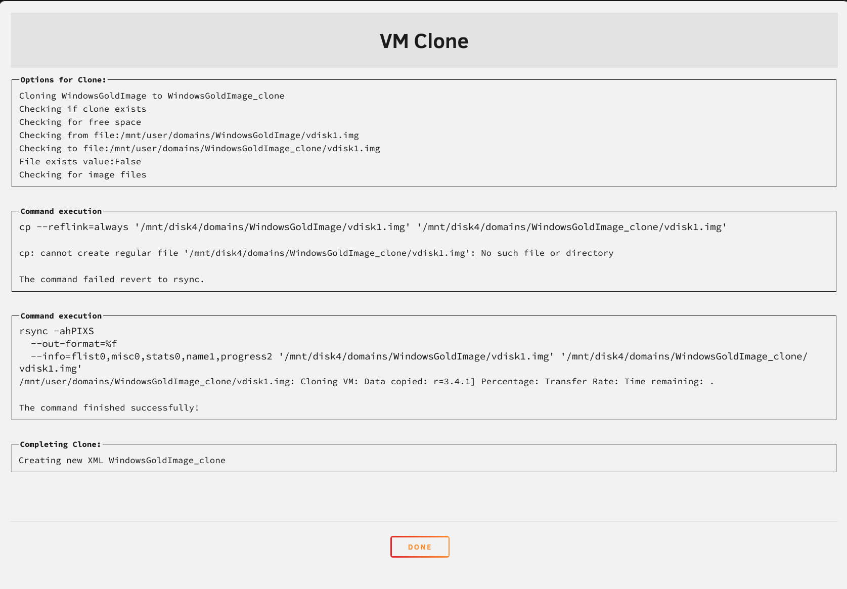

rsync error: errors selecting input/output files, dirs (code 3) at main.c(829) [Receiver=3.4.1] Percentage: Transfer Rate: Time remaining: .
I've attached a screenshot of the whole output.

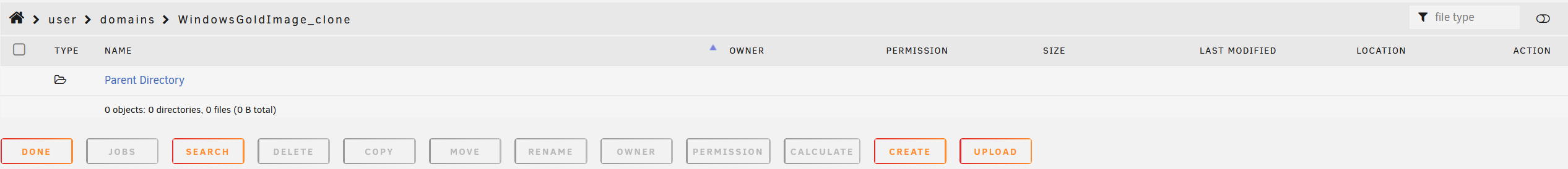

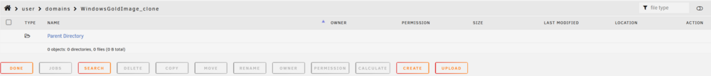

When I run clone, a new vm does popup (screenshot), but is does not appear that a disk has been created. The cloned VM does have an XML file, but I did not see a disk listed in it.
Further, a directory is created for the cloned vm, but it is empty (screenshot)

The command execution fails due to missing folder /mnt/disk4/domains/WindowsGoldImag_clone
make this folder first...
mkdir -P /mnt/disk4/domains/WindowsGoldImag_clone
esentail script when rsync to confirm and make sure the files are the same failed as the initial vdsik failed to existing in the new "clone" folder...

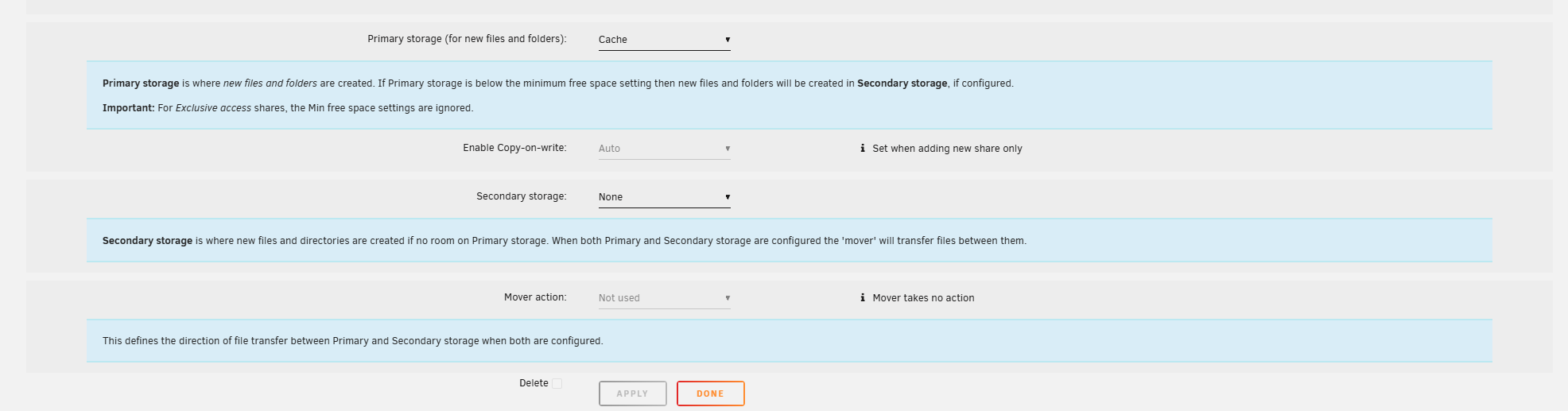

double check your share setting for domain as well as it appears that your /mnt/user/domains is not on disk 4 or its partal being assigned to it?
and the script is trying to copy and call a direct disk share not /mnt/user
as VM shouldn't have secondary storage set...

This is the way the clone function in VM manager works tries CP with reflink if that fails reverts to rsync. You cannot clone if snapshots exist.
Doing this made it work right away!
I assumed that the Clone function would also create the directory.
