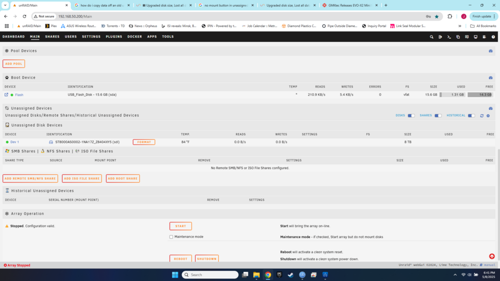

2 hours ago, bloodlust said:
I still have the original drive, Can I re-install it to get my data back?
Probably the simplest thing to do after you get everything working well again would be to use Unassigned Devices to copy the data from that original drive back to the array.

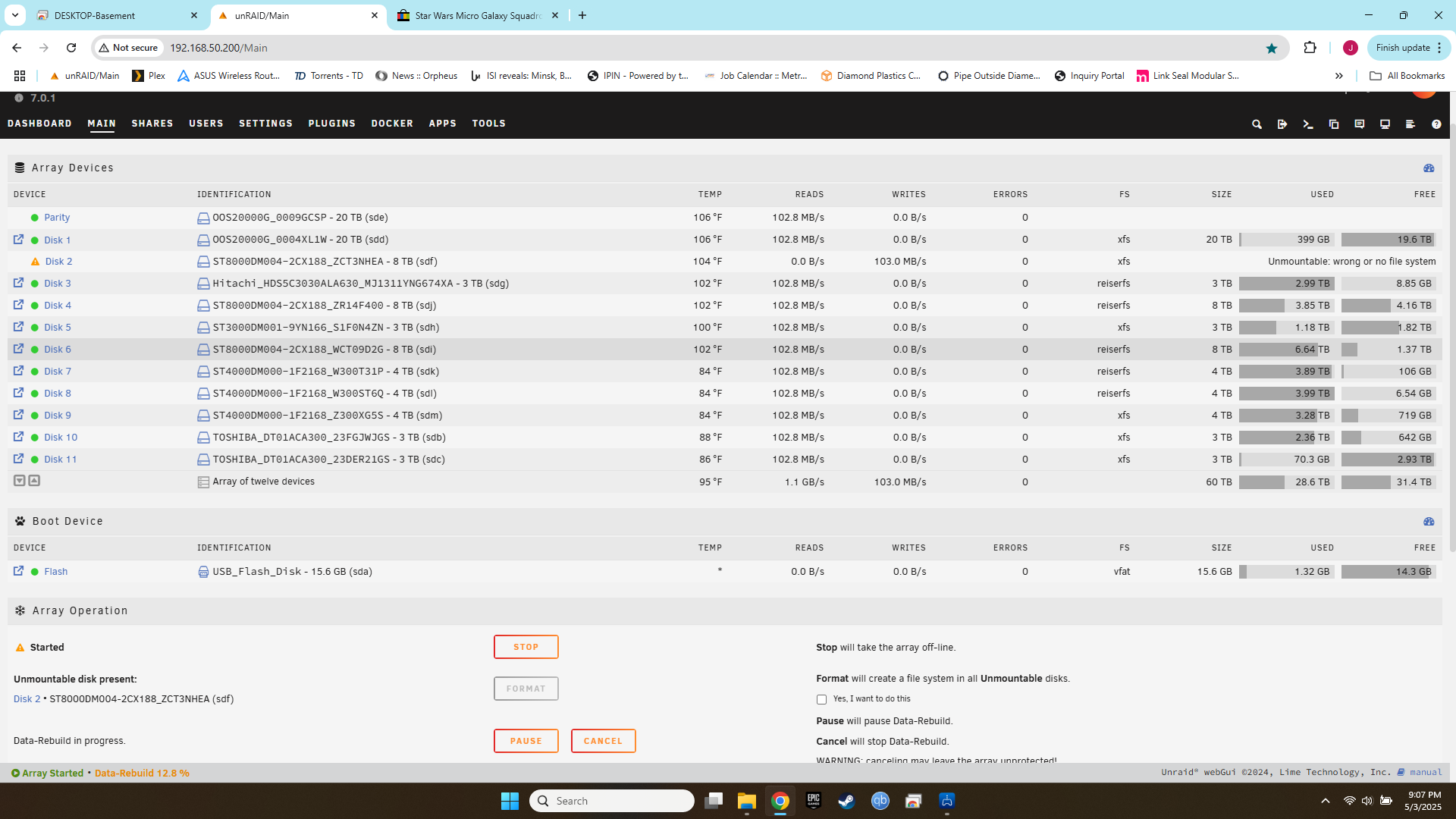

Upgraded disk 1 from 8TB to 20TB after the parity drive upgrade was successful.  Ran into issues from the beginning.  Original 8TB drive was in reiserfs, System when I replaced the original drive with the 20TB told me reiserfs had been removed and needed to change file system to XFS.  Read how to do that and changed the file system to XFS from reiserfs.  System then said disk 1 was unmountable with unknown file system and need to be formatted which I did.  After that was done it began the disk rebuild.  This took about 1-1/2 days, However during this time my disk 2 went offline and began to show unmountable as well.  I did not change anything on this drive.  Once the disk rebuild of disk 1 was complete it said it was emulating disk 2.  Disk 1 however had no data on it after the rebuild.  Disk 2 still was unmountable after reboot.  I reboot and now it says it's rebuilding disk 2, However it still shows it as unmountable.  The only thing I have changed on any of this system was the file system for disk 1 after it was new and installed.  I'm assuming the rebuild is now deleting 8TB worth of data off my disk 2 like it did off of disk 1 as we speak.

Disk 2 was the disk that become unmountable during the disk 1 rebuild when I replaced disk 1 with the larger drive.  Disk 1 was the one that lost off the info during the rebuild.  I still have the original 8TB disk 1 that was removed and still has all the data that was on it.  Disk 2 went unmountable during the disk 1 rebuild and started to error out.  After disk 1 was done rebuilding, It then began to emulate disk 2.  After reboot it began to rebuild disk 2, However it shows unmountable as per my photo.  So basically, I have lost all of disk 1 8TB of data after that rebuild, Now it's rebuilding disk 2 so I'm concerned it deleting 8TB of data on that drive as well, But it shows unmountable.  The original disk 1 is what I'm trying to get back at this point, as the drive is still intact and had been removed to upsize.

Disk 1 was reiserfs, It told me to change when I replaced the larger disk 1 because it said it was depreciated and removed.  I changed it to xfs (disk 1) then it rebuilt it, Which deleted all the data.  During that time disk 2 errored out during the disk 1 rebuild and became unmountable.  Which is where I'm at now.  I did not change any file structure on disk 2 it was always XFS.
OK, I think that clarifies things. Disk2 is the original disk2, and it was always XFS.

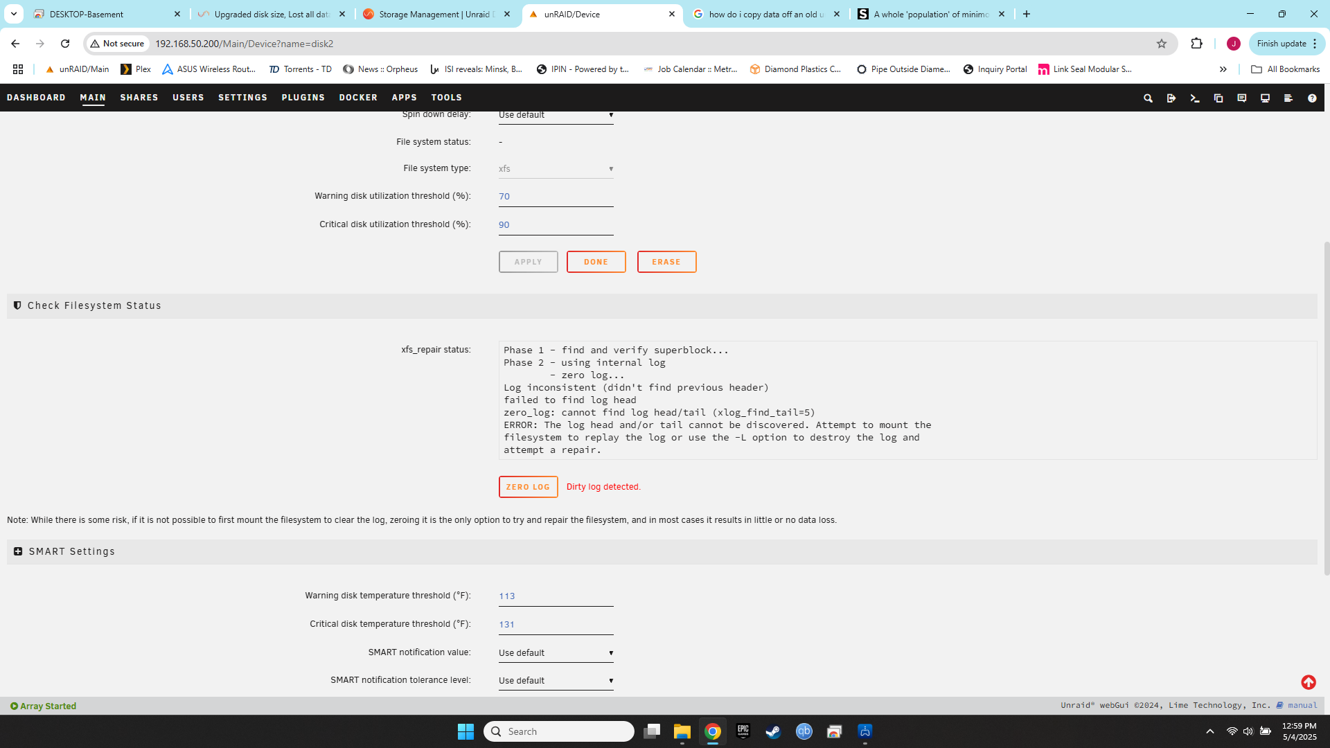

Correct, I have cancelled the rebuild.  It was at 87%.  I'm going to assume you want me to run the file system check on disk 2 correct?
correct, from the webUI

Phase 1 - find and verify superblock... Phase 2 - using internal log - zero log... Log inconsistent (didn't find previous header) failed to find log head zero_log: cannot find log head/tail (xlog_find_tail=5) - scan filesystem freespace and inode maps... Metadata CRC error detected at 0x448dcd, xfs_bnobt block 0x200774f08/0x1000 btree block 4/977381 is suspect, error -74 bad magic # 0x84f3c12e in btbno block 4/977381 Metadata CRC error detected at 0x448dcd, xfs_bnobt block 0x28084d7b8/0x1000 btree block 5/1088252 is suspect, error -74 bad magic # 0xeea943c4 in btbno block 5/1088252 Metadata CRC error detected at 0x448dcd, xfs_bnobt block 0x300ad7200/0x1000 btree block 6/1420870 is suspect, error -74 bad magic # 0x8b7d9d00 in btbno block 6/1420870 Metadata CRC error detected at 0x448dcd, xfs_bnobt block 0x3804360b8/0x1000 btree block 7/551966 is suspect, error -74 bad magic # 0x9126b8f1 in btbno block 7/551966 Metadata CRC error detected at 0x448dcd, xfs_bnobt block 0x10052ed90/0x1000 btree block 2/679348 is suspect, error -74 bad magic # 0x31d4ef8e in btbno block 2/679348 Metadata CRC error detected at 0x448dcd, xfs_bnobt block 0x18214bac8/0x1000 btree block 3/4364124 is suspect, error -74 bad magic # 0x8589053e in btbno block 3/4364124 Metadata CRC error detected at 0x448dcd, xfs_cntbt block 0x20083a010/0x1000 btree block 4/1078278 is suspect, error -74 bad magic # 0x98cf53c6 in btcnt block 4/1078278 agf_freeblks 144822588, counted 0 in ag 4 agf_longest 144689681, counted 0 in ag 4 Metadata CRC error detected at 0x448dcd, xfs_cntbt block 0x2808f2530/0x1000 btree block 5/1172651 is suspect, error -74 bad magic # 0x4b054a40 in btcnt block 5/1172651 agf_freeblks 146879059, counted 0 in ag 5 agf_longest 146631249, counted 0 in ag 5 Metadata CRC error detected at 0x448dcd, xfs_cntbt block 0x300aec908/0x1000 btree block 6/1431847 is suspect, error -74 bad magic # 0xde81f094 in btcnt block 6/1431847 agf_freeblks 166807320, counted 0 in ag 6 agf_longest 166708541, counted 0 in ag 6 Metadata CRC error detected at 0x448dcd, xfs_cntbt block 0x38043ae00/0x1000 btree block 7/554439 is suspect, error -74 bad magic # 0x99af5ea4 in btcnt block 7/554439 agf_freeblks 145245, counted 0 in ag 7 agf_longest 16334, counted 0 in ag 7 Metadata CRC error detected at 0x448dcd, xfs_cntbt block 0x100536380/0x1000 btree block 2/683122 is suspect, error -74 bad magic # 0x91d9bac1 in btcnt block 2/683122 agf_freeblks 86782429, counted 0 in ag 2 agf_longest 86658338, counted 0 in ag 2 Metadata CRC error detected at 0x448dcd, xfs_cntbt block 0x1824e94e8/0x1000 btree block 3/4838048 is suspect, error -74 bad magic # 0xc568bbca in btcnt block 3/4838048 agf_freeblks 121546750, counted 0 in ag 3 agf_longest 121417879, counted 0 in ag 3 Metadata CRC error detected at 0x47dddd, xfs_inobt block 0x2005057e8/0x1000 btree block 4/658177 is suspect, error -74 bad magic # 0xb2f1e9f4 in inobt block 4/658177 Metadata CRC error detected at 0x47dddd, xfs_inobt block 0x2806380e8/0x1000 btree block 5/815138 is suspect, error -74 bad magic # 0x826b046b in inobt block 5/815138 Metadata CRC error detected at 0x47dddd, xfs_inobt block 0x300927bd0/0x1000 btree block 6/1200000 is suspect, error -74 bad magic # 0x7ca9fc4a in inobt block 6/1200000 Metadata CRC error detected at 0x47dddd, xfs_inobt block 0x38008e6f8/0x1000 btree block 7/72934 is suspect, error -74 bad magic # 0x7b19b693 in inobt block 7/72934 Metadata CRC error detected at 0x47dddd, xfs_inobt block 0x10050ebc0/0x1000 btree block 2/662906 is suspect, error -74 bad magic # 0x52db96da in inobt block 2/662906 Metadata CRC error detected at 0x47dddd, xfs_inobt block 0x1804a3e90/0x1000 btree block 3/608213 is suspect, error -74 bad magic # 0x124020ad in inobt block 3/608213 Metadata CRC error detected at 0x47dddd, xfs_finobt block 0x200521fb8/0x1000 btree block 4/672763 is suspect, error -74 bad magic # 0xe6351e97 in finobt block 4/672763 agi_count 1216, counted 0 in ag 4 agi_freecount 206, counted 0 in ag 4 agi_freecount 206, counted 0 in ag 4 finobt Metadata CRC error detected at 0x47dddd, xfs_finobt block 0x280833a98/0x1000 btree block 5/1075032 is suspect, error -74 bad magic # 0xcecbaf7b in finobt block 5/1075032 agi_count 1344, counted 0 in ag 5 agi_freecount 404, counted 0 in ag 5 agi_freecount 404, counted 0 in ag 5 finobt Metadata CRC error detected at 0x47dddd, xfs_finobt block 0x300930168/0x1000 btree block 6/1204275 is suspect, error -74 bad magic # 0x9e923031 in finobt block 6/1204275 agi_count 1216, counted 0 in ag 6 agi_freecount 256, counted 0 in ag 6 agi_freecount 256, counted 0 in ag 6 finobt Metadata CRC error detected at 0x47dddd, xfs_finobt block 0x38041aed8/0x1000 btree block 7/538082 is suspect, error -74 bad magic # 0x919dff24 in finobt block 7/538082 agi_count 1280, counted 0 in ag 7 agi_freecount 314, counted 0 in ag 7 agi_freecount 314, counted 0 in ag 7 finobt Metadata CRC error detected at 0x47dddd, xfs_finobt block 0x100515c98/0x1000 btree block 2/666517 is suspect, error -74 bad magic # 0xc8bfb95b in finobt block 2/666517 agi_count 1472, counted 0 in ag 2 agi_freecount 483, counted 0 in ag 2 agi_freecount 483, counted 0 in ag 2 finobt Metadata CRC error detected at 0x47dddd, xfs_finobt block 0x1804a3ea0/0x1000 btree block 3/608215 is suspect, error -74 bad magic # 0x9ecc9922 in finobt block 3/608215 agi_count 1280, counted 0 in ag 3 agi_freecount 389, counted 0 in ag 3 agi_freecount 389, counted 0 in ag 3 finobt sb_icount 10752, counted 2944 sb_ifree 2183, counted 131 sb_fdblocks 761970900, counted 94987509 - found root inode chunk Phase 3 - for each AG... - scan (but don't clear) agi unlinked lists... - process known inodes and perform inode discovery... - agno = 0 - agno = 1 - agno = 2 - agno = 3 - agno = 4 - agno = 5 - agno = 6 - agno = 7 - process newly discovered inodes... Phase 4 - check for duplicate blocks... - setting up duplicate extent list... - check for inodes claiming duplicate blocks... - agno = 0 - agno = 1 entry "Apollo" in shortform directory 96 references non-existent inode 6454508247 would have junked entry "Apollo" in directory inode 96 entry "xbt music" in shortform directory 96 references non-existent inode 6493752760 - agno = 3 entry ".." at block 0 offset 80 in directory inode 2147483749 references non-existent inode 6454508247 - agno = 2 - agno = 5 - agno = 6 would have junked entry "xbt music" in directory inode 96 - agno = 4 - agno = 7 would have corrected i8 count in directory 96 from 2 to 0 entry ".." at block 0 offset 80 in directory inode 2147483783 references non-existent inode 6454508247 entry ".." at block 0 offset 80 in directory inode 2147483803 references non-existent inode 15033951271 entry ".." at block 0 offset 80 in directory inode 147 references non-existent inode 6454508247 entry ".." at block 0 offset 80 in directory inode 2149827182 references non-existent inode 6454508247 entry "CD2" in shortform directory 1838881 references non-existent inode 4296707943 would have junked entry "CD2" in directory inode 1838881 would have corrected i8 count in directory 1838881 from 2 to 1 entry ".." at block 0 offset 80 in directory inode 1838882 references non-existent inode 6493752760 entry ".." at block 0 offset 80 in directory inode 2149827216 references non-existent inode 12886635715 entry ".." at block 0 offset 80 in directory inode 1838888 references non-existent inode 12886635715 entry ".." at block 0 offset 80 in directory inode 1838903 references non-existent inode 12886635715 entry "CD2" in shortform directory 1838918 references non-existent inode 4299821285 would have junked entry "CD2" in directory inode 1838918 would have corrected i8 count in directory 1838918 from 2 to 1 entry ".." at block 0 offset 80 in directory inode 2152663456 references non-existent inode 12886635715 entry ".." at block 0 offset 80 in directory inode 1838938 references non-existent inode 12886635772 entry ".." at block 0 offset 80 in directory inode 2152663498 references non-existent inode 6493752760 entry "Artwork" at block 0 offset 96 in directory inode 2152663498 references non-existent inode 4299821248 would clear inode number in entry at offset 96... entry ".." at block 0 offset 80 in directory inode 4334748 references non-existent inode 6493752760 entry ".." at block 0 offset 80 in directory inode 2152663506 references non-existent inode 12886635772 entry ".." at block 0 offset 80 in directory inode 4955336 references non-existent inode 15033951271 entry ".." at block 0 offset 80 in directory inode 2155482836 references non-existent inode 6493752760 entry "Artwork" at block 0 offset 96 in directory inode 2155482836 references non-existent inode 4299821305 would clear inode number in entry at offset 96... entry ".." at block 0 offset 80 in directory inode 4955355 references non-existent inode 6454508247 entry "Battle for the Planet of the Apes (1973)" at block 0 offset 136 in directory inode 4955379 references non-existent inode 4310453009 would clear inode number in entry at offset 136... entry "Beneath the Planet of the Apes (1970)" at block 0 offset 192 in directory inode 4955379 references non-existent inode 6493752777 would clear inode number in entry at offset 192... entry "Conquest of the Planet of the Apes (1972)" at block 0 offset 248 in directory inode 4955379 references non-existent inode 8643872861 would clear inode number in entry at offset 248... entry "Escape from the Planet of the Apes (1971)" at block 0 offset 304 in directory inode 4955379 references non-existent inode 10792253509 would clear inode number in entry at offset 304... entry "Cold Skin (2018)" at block 0 offset 408 in directory inode 4955379 references non-existent inode 4294967397 would clear inode number in entry at offset 408... entry "For Richer or Poorer (1997)" at block 0 offset 440 in directory inode 4955379 references non-existent inode 6442451040 would clear inode number in entry at offset 440... entry "Drag Me to Hell (2009)" at block 0 offset 552 in directory inode 4955379 references non-existent inode 4294967399 would clear inode number in entry at offset 552... entry "Critters 3 (1991)" at block 0 offset 656 in directory inode 4955379 references non-existent inode 4294967392 would clear inode number in entry at offset 656... entry "Critters 4 (1992)" at block 0 offset 688 in directory inode 4955379 references non-existent inode 6493752739 would clear inode number in entry at offset 688... entry "Speed (1994)" at block 0 offset 720 in directory inode 4955379 references non-existent inode 8600888372 would clear inode number in entry at offset 720... entry "Lego DC Comics Super Heroes The Flash (2018)" at block 0 offset 744 in directory inode 4955379 references non-existent inode 10792253476 would clear inode number in entry at offset 744... entry "Alexander (2004)" at block 0 offset 880 in directory inode 4955379 references non-existent inode 4294967394 would clear inode number in entry at offset 880... entry "Beyond Borders (2003)" at block 0 offset 912 in directory inode 4955379 references non-existent inode 6493752741 would clear inode number in entry at offset 912... entry "By the Sea (2015)" at block 0 offset 952 in directory inode 4955379 references non-existent inode 8600888374 would clear inode number in entry at offset 952... entry "Changeling (2008)" at block 0 offset 984 in directory inode 4955379 references non-existent inode 10792253478 would clear inode number in entry at offset 984... entry "Cyborg 2 (1992)" at block 0 offset 1016 in directory inode 4955379 references non-existent inode 12886635774 would clear inode number in entry at offset 1016... entry "First They Killed My Father (2017)" at block 0 offset 1048 in directory inode 4955379 references non-existent inode 15086894272 would clear inode number in entry at offset 1048... entry "Hackers (1995)" at block 0 offset 1160 in directory inode 4955379 references non-existent inode 4294967396 would clear inode number in entry at offset 1160... entry "In the Land of Blood and Honey (2011)" at block 0 offset 1192 in directory inode 4955379 references non-existent inode 6493752743 would clear inode number in entry at offset 1192... entry "Kung Fu Panda (2008)" at block 0 offset 1248 in directory inode 4955379 references non-existent inode 8600888376 would clear inode number in entry at offset 1248... entry ".." at block 0 offset 80 in directory inode 2156893395 references non-existent inode 6454508247 entry "Kung Fu Panda 2 (2011)" at block 0 offset 1280 in directory inode 4955379 references non-existent inode 10792253480 would clear inode number in entry at offset 1280... entry "Life Or Something Like It (2002)" at block 0 offset 1416 in directory inode 4955379 references non-existent inode 4294967402 would clear inode number in entry at offset 1416... entry "Pushing Tin (1999)" at block 0 offset 1464 in directory inode 4955379 references non-existent inode 6493752745 would clear inode number in entry at offset 1464... entry "Original Sin (2001)" at block 0 offset 1496 in directory inode 4955379 references non-existent inode 8600888378 would clear inode number in entry at offset 1496... entry "Playing By Heart (1998)" at block 0 offset 1528 in directory inode 4955379 references non-existent inode 10737418337 would clear inode number in entry at offset 1528... entry "The Good Shepherd (2006)" at block 0 offset 1568 in directory inode 4955379 references non-existent inode 12889648706 would clear inode number in entry at offset 1568... entry "Unbroken (2014)" at block 0 offset 1608 in directory inode 4955379 references non-existent inode 15086894277 would clear inode number in entry at offset 1608... entry ".." at block 0 offset 80 in directory inode 2156893799 references non-existent inode 6454508247 entry "Blockers (2018)" at block 0 offset 1800 in directory inode 4955379 references non-existent inode 4302659988 would clear inode number in entry at offset 1800... entry "The Three Musketeers (1993)" at block 0 offset 1832 in directory inode 4955379 references non-existent inode 6442451042 would clear inode number in entry at offset 1832... entry "Freejack (1992)" at block 0 offset 1960 in directory inode 4955379 references non-existent inode 4302659990 would clear inode number in entry at offset 1960... entry "Taking Care of Business (1990)" at block 0 offset 1992 in directory inode 4955379 references non-existent inode 6442451084 would clear inode number in entry at offset 1992... entry "Jurassic World Fallen Kingdom (2018)" at block 0 offset 2040 in directory inode 4955379 references non-existent inode 8603370212 would clear inode number in entry at offset 2040... entry "Signs (2002)" at block 0 offset 2088 in directory inode 4955379 references non-existent inode 10737418339 would clear inode number in entry at offset 2088... entry "Brewsters Millions (1985)" at block 0 offset 2112 in directory inode 4955379 references non-existent inode 12889648751 would clear inode number in entry at offset 2112... entry "House IV (1992)" at block 0 offset 2152 in directory inode 4955379 references non-existent inode 15032385632 would clear inode number in entry at offset 2152... entry "Action Point (2018)" at block 0 offset 2288 in directory inode 4955379 references non-existent inode 4302659992 would clear inode number in entry at offset 2288... entry "Spitfire (2018)" at block 0 offset 2320 in directory inode 4955379 references non-existent inode 6442451086 would clear inode number in entry at offset 2320... entry "Skyscraper (2018)" at block 0 offset 2352 in directory inode 4955379 references non-existent inode 8603370214 would clear inode number in entry at offset 2352... entry "The Principal (1987)" at block 0 offset 2472 in directory inode 4955379 references non-existent inode 4302659994 would clear inode number in entry at offset 2472... entry ".." at block 0 offset 80 in directory inode 2156893831 references non-existent inode 6454508247 entry "Barbershop (2002)" at block 0 offset 2504 in directory inode 4955379 references non-existent inode 6442451088 would clear inode number in entry at offset 2504... entry "Slender Man (2018)" at block 0 offset 2608 in directory inode 4955379 references non-existent inode 4302659996 would clear inode number in entry at offset 2608... entry "The Spy Who Dumped Me (2018)" at block 0 offset 2640 in directory inode 4955379 references non-existent inode 6442451090 would clear inode number in entry at offset 2640... entry "The Spirit of Christmas (2015)" at block 0 offset 2680 in directory inode 4955379 references non-existent inode 8603370265 would clear inode number in entry at offset 2680... entry "Tales from the Hood 2 (2018)" at block 0 offset 2728 in directory inode 4955379 references non-existent inode 10737418341 would clear inode number in entry at offset 2728... entry "Disc 1" in shortform directory 2156893849 references non-existent inode 4310405570 would have junked entry "Disc 1" in directory inode 2156893849 entry "A Family for the Holidays (2017)" at block 0 offset 2768 in directory inode 4955379 references non-existent inode 12889648753 would clear inode number in entry at offset 2768... entry "Disc 2" in shortform directory 2156893849 references non-existent inode 6447315044 would have junked entry "Disc 2" in directory inode 2156893849 entry "Another Christmas Kiss II (2014)" at block 0 offset 2816 in directory inode 4955379 references non-existent inode 15032385634 would clear inode number in entry at offset 2816... would have corrected i8 count in directory 2156893849 from 3 to 1 entry ".." at block 0 offset 80 in directory inode 2156893850 references non-existent inode 6454508247 entry "I'll Be Home For Christmas (1998)" at block 0 offset 2936 in directory inode 4955379 references non-existent inode 4302659998 would clear inode number in entry at offset 2936... entry "Get Shorty (1995)" at block 0 offset 2984 in directory inode 4955379 references non-existent inode 6442451092 would clear inode number in entry at offset 2984... entry "Annihilation (2018)" at block 0 offset 3088 in directory inode 4955379 references non-existent inode 4305308768 would clear inode number in entry at offset 3088... entry "The Live (1988)" at block 0 offset 3208 in directory inode 4955379 references non-existent inode 4305308770 would clear inode number in entry at offset 3208... entry "Van Wilder (2002)" at block 0 offset 3240 in directory inode 4955379 references non-existent inode 6442451094 would clear inode number in entry at offset 3240... entry "Unthinkable (2010)" at block 0 offset 3272 in directory inode 4955379 references non-existent inode 8603370267 would clear inode number in entry at offset 3272... entry "The Scout (1994)" at block 0 offset 3376 in directory inode 4955379 references non-existent inode 4305308772 would clear inode number in entry at offset 3376... entry "The Muppets Take Manhattan (1984)" at block 0 offset 3408 in directory inode 4955379 references non-existent inode 6442451096 would clear inode number in entry at offset 3408... entry "The Fog (1980)" at block 0 offset 3496 in directory inode 4955379 references non-existent inode 10737418343 would clear inode number in entry at offset 3496... entry "The Happytime Murders (2018)" at block 0 offset 3584 in directory inode 4955379 references non-existent inode 4305308774 would clear inode number in entry at offset 3584... entry "Curse of the Puppet Master (1998)" at block 0 offset 3624 in directory inode 4955379 references non-existent inode 6442451098 would clear inode number in entry at offset 3624... entry "Alpha (2018)" at block 0 offset 3672 in directory inode 4955379 references non-existent inode 8603370269 would clear inode number in entry at offset 3672... entry "Venom (2018)" at block 0 offset 3696 in directory inode 4955379 references non-existent inode 10737418345 would clear inode number in entry at offset 3696... entry "The Predator (2018)" at block 0 offset 3720 in directory inode 4955379 references non-existent inode 12889648755 would clear inode number in entry at offset 3720... entry ".." at block 0 offset 80 in directory inode 2156904930 references non-existent inode 6454508247 entry "The Nun (2018)" at block 0 offset 3752 in directory inode 4955379 references non-existent inode 15032385636 would clear inode number in entry at offset 3752... entry "Covers" at block 0 offset 784 in directory inode 2156904930 references non-existent inode 4310449926 would clear inode number in entry at offset 784... entry "Night School (2018)" at block 0 offset 3848 in directory inode 4955379 references non-existent inode 4305308776 would clear inode number in entry at offset 3848... entry "Bad Times At The El Royale (2018)" at block 0 offset 3880 in directory inode 4955379 references non-existent inode 6442451100 would clear inode number in entry at offset 3880... entry "A Christmas Story (1983)" at block 0 offset 3928 in directory inode 4955379 references non-existent inode 8603370271 would clear inode number in entry at offset 3928... entry "Young Guns II (1990)" at block 0 offset 3968 in directory inode 4955379 references non-existent inode 10737418347 would clear inode number in entry at offset 3968... entry "Halloween (2018)" at block 0 offset 4000 in directory inode 4955379 references non-existent inode 12889648757 would clear inode number in entry at offset 4000... entry "Goosebumps 2 Haunted Halloween (2018)" at block 0 offset 4032 in directory inode 4955379 references non-existent inode 15032385638 would clear inode number in entry at offset 4032... entry ".." at block 0 offset 80 in directory inode 2156904946 references non-existent inode 6454508247 entry "The Happening (2008)" at block 1 offset 120 in directory inode 4955379 references non-existent inode 4305308778 would clear inode number in entry at offset 120... entry "Trilogy of Terror (1975)" at block 1 offset 152 in directory inode 4955379 references non-existent inode 6442451102 would clear inode number in entry at offset 152... entry "Return of the Living Dead Part II (1988)" at block 1 offset 192 in directory inode 4955379 references non-existent inode 8603491265 would clear inode number in entry at offset 192... entry "When a Stranger Calls Back (1993)" at block 1 offset 248 in directory inode 4955379 references non-existent inode 10737418349 would clear inode number in entry at offset 248... entry "The Grinch (2018)" at block 1 offset 296 in directory inode 4955379 references non-existent inode 12889648759 would clear inode number in entry at offset 296... entry "Hunter Killer (2018)" at block 1 offset 328 in directory inode 4955379 references non-existent inode 15032385640 would clear inode number in entry at offset 328... entry "Bohemian Rhapsody (2018)" at block 1 offset 440 in directory inode 4955379 references non-existent inode 4305308780 would clear inode number in entry at offset 440... entry "First Man (2018)" at block 1 offset 640 in directory inode 4955379 references non-existent inode 4305308782 would clear inode number in entry at offset 640... entry "Mortal Engines (2018)" at block 1 offset 672 in directory inode 4955379 references non-existent inode 6443768672 would clear inode number in entry at offset 672... entry "Fantastic Beasts The Crimes of Grindelwald (2018)" at block 1 offset 712 in directory inode 4955379 references non-existent inode 8603491267 would clear inode number in entry at offset 712... entry "Overlord (2018)" at block 1 offset 776 in directory inode 4955379 references non-existent inode 10737418351 would clear inode number in entry at offset 776... entry "The Girl in the Spiders Web (2018)" at block 1 offset 808 in directory inode 4955379 references non-existent inode 12889648761 would clear inode number in entry at offset 808... entry "The Cloverfield Paradox (2018)" at block 1 offset 856 in directory inode 4955379 references non-existent inode 15032385642 would clear inode number in entry at offset 856... entry "Bumblebee (2018)" at block 1 offset 984 in directory inode 4955379 references non-existent inode 4305308784 would clear inode number in entry at offset 984... entry "The Ring Two (2005)" at block 1 offset 1016 in directory inode 4955379 references non-existent inode 6443768674 would clear inode number in entry at offset 1016... entry "Spider-Man Into The Spider-Verse (2018)" at block 1 offset 1048 in directory inode 4955379 references non-existent inode 8603491269 would clear inode number in entry at offset 1048... entry ".." at block 0 offset 80 in directory inode 2156905059 references non-existent inode 6493752760 entry "Aquaman (2018)" at block 1 offset 1104 in directory inode 4955379 references non-existent inode 10737418353 would clear inode number in entry at offset 1104... entry "Untamed Heart (1993)" at block 1 offset 1136 in directory inode 4955379 references non-existent inode 12889648763 would clear inode number in entry at offset 1136... entry "Creed II (2018)" at block 1 offset 1168 in directory inode 4955379 references non-existent inode 15032385644 would clear inode number in entry at offset 1168... entry "Escape Room (2019)" at block 1 offset 1344 in directory inode 4955379 references non-existent inode 4305308786 would clear inode number in entry at offset 1344... entry "How To Train Your Dragon The Hidden World (2019)" at block 1 offset 1376 in directory inode 4955379 references non-existent inode 6443768676 would clear inode number in entry at offset 1376... entry "Glass (2019)" at block 1 offset 1440 in directory inode 4955379 references non-existent inode 8603491271 would clear inode number in entry at offset 1440... entry "Justice League vs. the Fatal Five (2019)" at block 1 offset 1464 in directory inode 4955379 references non-existent inode 10741938394 would clear inode number in entry at offset 1464... entry "Replicas (2018)" at block 1 offset 1520 in directory inode 4955379 references non-existent inode 12889648765 would clear inode number in entry at offset 1520... entry "Office Uprising (2018)" at block 1 offset 1552 in directory inode 4955379 references non-existent inode 15032385646 would clear inode number in entry at offset 1552... entry "D.A.R.Y.L. (1985)" at block 1 offset 1672 in directory inode 4955379 references non-existent inode 4305308788 would clear inode number in entry at offset 1672... entry "High Life (2018)" at block 1 offset 1704 in directory inode 4955379 references non-existent inode 6443768678 would clear inode number in entry at offset 1704... entry "The Lego Movie 2 The Second Part (2019)" at block 1 offset 1800 in directory inode 4955379 references non-existent inode 4305308790 would clear inode number in entry at offset 1800... entry "The Jerk (1979)" at block 1 offset 1856 in directory inode 4955379 references non-existent inode 6443768694 would clear inode number in entry at offset 1856... entry "Animalympics (1980)" at block 1 offset 1888 in directory inode 4955379 references non-existent inode 8603491326 would clear inode number in entry at offset 1888... entry "Green Card (1990)" at block 1 offset 1920 in directory inode 4955379 references non-existent inode 10741938396 would clear inode number in entry at offset 1920... entry "Captive State (2019)" at block 1 offset 1952 in directory inode 4955379 references non-existent inode 12889648767 would clear inode number in entry at offset 1952... entry "Captain Marvel (2019)" at block 1 offset 1984 in directory inode 4955379 references non-existent inode 15032385678 would clear inode number in entry at offset 1984... entry "Hall Pass (2011)" at block 1 offset 2120 in directory inode 4955379 references non-existent inode 4305308792 would clear inode number in entry at offset 2120... entry "The Kid (2019)" at block 1 offset 2152 in directory inode 4955379 references non-existent inode 6443768696 would clear inode number in entry at offset 2152... entry "Dumbo (2019)" at block 1 offset 2184 in directory inode 4955379 references non-existent inode 8603493728 would clear inode number in entry at offset 2184... entry "Us (2019)" at block 1 offset 2208 in directory inode 4955379 references non-existent inode 10741938398 would clear inode number in entry at offset 2208... entry "The Meg (2018)" at block 1 offset 2232 in directory inode 4955379 references non-existent inode 12894480498 would clear inode number in entry at offset 2232... entry "The Great Outdoors (1988)" at block 1 offset 2264 in directory inode 4955379 references non-existent inode 15032385680 would clear inode number in entry at offset 2264... entry "Shazam (2019)" at block 1 offset 2384 in directory inode 4955379 references non-existent inode 4305308794 would clear inode number in entry at offset 2384... entry "Fighting With My Family (2019)" at block 1 offset 2416 in directory inode 4955379 references non-existent inode 6443768698 would clear inode number in entry at offset 2416... entry "An Extremely Goofy Movie (2000)" at block 1 offset 2464 in directory inode 4955379 references non-existent inode 8603493730 would clear inode number in entry at offset 2464... entry "Jury Duty (1995)" at block 1 offset 2512 in directory inode 4955379 references non-existent inode 10744679168 would clear inode number in entry at offset 2512... entry "Stepmom (1998)" at block 1 offset 2544 in directory inode 4955379 references non-existent inode 12894480500 would clear inode number in entry at offset 2544... entry "Hotel Mumbai (2018)" at block 1 offset 2576 in directory inode 4955379 references non-existent inode 15032385682 would clear inode number in entry at offset 2576... entry "Pokemon Detective Pikachu (2019)" at block 1 offset 2672 in directory inode 4955379 references non-existent inode 4305308796 would clear inode number in entry at offset 2672... entry "Avengers Endgame (2019)" at block 1 offset 2720 in directory inode 4955379 references non-existent inode 6443768700 would clear inode number in entry at offset 2720... entry "Hellboy (2019)" at block 1 offset 2760 in directory inode 4955379 references non-existent inode 8603493732 would clear inode number in entry at offset 2760... entry "A Goofy Movie (1995)" at block 1 offset 2792 in directory inode 4955379 references non-existent inode 10744679170 would clear inode number in entry at offset 2792... entry "Airplane II The Sequel (1982)" at block 1 offset 2824 in directory inode 4955379 references non-existent inode 12894480502 would clear inode number in entry at offset 2824... entry "Piglets Big Movie (2003)" at block 1 offset 2872 in directory inode 4955379 references non-existent inode 15032385684 would clear inode number in entry at offset 2872... entry "A Dogs Journey (2019)" at block 1 offset 2976 in directory inode 4955379 references non-existent inode 4305308798 would clear inode number in entry at offset 2976... entry "Batman Hush (2019)" at block 1 offset 3016 in directory inode 4955379 references non-existent inode 6443768702 would clear inode number in entry at offset 3016... entry "Rocketman (2019)" at block 1 offset 3048 in directory inode 4955379 references non-existent inode 8603493734 would clear inode number in entry at offset 3048... entry "Brightburn (2019)" at block 1 offset 3080 in directory inode 4955379 references non-existent inode 10744679172 would clear inode number in entry at offset 3080... entry "Godzilla King of the Monsters (2019)" at block 1 offset 3112 in directory inode 4955379 references non-existent inode 12894480504 would clear inode number in entry at offset 3112... entry "The Hustle (2019)" at block 1 offset 3160 in directory inode 4955379 references non-existent inode 15032385686 would clear inode number in entry at offset 3160... entry "Men in Black International (2019)" at block 1 offset 3272 in directory inode 4955379 references non-existent inode 4305308800 would clear inode number in entry at offset 3272... entry "Booksmart (2019)" at block 1 offset 3384 in directory inode 4955379 references non-existent inode 4305308802 would clear inode number in entry at offset 3384... entry "Switch (1991)" at block 1 offset 3448 in directory inode 4955379 references non-existent inode 6443768708 would clear inode number in entry at offset 3448... entry "Shaft (2019)" at block 1 offset 3512 in directory inode 4955379 references non-existent inode 4305308804 would clear inode number in entry at offset 3512... entry "Spider-Man Far from Home (2019)" at block 1 offset 3536 in directory inode 4955379 references non-existent inode 8603493736 would clear inode number in entry at offset 3536... entry "The Amityville Horror (1979)" at block 1 offset 3704 in directory inode 4955379 references non-existent inode 4305308806 would clear inode number in entry at offset 3704... entry "Annabelle Comes Home (2019)" at block 1 offset 3744 in directory inode 4955379 references non-existent inode 6443768704 would clear inode number in entry at offset 3744... entry "Made in America (1993)" at block 1 offset 3784 in directory inode 4955379 references non-existent inode 8603493738 would clear inode number in entry at offset 3784... entry "Along Came a Spider (2001)" at block 1 offset 3824 in directory inode 4955379 references non-existent inode 10744679174 would clear inode number in entry at offset 3824... entry "Toy Story 4 (2019)" at block 1 offset 3864 in directory inode 4955379 references non-existent inode 12894480506 would clear inode number in entry at offset 3864... entry "Addams Family Values (1993)" at block 1 offset 3896 in directory inode 4955379 references non-existent inode 15032385688 would clear inode number in entry at offset 3896... entry ".." at block 0 offset 80 in directory inode 2156905075 references non-existent inode 6493752760 entry "Artwork" at block 0 offset 96 in directory inode 2156905075 references non-existent inode 4302659937 entry "The Lion King (2019)" at block 1 offset 4008 in directory inode 4955379 references non-existent inode 4305308808 would clear inode number in entry at offset 4008... would clear inode number in entry at offset 96... entry "The Angry Birds Movie 2 (2019)" at block 1 offset 4040 in directory inode 4955379 references non-existent inode 6443768706 would clear inode number in entry at offset 4040... entry "Halloween at Aunt Ethels (2019)" at block 2 offset 64 in directory inode 4955379 references non-existent inode 8603493740 would clear inode number in entry at offset 64... entry "Scary Stories to Tell in the Dark (2019)" at block 2 offset 112 in directory inode 4955379 references non-existent inode 10744679176 would clear inode number in entry at offset 112... entry "Fast and Furious Presents Hobbs and Shaw (2019)" at block 2 offset 168 in directory inode 4955379 references non-existent inode 12894480508 would clear inode number in entry at offset 168... entry "Major League II (1994)" at block 2 offset 232 in directory inode 4955379 references non-existent inode 15032385690 would clear inode number in entry at offset 232... entry "Arlington Road (1999)" at block 2 offset 312 in directory inode 4955379 references non-existent inode 4305308810 would clear inode number in entry at offset 312... entry "Good Boys (2019)" at block 2 offset 352 in directory inode 4955379 references non-existent inode 8603493742 would clear inode number in entry at offset 352... entry "Danger Close (2019)" at block 2 offset 504 in directory inode 4955379 references non-existent inode 4305308812 would clear inode number in entry at offset 504... entry "The Silence (2019)" at block 2 offset 536 in directory inode 4955379 references non-existent inode 6443768710 would clear inode number in entry at offset 536... entry "Once Upon a Time in Hollywood (2019)" at block 2 offset 568 in directory inode 4955379 references non-existent inode 8603493744 would clear inode number in entry at offset 568... entry "Abominable (2019)" at block 2 offset 616 in directory inode 4955379 references non-existent inode 10744679178 would clear inode number in entry at offset 616... entry "Dora and the Lost City of Gold (2019)" at block 2 offset 648 in directory inode 4955379 references non-existent inode 12894480510 would clear inode number in entry at offset 648... entry "Hustlers (2019)" at block 2 offset 704 in directory inode 4955379 references non-existent inode 15032385692 would clear inode number in entry at offset 704... entry "The Care Bears Movie 2 (1986)" at block 2 offset 808 in directory inode 4955379 references non-existent inode 4308174189 would clear inode number in entry at offset 808... entry "Secret Santa (2018)" at block 2 offset 856 in directory inode 4955379 references non-existent inode 6443768712 would clear inode number in entry at offset 856... entry "It Chapter Two (2019)" at block 2 offset 888 in directory inode 4955379 references non-existent inode 8603493746 would clear inode number in entry at offset 888... entry "Rambo Last Blood (2019)" at block 2 offset 928 in directory inode 4955379 references non-existent inode 10744679213 would clear inode number in entry at offset 928... entry "Badland (2019)" at block 2 offset 968 in directory inode 4955379 references non-existent inode 12894480512 would clear inode number in entry at offset 968... entry "Bad Girls (1994)" at block 2 offset 1000 in directory inode 4955379 references non-existent inode 15032385694 would clear inode number in entry at offset 1000... entry "Joker (2019)" at block 2 offset 1096 in directory inode 4955379 references non-existent inode 4308174191 would clear inode number in entry at offset 1096... entry "Zombieland Double Tap (2019)" at block 2 offset 1120 in directory inode 4955379 references non-existent inode 6443768714 would clear inode number in entry at offset 1120... entry "The Death And Life of John F. Donovan (2019)" at block 2 offset 1160 in directory inode 4955379 references non-existent inode 8603509042 would clear inode number in entry at offset 1160... entry "The Addams Family (2019)" at block 2 offset 1296 in directory inode 4955379 references non-existent inode 4308174193 would clear inode number in entry at offset 1296... entry "Terminator Dark Fate (2019)" at block 2 offset 1336 in directory inode 4955379 references non-existent inode 6443768716 would clear inode number in entry at offset 1336... entry "Jay and Silent Bob Reboot (2019)" at block 2 offset 1376 in directory inode 4955379 references non-existent inode 8603509044 would clear inode number in entry at offset 1376... entry "Playing with Fire (2019)" at block 2 offset 1424 in directory inode 4955379 references non-existent inode 10744679215 would clear inode number in entry at offset 1424... entry "The Good Liar (2019)" at block 2 offset 1464 in directory inode 4955379 references non-existent inode 12894481405 would clear inode number in entry at offset 1464... entry "Doctor Sleep (2019)" at block 2 offset 1496 in directory inode 4955379 references non-existent inode 15038831790 would clear inode number in entry at offset 1496... entry "Frozen II (2019)" at block 2 offset 1672 in directory inode 4955379 references non-existent inode 4308174195 would clear inode number in entry at offset 1672... entry "Knives Out (2019)" at block 2 offset 1704 in directory inode 4955379 references non-existent inode 6443768718 would clear inode number in entry at offset 1704... entry "Star Wars The Clone Wars (2008)" at block 2 offset 1736 in directory inode 4955379 references non-existent inode 8603509046 would clear inode number in entry at offset 1736... entry "Ready or Not (2019)" at block 2 offset 1784 in directory inode 4955379 references non-existent inode 10744679217 would clear inode number in entry at offset 1784... entry "A Beautiful Day in the Neighborhood (2019)" at block 2 offset 1816 in directory inode 4955379 references non-existent inode 12894481407 would clear inode number in entry at offset 1816... entry "I Am Legend (2007)" at block 2 offset 1872 in directory inode 4955379 references non-existent inode 15038831792 would clear inode number in entry at offset 1872... entry "Bombshell (2019)" at block 2 offset 2040 in directory inode 4955379 references non-existent inode 4308174197 would clear inode number in entry at offset 2040... entry "Rollerball (1975)" at block 2 offset 2072 in directory inode 4955379 references non-existent inode 6443768720 would clear inode number in entry at offset 2072... entry "Star Wars Episode IX The Rise of Skywalker (2019)" at block 2 offset 2104 in directory inode 4955379 references non-existent inode 8603511980 would clear inode number in entry at offset 2104... entry "Dolittle (2020)" at block 2 offset 2256 in directory inode 4955379 references non-existent inode 4308174199 would clear inode number in entry at offset 2256... entry "Can't Hardly Wait (1998)" at block 2 offset 2288 in directory inode 4955379 references non-existent inode 6443768722 would clear inode number in entry at offset 2288... entry "The Guard of Auschwitz (2018)" at block 2 offset 2328 in directory inode 4955379 references non-existent inode 8603511982 would clear inode number in entry at offset 2328... entry "The Cannonball Run (1981)" at block 2 offset 2376 in directory inode 4955379 references non-existent inode 10744679219 would clear inode number in entry at offset 2376... entry "The Haunting (1999)" at block 2 offset 2416 in directory inode 4955379 references non-existent inode 12894481409 would clear inode number in entry at offset 2416... entry "Bad Boys for Life (2020)" at block 2 offset 2448 in directory inode 4955379 references non-existent inode 15038831794 would clear inode number in entry at offset 2448... entry "The Gentleman (2019)" at block 2 offset 2552 in directory inode 4955379 references non-existent inode 4308174201 would clear inode number in entry at offset 2552... entry "Mortal Kombat Legends Scorpions Revenge (2020)" at block 2 offset 2584 in directory inode 4955379 references non-existent inode 6443768724 would clear inode number in entry at offset 2584... entry ".." at block 0 offset 80 in directory inode 2161496739 references non-existent inode 6454508247 entry "Escape from Pretoria (2020)" at block 2 offset 2648 in directory inode 4955379 references non-existent inode 8603511984 would clear inode number in entry at offset 2648... entry "The Delta Force (1986)" at block 2 offset 2768 in directory inode 4955379 references non-existent inode 4308174203 would clear inode number in entry at offset 2768... entry "The Call of the Wild (2020)" at block 2 offset 2808 in directory inode 4955379 references non-existent inode 6443768726 would clear inode number in entry at offset 2808... entry "Sonic the Hedgehog (2020)" at block 2 offset 2848 in directory inode 4955379 references non-existent inode 8603511986 would clear inode number in entry at offset 2848... entry "Onward (2020)" at block 2 offset 2888 in directory inode 4955379 references non-existent inode 10744679221 entry ".." at block 0 offset 80 in directory inode 2161496753 references non-existent inode 15047337694 would clear inode number in entry at offset 2888... entry "Duplex (2003)" at block 2 offset 2984 in directory inode 4955379 references non-existent inode 4308174205 would clear inode number in entry at offset 2984... entry "The Reach (2020)" at block 2 offset 3016 in directory inode 4955379 references non-existent inode 6443768728 would clear inode number in entry at offset 3016... entry "Eraser (1996)" at block 2 offset 3048 in directory inode 4955379 references non-existent inode 8603511988 would clear inode number in entry at offset 3048... entry "Impractical Jokers The Movie (2020)" at block 2 offset 3080 in directory inode 4955379 references non-existent inode 10744679223 would clear inode number in entry at offset 3080... entry "The Purge (2013)" at block 2 offset 3128 in directory inode 4955379 references non-existent inode 12894481411 would clear inode number in entry at offset 3128... entry "The Purge Anarchy (2014)" at block 2 offset 3160 in directory inode 4955379 references non-existent inode 15038831796 would clear inode number in entry at offset 3160... entry "Edge of Darkness (2010)" at block 2 offset 3272 in directory inode 4955379 references non-existent inode 4308174207 would clear inode number in entry at offset 3272... entry "The Invisible Man (2020)" at block 2 offset 3312 in directory inode 4955379 references non-existent inode 6443768730 would clear inode number in entry at offset 3312... entry "Birds of Prey and the Fantabulous Emancipation of One Harley Quinn (2020)" at block 2 offset 3352 in directory inode 4955379 references non-existent inode 8603511990 would clear inode number in entry at offset 3352... entry "Trolls World Tour (2020)" at block 2 offset 3440 in directory inode 4955379 references non-existent inode 10744679225 would clear inode number in entry at offset 3440... entry "The Family (2013)" at block 2 offset 3480 in directory inode 4955379 references non-existent inode 12894481413 would clear inode number in entry at offset 3480... entry "Scoob (2020)" at block 2 offset 3512 in directory inode 4955379 references non-existent inode 15038831798 would clear inode number in entry at offset 3512... entry "Inheritance (2020)" at block 2 offset 3600 in directory inode 4955379 references non-existent inode 4308174209 would clear inode number in entry at offset 3600... entry "Wolf (2019)" at block 2 offset 3632 in directory inode 4955379 references non-existent inode 6443768732 would clear inode number in entry at offset 3632... entry "Pride And Prejudice (1995)" at block 2 offset 3656 in directory inode 4955379 references non-existent inode 8603511992 would clear inode number in entry at offset 3656... entry "Radio Flyer (1992)" at block 2 offset 3696 in directory inode 4955379 references non-existent inode 10744679227 would clear inode number in entry at offset 3696... entry "The Outpost (2020)" at block 2 offset 3728 in directory inode 4955379 references non-existent inode 12894481415 would clear inode number in entry at offset 3728... entry "Deathstroke Knights and Dragons The Movie (2020)" at block 2 offset 3760 in directory inode 4955379 references non-existent inode 15038831800 would clear inode number in entry at offset 3760... entry "Smokey and the Bandit II (1980)" at block 2 offset 3904 in directory inode 4955379 references non-existent inode 4308174211 would clear inode number in entry at offset 3904... entry "Stalingrad (2013)" at block 2 offset 3952 in directory inode 4955379 references non-existent inode 6443768734 would clear inode number in entry at offset 3952... entry "Gross Anatomy (1989)" at block 2 offset 3984 in directory inode 4955379 references non-existent inode 8603512489 would clear inode number in entry at offset 3984... entry "Smokey And The Bandit 3 (1983)" at block 2 offset 4016 in directory inode 4955379 references non-existent inode 10744679229 would clear inode number in entry at offset 4016... entry "The Silencing (2020)" at block 2 offset 4064 in directory inode 4955379 references non-existent inode 12894481417 would clear inode number in entry at offset 4064... entry "Mulan (2020)" at block 3 offset 64 in directory inode 4955379 references non-existent inode 15038831802 would clear inode number in entry at offset 64... entry "Emma (2020)" at block 3 offset 168 in directory inode 4955379 references non-existent inode 4308174213 would clear inode number in entry at offset 168... entry "Tenet (2020)" at block 3 offset 320 in directory inode 4955379 references non-existent inode 4308174215 would clear inode number in entry at offset 320... entry "The War with Grandpa (2020)" at block 3 offset 344 in directory inode 4955379 references non-existent inode 6447314656 would clear inode number in entry at offset 344... entry "The Witches Of Eastwick (1987)" at block 3 offset 384 in directory inode 4955379 references non-existent inode 8603512491 would clear inode number in entry at offset 384... entry "Wonder Woman 1984 (2020)" at block 3 offset 432 in directory inode 4955379 references non-existent inode 10744679231 would clear inode number in entry at offset 432... entry "Red Sonja (1985)" at block 3 offset 472 in directory inode 4955379 references non-existent inode 10746795917 would clear inode number in entry at offset 472... entry "Robin Hood (2018)" at block 3 offset 616 in directory inode 4955379 references non-existent inode 4308174217 would clear inode number in entry at offset 616... entry "Dennis the Menace (1993)" at block 3 offset 648 in directory inode 4955379 references non-existent inode 4310405623 would clear inode number in entry at offset 648... entry "Hocus Pocus 2 (2022)" at block 3 offset 688 in directory inode 4955379 references non-existent inode 4310405625 would clear inode number in entry at offset 688... entry "Sense and Sensibility (1995)" at block 3 offset 728 in directory inode 4955379 references non-existent inode 6447314658 would clear inode number in entry at offset 728... entry "Secret Headquarters (2022)" at block 3 offset 768 in directory inode 4955379 references non-existent inode 8603513249 would clear inode number in entry at offset 768... entry "The Ewok Adventure (1984)" at block 3 offset 1064 in directory inode 4955379 references non-existent inode 4308174219 would clear inode number in entry at offset 1064... entry "Tom and Jerry (2021)" at block 3 offset 1104 in directory inode 4955379 references non-existent inode 6447314660 would clear inode number in entry at offset 1104... entry "The Stepford Wives (2004)" at block 3 offset 1136 in directory inode 4955379 references non-existent inode 8603512493 would clear inode number in entry at offset 1136... entry "The Marksman (2021)" at block 3 offset 1176 in directory inode 4955379 references non-existent inode 10746795905 would clear inode number in entry at offset 1176... entry "Ewoks The Battle for Endor (1985)" at block 3 offset 1208 in directory inode 4955379 references non-existent inode 12894481419 would clear inode number in entry at offset 1208... entry "Raya and the Last Dragon (2021)" at block 3 offset 1256 in directory inode 4955379 references non-existent inode 15038831805 would clear inode number in entry at offset 1256... entry "Jungle Cruise (2021)" at block 3 offset 1432 in directory inode 4955379 references non-existent inode 4308174221 would clear inode number in entry at offset 1432... entry "The Unbearable Weight of Massive Talent (2022)" at block 3 offset 1464 in directory inode 4955379 references non-existent inode 4310405621 would clear inode number in entry at offset 1464... entry "Bullet Train (2022)" at block 3 offset 1528 in directory inode 4955379 references non-existent inode 15038831819 would clear inode number in entry at offset 1528... entry "Don't Breathe (2016)" at block 3 offset 1672 in directory inode 4955379 references non-existent inode 4308174223 would clear inode number in entry at offset 1672... entry "Candyman (2021)" at block 3 offset 1784 in directory inode 4955379 references non-existent inode 4310405593 would clear inode number in entry at offset 1784... entry "Snake Eyes (2021)" at block 3 offset 1816 in directory inode 4955379 references non-existent inode 6447314662 would clear inode number in entry at offset 1816... entry "Weekend at Bernies II (1993)" at block 3 offset 1848 in directory inode 4955379 references non-existent inode 8603512495 would clear inode number in entry at offset 1848... entry "The Bad News Bears (1976)" at block 3 offset 1888 in directory inode 4955379 references non-existent inode 10746795907 would clear inode number in entry at offset 1888... entry "Bad News Bears (2005)" at block 3 offset 1928 in directory inode 4955379 references non-existent inode 12894501987 would clear inode number in entry at offset 1928... entry "What Women Want (2000)" at block 3 offset 1968 in directory inode 4955379 references non-existent inode 15038831807 would clear inode number in entry at offset 1968... entry "Shang-Chi And The Legend of the Ten Rings (2021)" at block 3 offset 2096 in directory inode 4955379 references non-existent inode 4310405595 would clear inode number in entry at offset 2096... entry "Old (2021)" at block 3 offset 2160 in directory inode 4955379 references non-existent inode 6447314664 would clear inode number in entry at offset 2160... entry "Diary of a Wimpy Kid (2021)" at block 3 offset 2184 in directory inode 4955379 references non-existent inode 8603512497 would clear inode number in entry at offset 2184... entry "The Last Duel (2021)" at block 3 offset 2224 in directory inode 4955379 references non-existent inode 10746795909 would clear inode number in entry at offset 2224... entry "Hellraiser (2022)" at block 3 offset 2256 in directory inode 4955379 references non-existent inode 12894502046 would clear inode number in entry at offset 2256... entry "After Ever Happy (2022)" at block 3 offset 2304 in directory inode 4955379 references non-existent inode 6447314678 would clear inode number in entry at offset 2304... entry "Silent Night (2021)" at block 3 offset 2344 in directory inode 4955379 references non-existent inode 12894501989 would clear inode number in entry at offset 2344... entry "Invaders from Mars (1986)" at block 3 offset 2376 in directory inode 4955379 references non-existent inode 15038831809 would clear inode number in entry at offset 2376... entry "Rumble (2021)" at block 3 offset 2504 in directory inode 4955379 references non-existent inode 4310405597 would clear inode number in entry at offset 2504... entry "Company Business (1991)" at block 3 offset 2536 in directory inode 4955379 references non-existent inode 6447314666 would clear inode number in entry at offset 2536... entry "The Number 23 (2007)" at block 3 offset 2576 in directory inode 4955379 references non-existent inode 8603512499 would clear inode number in entry at offset 2576... entry "Ghostbusters Afterlife (2021)" at block 3 offset 2728 in directory inode 4955379 references non-existent inode 4310405599 would clear inode number in entry at offset 2728... entry "Werewolves Within (2021)" at block 3 offset 2776 in directory inode 4955379 references non-existent inode 6447314668 would clear inode number in entry at offset 2776... entry "Ghost Dad (1990)" at block 3 offset 2816 in directory inode 4955379 references non-existent inode 8603512502 would clear inode number in entry at offset 2816... entry "Devotion (2022)" at block 3 offset 2848 in directory inode 4955379 references non-existent inode 4310405629 would clear inode number in entry at offset 2848... entry "Ambulance (2022)" at block 3 offset 2896 in directory inode 4955379 references non-existent inode 6447314674 would clear inode number in entry at offset 2896... entry "Dream a Little Dream (1989)" at block 3 offset 2952 in directory inode 4955379 references non-existent inode 8603513251 would clear inode number in entry at offset 2952... entry "Jackass Forever (2022)" at block 3 offset 2992 in directory inode 4955379 references non-existent inode 8603512490 would clear inode number in entry at offset 2992... entry "Spider-Man No Way Home (2022)" at block 3 offset 3032 in directory inode 4955379 references non-existent inode 10746795911 would clear inode number in entry at offset 3032... entry "The Adam Project (2022)" at block 3 offset 3080 in directory inode 4955379 references non-existent inode 12894501991 would clear inode number in entry at offset 3080... entry "Death on the Nile (2022)" at block 3 offset 3120 in directory inode 4955379 references non-existent inode 15038831811 would clear inode number in entry at offset 3120... entry "Toy Soldiers (1991)" at block 3 offset 3232 in directory inode 4955379 references non-existent inode 4310405601 would clear inode number in entry at offset 3232... entry "Platoon Leader (1988)" at block 3 offset 3264 in directory inode 4955379 references non-existent inode 6447314670 would clear inode number in entry at offset 3264... entry "Chip n Dales Rescue Rangers (2022)" at block 3 offset 3304 in directory inode 4955379 references non-existent inode 10746795915 would clear inode number in entry at offset 3304... entry "Jurassic World Dominion (2022)" at block 3 offset 3384 in directory inode 4955379 references non-existent inode 8603512504 entry ".." at block 0 offset 80 in directory inode 2162301032 references non-existent inode 6493752760 entry "Artwork" at block 0 offset 544 in directory inode 2162301032 references non-existent inode 4302659966 would clear inode number in entry at offset 544... would clear inode number in entry at offset 3384... entry "Dangerous Minds (1995)" at block 3 offset 3432 in directory inode 4955379 references non-existent inode 10746795919 would clear inode number in entry at offset 3432... entry "Turning Red (2022)" at block 3 offset 3472 in directory inode 4955379 references non-existent inode 8603512500 would clear inode number in entry at offset 3472... entry "Uncharted (2022)" at block 3 offset 3504 in directory inode 4955379 references non-existent inode 10746795913 would clear inode number in entry at offset 3504... entry "Scream (2022)" at block 3 offset 3536 in directory inode 4955379 references non-existent inode 12894502040 would clear inode number in entry at offset 3536... entry "The Bobs Burgers Movie (2022)" at block 3 offset 3568 in directory inode 4955379 references non-existent inode 15038831817 would clear inode number in entry at offset 3568... entry "Prey (2022)" at block 3 offset 3648 in directory inode 4955379 references non-existent inode 6447314676 would clear inode number in entry at offset 3648... entry "Moonfall (2022)" at block 3 offset 3760 in directory inode 4955379 references non-existent inode 15038831813 would clear inode number in entry at offset 3760... entry "Sonic the Hedgehog 2 (2022)" at block 3 offset 3856 in directory inode 4955379 references non-existent inode 4310405603 would clear inode number in entry at offset 3856... entry "The Lost City (2022)" at block 3 offset 3896 in directory inode 4955379 references non-existent inode 6447314672 would clear inode number in entry at offset 3896... entry "Lancaster (2022)" at block 3 offset 3928 in directory inode 4955379 references non-existent inode 12894502042 would clear inode number in entry at offset 3928... entry "The Covenant (2006)" at block 3 offset 3960 in directory inode 4955379 references non-existent inode 15038831815 would clear inode number in entry at offset 3960... entry "Lightyear (2022)" at block 3 offset 4024 in directory inode 4955379 references non-existent inode 12894502044 would clear inode number in entry at offset 4024... entry "m3gan (2022)" at block 3 offset 4056 in directory inode 4955379 references non-existent inode 6447314680 would clear inode number in entry at offset 4056... entry "The Black Phone (2021)" at block 4 offset 288 in directory inode 4955379 references non-existent inode 4310405627 would clear inode number in entry at offset 288... entry "Five Nights at Freddys (2023)" at block 4 offset 384 in directory inode 4955379 references non-existent inode 12897560397 would clear inode number in entry at offset 384... entry "The Beekeeper (2024)" at block 4 offset 432 in directory inode 4955379 references non-existent inode 6447314860 would clear inode number in entry at offset 432... entry "The Family Plan (2023)" at block 4 offset 584 in directory inode 4955379 references non-existent inode 10746795934 would clear inode number in entry at offset 584... entry "Me Before You (2016)" at block 4 offset 704 in directory inode 4955379 references non-existent inode 6447314858 would clear inode number in entry at offset 704... entry "Plane (2023)" at block 4 offset 832 in directory inode 4955379 references non-existent inode 8603513253 would clear inode number in entry at offset 832... entry "Puss in Boots The Last Wish (2022)" at block 4 offset 856 in directory inode 4955379 references non-existent inode 10746795921 would clear inode number in entry at offset 856... entry "Hockeyland (2021)" at block 4 offset 984 in directory inode 4955379 references non-existent inode 12897560384 would clear inode number in entry at offset 984... entry "Thor Love and Thunder (2022)" at block 4 offset 1016 in directory inode 4955379 references non-existent inode 15038831821 would clear inode number in entry at offset 1016... entry "Glass Onion A Knives Out Mystery (2022)" at block 4 offset 1136 in directory inode 4955379 references non-existent inode 4310405631 would clear inode number in entry at offset 1136... entry "Shotgun Wedding (2022)" at block 4 offset 1192 in directory inode 4955379 references non-existent inode 6447314682 would clear inode number in entry at offset 1192... entry "Strange World (2022)" at block 4 offset 1232 in directory inode 4955379 references non-existent inode 8603513255 would clear inode number in entry at offset 1232... entry "Halloween Ends (2022)" at block 4 offset 1368 in directory inode 4955379 references non-existent inode 10746795923 would clear inode number in entry at offset 1368... entry "Knock at the Cabin (2023)" at block 4 offset 1408 in directory inode 4955379 references non-existent inode 12897560386 would clear inode number in entry at offset 1408... entry "Virus (1999)" at block 4 offset 1448 in directory inode 4955379 references non-existent inode 12897560395 would clear inode number in entry at offset 1448... entry "Aquaman and the Lost Kingdom (2023)" at block 4 offset 1544 in directory inode 4955379 references non-existent inode 8603513783 would clear inode number in entry at offset 1544... entry "Winnie the Pooh Blood and Honey (2023)" at block 4 offset 1776 in directory inode 4955379 references non-existent inode 4310449921 would clear inode number in entry at offset 1776... entry "Children of the Corn (2023)" at block 4 offset 1832 in directory inode 4955379 references non-existent inode 6447314848 would clear inode number in entry at offset 1832... entry "A Haunting in Venice (2023)" at block 4 offset 1936 in directory inode 4955379 references non-existent inode 12897560399 would clear inode number in entry at offset 1936... entry "Shazam Fury of the Gods (2023)" at block 4 offset 2048 in directory inode 4955379 references non-existent inode 8603513257 would clear inode number in entry at offset 2048... entry "Total Recall (2012)" at block 4 offset 2096 in directory inode 4955379 references non-existent inode 10746795924 would clear inode number in entry at offset 2096... entry "65 (2023)" at block 4 offset 2128 in directory inode 4955379 references non-existent inode 12897560388 would clear inode number in entry at offset 2128... entry "Life With Mikey (1993)" at block 4 offset 2232 in directory inode 4955379 references non-existent inode 15038831823 would clear inode number in entry at offset 2232... entry "The Nun II (2023)" at block 4 offset 2440 in directory inode 4955379 references non-existent inode 8603513779 would clear inode number in entry at offset 2440... entry "The Blue Lagoon (1980)" at block 4 offset 2592 in directory inode 4955379 references non-existent inode 4310449923 would clear inode number in entry at offset 2592... entry "Dungeons & Dragons Honor Among Thieves (2023)" at block 4 offset 2704 in directory inode 4955379 references non-existent inode 6447314850 would clear inode number in entry at offset 2704... entry "Samaritan (2022)" at block 4 offset 2768 in directory inode 4955379 references non-existent inode 4310452544 would clear inode number in entry at offset 2768... entry "Indiana Jones and the Dial of Destiny (2023)" at block 4 offset 2800 in directory inode 4955379 references non-existent inode 15038831827 would clear inode number in entry at offset 2800... entry "Teenage Mutant Ninja Turtles Mutant Mayhem (2023)" at block 4 offset 2856 in directory inode 4955379 references non-existent inode 8603513781 would clear inode number in entry at offset 2856... entry "Renfield (2023)" at block 4 offset 2984 in directory inode 4955379 references non-existent inode 8603513259 would clear inode number in entry at offset 2984... entry "Ghosted (2023)" at block 4 offset 3016 in directory inode 4955379 references non-existent inode 10746795926 would clear inode number in entry at offset 3016... entry "Avatar The Way of Water (2022)" at block 4 offset 3048 in directory inode 4955379 references non-existent inode 12897560393 would clear inode number in entry at offset 3048... entry "Spider-Man Across The Spider-Verse (2023)" at block 4 offset 3096 in directory inode 4955379 references non-existent inode 8603513777 would clear inode number in entry at offset 3096... entry "Strays (2023)" at block 4 offset 3152 in directory inode 4955379 references non-existent inode 6447314856 would clear inode number in entry at offset 3152... entry "John Wick Chapter 4 (2023)" at block 4 offset 3320 in directory inode 4955379 references non-existent inode 15038831825 would clear inode number in entry at offset 3320... entry "The Popes Exorcist (2023)" at block 4 offset 3432 in directory inode 4955379 references non-existent inode 4310449925 would clear inode number in entry at offset 3432... entry "It Could Happen To You (1994)" at block 4 offset 3472 in directory inode 4955379 references non-existent inode 6447314852 would clear inode number in entry at offset 3472... entry "Honey I Blew Up the Kid (1992)" at block 4 offset 3520 in directory inode 4955379 references non-existent inode 8603513261 would clear inode number in entry at offset 3520... entry "The Super Mario Bros Movie (2023)" at block 4 offset 3568 in directory inode 4955379 references non-existent inode 10746795928 would clear inode number in entry at offset 3568... entry "80 for Brady (2023)" at block 4 offset 3616 in directory inode 4955379 references non-existent inode 6447314854 would clear inode number in entry at offset 3616... entry "Barbie (2023)" at block 4 offset 3648 in directory inode 4955379 references non-existent inode 4310452546 would clear inode number in entry at offset 3648... entry "Mixed Nuts (1994)" at block 4 offset 3680 in directory inode 4955379 references non-existent inode 4310452548 would clear inode number in entry at offset 3680... entry "Thanksgiving (2023)" at block 4 offset 3712 in directory inode 4955379 references non-existent inode 4310452550 would clear inode number in entry at offset 3712... entry "No Hard Feelings (2023)" at block 4 offset 3904 in directory inode 4955379 references non-existent inode 10746795930 would clear inode number in entry at offset 3904... entry "Haunted Mansion (2023)" at block 4 offset 3944 in directory inode 4955379 references non-existent inode 10746795932 would clear inode number in entry at offset 3944... entry "Freelance (2023)" at block 4 offset 3984 in directory inode 4955379 references non-existent inode 15038831832 would clear inode number in entry at offset 3984... entry "Argylle (2024)" at block 5 offset 240 in directory inode 4955379 references non-existent inode 4310452552 would clear inode number in entry at offset 240... entry "Sonic The Hedgehog 3 (2024)" at block 5 offset 272 in directory inode 4955379 references non-existent inode 12897560415 would clear inode number in entry at offset 272... entry "Companion (2025)" at block 5 offset 344 in directory inode 4955379 references non-existent inode 4310452572 would clear inode number in entry at offset 344... entry "Dog Man (2025)" at block 5 offset 376 in directory inode 4955379 references non-existent inode 8603513805 would clear inode number in entry at offset 376... entry "Late Night with the David (2023)" at block 5 offset 624 in directory inode 4955379 references non-existent inode 4310452554 would clear inode number in entry at offset 624... entry "A Working Man (2025)" at block 5 offset 712 in directory inode 4955379 references non-existent inode 6447314876 would clear inode number in entry at offset 712... entry "Ghostbusters Frozen Empire (2024)" at block 5 offset 888 in directory inode 4955379 references non-existent inode 8603513785 would clear inode number in entry at offset 888... entry "Sleeping Dogs (2024)" at block 5 offset 936 in directory inode 4955379 references non-existent inode 10746795950 would clear inode number in entry at offset 936... entry "Abigail (2024)" at block 5 offset 968 in directory inode 4955379 references non-existent inode 12897560401 would clear inode number in entry at offset 968... entry "Godzilla x Kong The New Empire (2024)" at block 5 offset 1000 in directory inode 4955379 references non-existent inode 15038831834 would clear inode number in entry at offset 1000... entry "Civil War (2024)" at block 5 offset 1128 in directory inode 4955379 references non-existent inode 4310452556 would clear inode number in entry at offset 1128... entry "The Killing of a Sacred Deer (2017)" at block 5 offset 1232 in directory inode 4955379 references non-existent inode 6447314862 would clear inode number in entry at offset 1232... entry "Nefarious (2023)" at block 5 offset 1344 in directory inode 4955379 references non-existent inode 8603513787 would clear inode number in entry at offset 1344... entry "The Ministry of Ungentlemanly Warfare (2024)" at block 5 offset 1376 in directory inode 4955379 references non-existent inode 10746795952 entry ".." at block 0 offset 80 in directory inode 2175533325 references non-existent inode 6454508247 would clear inode number in entry at offset 1376... entry "Dune Part Two (2024)" at block 5 offset 1432 in directory inode 4955379 references non-existent inode 12897560403 would clear inode number in entry at offset 1432... entry "Furiosa A Mad Max Saga (2024)" at block 5 offset 1464 in directory inode 4955379 references non-existent inode 15038831836 would clear inode number in entry at offset 1464... entry "The Fall Guy (2024)" at block 5 offset 1656 in directory inode 4955379 references non-existent inode 4310452558 would clear inode number in entry at offset 1656... entry "The Watchers (2024)" at block 5 offset 1688 in directory inode 4955379 references non-existent inode 6447314864 would clear inode number in entry at offset 1688... entry "Cant Buy Me Love (1987)" at block 5 offset 1720 in directory inode 4955379 references non-existent inode 8603513789 would clear inode number in entry at offset 1720... entry "In a Violent Nature (2024)" at block 5 offset 1760 in directory inode 4955379 references non-existent inode 10746795954 would clear inode number in entry at offset 1760... entry "Horizon An American Saga Chapter 1 (2024)" at block 5 offset 1800 in directory inode 4955379 references non-existent inode 12897560405 would clear inode number in entry at offset 1800... entry "Kingdom Of The Planet Of The Apes (2024)" at block 5 offset 1856 in directory inode 4955379 references non-existent inode 15038831838 would clear inode number in entry at offset 1856... entry "Despicable Me 4 (2024)" at block 5 offset 2000 in directory inode 4955379 references non-existent inode 4310452560 would clear inode number in entry at offset 2000... entry "Thelma (2024)" at block 5 offset 2088 in directory inode 4955379 references non-existent inode 6447314866 would clear inode number in entry at offset 2088... entry "A Quiet Place Day One (2024)" at block 5 offset 2120 in directory inode 4955379 references non-existent inode 8603513791 would clear inode number in entry at offset 2120... entry "Twisters (2024)" at block 5 offset 2160 in directory inode 4955379 references non-existent inode 10746795956 would clear inode number in entry at offset 2160... entry "The Union (2024)" at block 5 offset 2192 in directory inode 4955379 references non-existent inode 12897560407 would clear inode number in entry at offset 2192... entry "Hush (2016)" at block 5 offset 2224 in directory inode 4955379 references non-existent inode 15041182176 would clear inode number in entry at offset 2224... entry "Longlegs (2024)" at block 5 offset 2304 in directory inode 4955379 references non-existent inode 4310452562 would clear inode number in entry at offset 2304... entry "Jackpot (2024)" at block 5 offset 2336 in directory inode 4955379 references non-existent inode 6447314868 would clear inode number in entry at offset 2336... entry "Inside Out (2024)" at block 5 offset 2368 in directory inode 4955379 references non-existent inode 8603513793 would clear inode number in entry at offset 2368... entry "The Fabulouis Four (2024)" at block 5 offset 2520 in directory inode 4955379 references non-existent inode 12897560409 would clear inode number in entry at offset 2520... entry "Piglet (2025)" at block 5 offset 2560 in directory inode 4955379 references non-existent inode 10746795964 would clear inode number in entry at offset 2560... entry "Down and Out in Beverly Hills (1986)" at block 5 offset 2712 in directory inode 4955379 references non-existent inode 15041182178 would clear inode number in entry at offset 2712... entry "Salems Lot (2024)" at block 5 offset 2832 in directory inode 4955379 references non-existent inode 4310452564 would clear inode number in entry at offset 2832... entry "Blink Twice (2024)" at block 5 offset 2864 in directory inode 4955379 references non-existent inode 6447314870 would clear inode number in entry at offset 2864... entry "Childs Play (2019)" at block 5 offset 2896 in directory inode 4955379 references non-existent inode 8603513795 would clear inode number in entry at offset 2896... entry "Repo Man (1984)" at block 5 offset 2928 in directory inode 4955379 references non-existent inode 10746795960 would clear inode number in entry at offset 2928... entry "Speak no Evil (2024)" at block 5 offset 2960 in directory inode 4955379 references non-existent inode 12897560411 would clear inode number in entry at offset 2960... entry "Cuckoo (2024)" at block 5 offset 2992 in directory inode 4955379 references non-existent inode 15041182180 would clear inode number in entry at offset 2992... entry "Beetlejuice Beetlejuice (2024)" at block 5 offset 3104 in directory inode 4955379 references non-existent inode 4310452566 would clear inode number in entry at offset 3104... entry "The Wild Robot (2024)" at block 5 offset 3152 in directory inode 4955379 references non-existent inode 6447314872 would clear inode number in entry at offset 3152... entry ".." at block 0 offset 80 in directory inode 2178086705 references non-existent inode 6454508247 entry "Alien Romulus (2024)" at block 5 offset 3272 in directory inode 4955379 references non-existent inode 8603513801 would clear inode number in entry at offset 3272... entry "Transformers One (2024)" at block 5 offset 3304 in directory inode 4955379 references non-existent inode 10746795958 would clear inode number in entry at offset 3304... entry "Terrifier 3 (2024)" at block 5 offset 3344 in directory inode 4955379 references non-existent inode 12897560413 would clear inode number in entry at offset 3344... entry "Caddo Lake (2024)" at block 5 offset 3376 in directory inode 4955379 references non-existent inode 15038831829 would clear inode number in entry at offset 3376... entry "Red One (2024)" at block 5 offset 3688 in directory inode 4955379 references non-existent inode 4310452568 would clear inode number in entry at offset 3688... entry "Gladiator II (2024)" at block 5 offset 3720 in directory inode 4955379 references non-existent inode 6447314874 would clear inode number in entry at offset 3720... entry "Heretic (2024)" at block 5 offset 3752 in directory inode 4955379 references non-existent inode 8603513803 would clear inode number in entry at offset 3752... entry "The Lord Of The Rings The War Of The Rohirrim (2024)" at block 5 offset 3784 in directory inode 4955379 references non-existent inode 10746795962 would clear inode number in entry at offset 3784... entry "Nosferatu (2024)" at block 5 offset 3848 in directory inode 4955379 references non-existent inode 15038831831 would clear inode number in entry at offset 3848... entry "Moana 2 (2024)" at block 5 offset 3880 in directory inode 4955379 references non-existent inode 4310452570 would clear inode number in entry at offset 3880... entry ".." at block 0 offset 80 in directory inode 2180310694 references non-existent inode 6454508247 entry ".." at block 0 offset 80 in directory inode 4955387 references non-existent inode 15038831779 entry ".." at block 0 offset 80 in directory inode 9622401 references non-existent inode 6454508247 entry ".." at block 0 offset 80 in directory inode 2182874920 references non-existent inode 6454508247 entry "Artwork" at block 0 offset 696 in directory inode 2182874920 references non-existent inode 4313663274 would clear inode number in entry at offset 696... entry ".." at block 0 offset 80 in directory inode 9622416 references non-existent inode 6454508247 entry ".." at block 0 offset 80 in directory inode 2182874936 references non-existent inode 6454508247 entry ".." at block 0 offset 80 in directory inode 9622437 references non-existent inode 6493752760 entry "CD1" in shortform directory 2182874970 references non-existent inode 4334119663 would have junked entry "CD1" in directory inode 2182874970 entry "CD2" in shortform directory 2182874970 references non-existent inode 6474846237 would have junked entry "CD2" in directory inode 2182874970 would have corrected i8 count in directory 2182874970 from 3 to 1 entry ".." at block 0 offset 80 in directory inode 2182874972 references non-existent inode 6454508247 entry ".." at block 0 offset 80 in directory inode 2186336336 references non-existent inode 6454508247 entry ".." at block 0 offset 80 in directory inode 2186336358 references non-existent inode 6454508247 entry ".." at block 0 offset 80 in directory inode 2188244298 references non-existent inode 6454508247 entry ".." at block 0 offset 80 in directory inode 2188244320 references non-existent inode 6454508247 entry ".." at block 0 offset 80 in directory inode 2188244336 references non-existent inode 12921043674 entry ".." at block 0 offset 80 in directory inode 2190926001 references non-existent inode 6454508247 entry ".." at block 0 offset 80 in directory inode 9622453 references non-existent inode 15044548494 entry ".." at block 0 offset 80 in directory inode 9623307 references non-existent inode 6454508247 entry ".." at block 0 offset 80 in directory inode 2193459928 references non-existent inode 6454508247 entry ".." at block 0 offset 80 in directory inode 9623322 references non-existent inode 6454508247 entry ".." at block 0 offset 80 in directory inode 2193459943 references non-existent inode 6454508247 entry ".." at block 0 offset 80 in directory inode 9623336 references non-existent inode 6454508247 entry ".." at block 0 offset 80 in directory inode 9623347 references non-existent inode 6454508247 entry ".." at block 0 offset 80 in directory inode 2196698442 references non-existent inode 6454508247 entry ".." at block 0 offset 80 in directory inode 9640740 references non-existent inode 6454508247 entry ".." at block 0 offset 80 in directory inode 9640754 references non-existent inode 6454508247 entry ".." at block 0 offset 80 in directory inode 2198872932 references non-existent inode 6454508247 entry ".." at block 0 offset 80 in directory inode 2198872951 references non-existent inode 6454508247 entry ".." at block 0 offset 80 in directory inode 9646729 references non-existent inode 6454508247 entry ".." at block 0 offset 80 in directory inode 2198872973 references non-existent inode 6454508247 entry ".." at block 0 offset 80 in directory inode 2198872989 references non-existent inode 6454508247 entry ".." at block 0 offset 80 in directory inode 9646773 references non-existent inode 6454508247 entry "Porn Movies" at block 1 offset 520 in directory inode 2202198507 references non-existent inode 10792253472 would clear inode number in entry at offset 520... entry "Pics" at block 1 offset 4080 in directory inode 2202198507 references non-existent inode 8598551004 would clear inode number in entry at offset 4080... entry ".." at block 0 offset 80 in directory inode 9648260 references non-existent inode 6454508247 entry "Mindy.Mccready.Baseball.Mistress.XXX.DVDRip.XviD-Jiggly" at block 4 offset 1776 in directory inode 2202198507 references non-existent inode 4352608393 would clear inode number in entry at offset 1776... entry ".." at block 0 offset 80 in directory inode 9648282 references non-existent inode 10751505699 entry ".." at block 0 offset 80 in directory inode 2202198538 references non-existent inode 6493752760 entry "Artwork" at block 0 offset 456 in directory inode 2202198538 references non-existent inode 6493752779 would clear inode number in entry at offset 456... entry ".." at block 0 offset 80 in directory inode 9648293 references non-existent inode 6454508247 entry ".." at block 0 offset 80 in directory inode 9648310 references non-existent inode 6454508247 entry ".." at block 0 offset 80 in directory inode 33958481 references non-existent inode 6454508247 entry ".." at block 0 offset 80 in directory inode 33958516 references non-existent inode 6454508247 entry ".." at block 0 offset 80 in directory inode 36803269 references non-existent inode 6454508247 entry ".." at block 0 offset 80 in directory inode 36803321 references non-existent inode 6454508247 entry ".." at block 0 offset 80 in directory inode 39920299 references non-existent inode 6454508247 entry ".." at block 0 offset 80 in directory inode 39920333 references non-existent inode 6454508247 entry ".." at block 0 offset 80 in directory inode 41949469 references non-existent inode 8603513796 entry ".." at block 0 offset 80 in directory inode 41949488 references non-existent inode 12921043674 entry ".." at block 0 offset 80 in directory inode 44293093 references non-existent inode 6454508247 entry ".." at block 0 offset 80 in directory inode 44293143 references non-existent inode 6454508247 entry ".." at block 0 offset 80 in directory inode 47506781 references non-existent inode 6454508247 entry ".." at block 0 offset 80 in directory inode 47506796 references non-existent inode 6454508247 entry ".." at block 0 offset 80 in directory inode 50671424 references non-existent inode 6454508247 entry ".." at block 0 offset 80 in directory inode 50671442 references non-existent inode 6454508247 entry ".." at block 0 offset 80 in directory inode 52996305 references non-existent inode 6454508247 entry ".." at block 0 offset 80 in directory inode 52996323 references non-existent inode 6454508247 entry ".." at block 0 offset 80 in directory inode 52996338 references non-existent inode 6454508247 entry ".." at block 0 offset 80 in directory inode 55585324 references non-existent inode 12931634084 entry ".." at block 0 offset 80 in directory inode 59092837 references non-existent inode 6493752760 entry ".." at block 0 offset 80 in directory inode 59092859 references non-existent inode 10792253505 No modify flag set, skipping phase 5 Inode allocation btrees are too corrupted, skipping phases 6 and 7 Maximum metadata LSN (2024555965:-1103357031) is ahead of log (0:0). Would format log to cycle 2024555968. No modify flag set, skipping filesystem flush and exiting.
Click the FIX button
Clicked fix.  Now it says attached photo.
Ok, Says the corruption was fixed.  The disk shows mountable and being emulated.  I re-started the array and it is now rebuilding disk 2, I'm assuming this is all correct?
