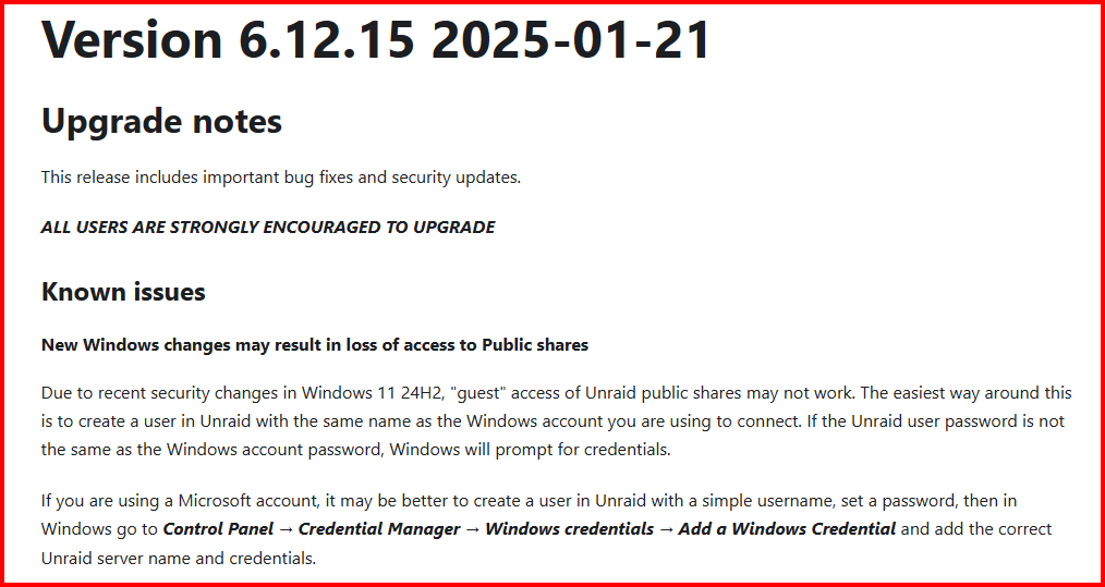

Do this to set up a Share Access user on your Unraid server with a Windows Credential on your Windows 11 computer:
Guest access is now more difficult to setup then setting up a secure login using Credentials.

With a fresh install of Unraid, you also lose some 'Grandfathered' settings which make using Guest access much simpler.

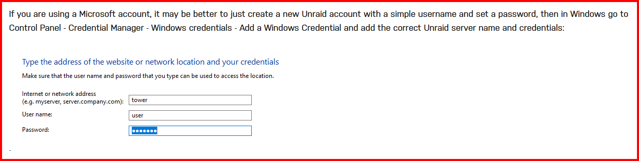

I went in as you said above, created a credential that was my user and password on the server.

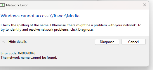

Pic 3 is how I start with using different cred's. It ask for my cred's to Tower...no problem entering those...then ask for Tower password...no issue entering BUT

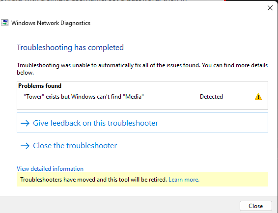

Pic 4 is what I get after entering cred's.  Diagnostics states Windows can't find. When I run diagnostics, it comes back with Pic 5
Perplexing that it sees it but can't see my share. I suspect it's one little setting I'm missing. I've gone back into UNRaid and all looks fine but......

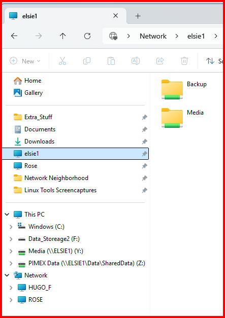

One more thing.  You may want to add your servers to the quick access list in Window File Manager.  How to do this is explained the attachment (An Alternative Method to Network Neighborhood.pdf) in the first post of this thread.
https://forums.unraid.net/topic/110580-security-is-not-a-dirty-word-unraid-windows-1011-smb-setup/
Windows File Manger with quick access links to my Unraid server looks like this:
Notice that the Unraid server 'elsie1' does not even show up under "Network"!  ('ROSE' is my other Unraid server and 'HUGO_F' is a Windows 11 Pro running peer-to-peer sharing.)   Why all the servers don't show up is a question to which no one seems to have an answer.  Tomorrow, 'elsie1' may be there.........     In my experience, the quick access link will always worked.  I don't even look under "Network" for a server anymore.
In case you are wondering, that 'Network Neighborhood' is a quick access link to a folder on my desktop that contains shortcuts to nine different computers-- The two Unraid servers and seven Windows computers in a Windows peer-to-peer setup.
