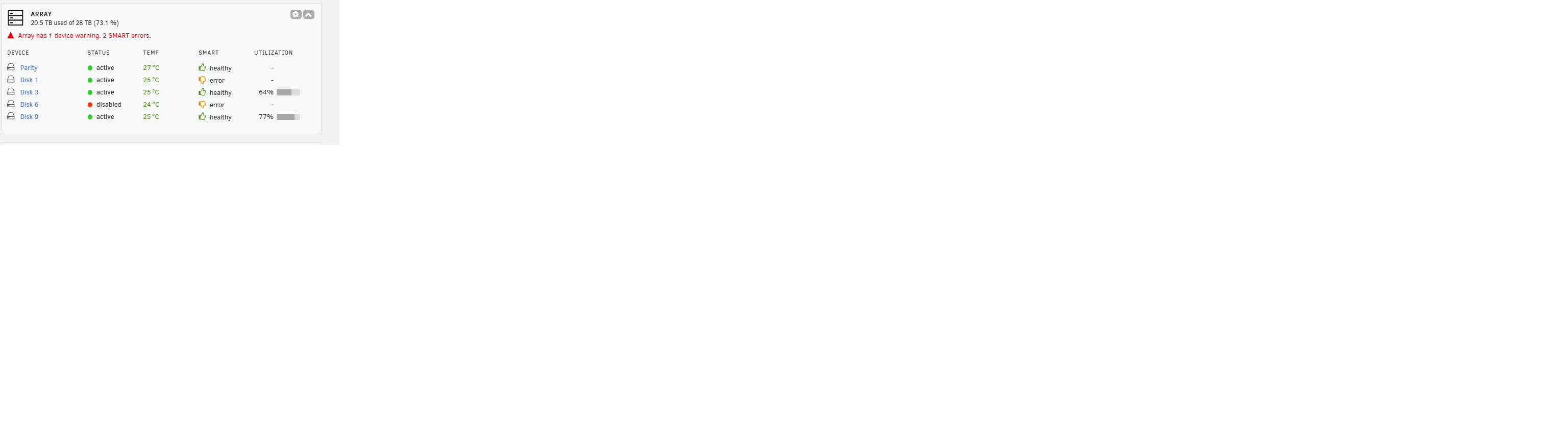

tdk-diagnostics-20250506-1012.zip
Go to Settings - Docker and disable. Go to Settings - VM Manager and disable. Leave them disabled until everything is working well.
Looks like you have let disk1 deteriorate to the point that it maybe can't be trusted to rebuild disk6.
Do you have Notifications setup to alert you by email or other agent as soon as a problem is detected? You should have been getting notifications about disk1.
Disk3 has had a lot of connection problems, but is probably OK otherwise.
Disabled disk6 is also probably OK. Most likely a connection problem disabled it, but that was before reboot so can't see anything about that in current syslog.
All plugs must sit squarely and firmly on all connectors, with plenty of slack in the cables. Don't bundle data cables.

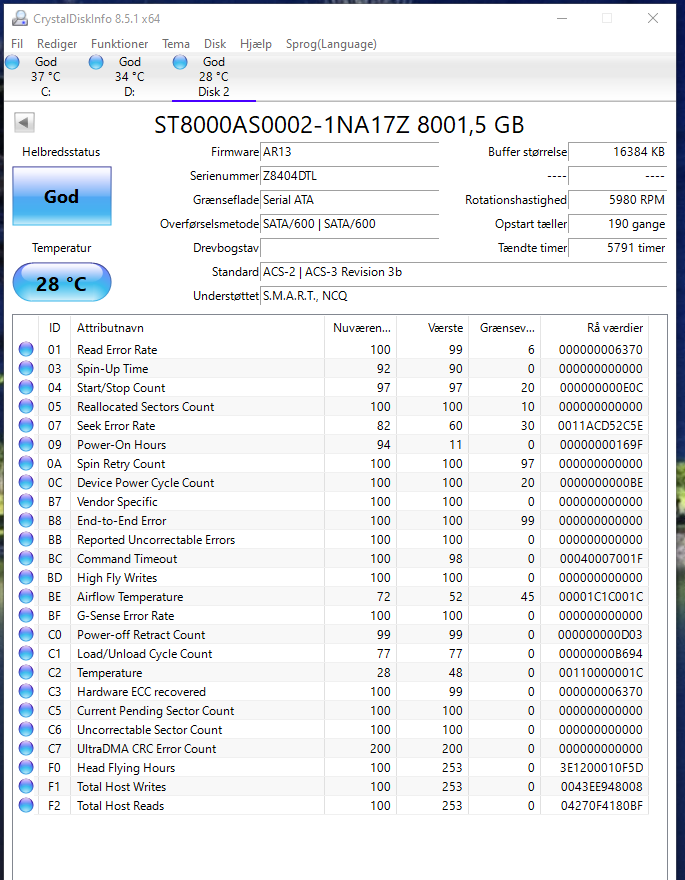

I have a spare disk - one that I pulled out of the setup, as it also made some errors :D But, in windows, its all good. I could try and swap disk1 out with that.
There is not written to disk6 efter, but I have tried to pull data from it, and it work in the begining, but after lige 2 hours, disk 1 startet to act up.
Is this the way to go, or what do you think?
Can you plug that spare in and post a SMART report for it?
Sure thing - this is from my Windows pc, CD: image.thumb.png.d1128e5e83eba442631f195f760ecb62.png
Hope thats good enough, or else just guide me in the right direction :D
Not entirely clear since that isn't my language. But from the model I assume it is 8TB just like disk1?
SMART looks OK.
SMART looks OK.

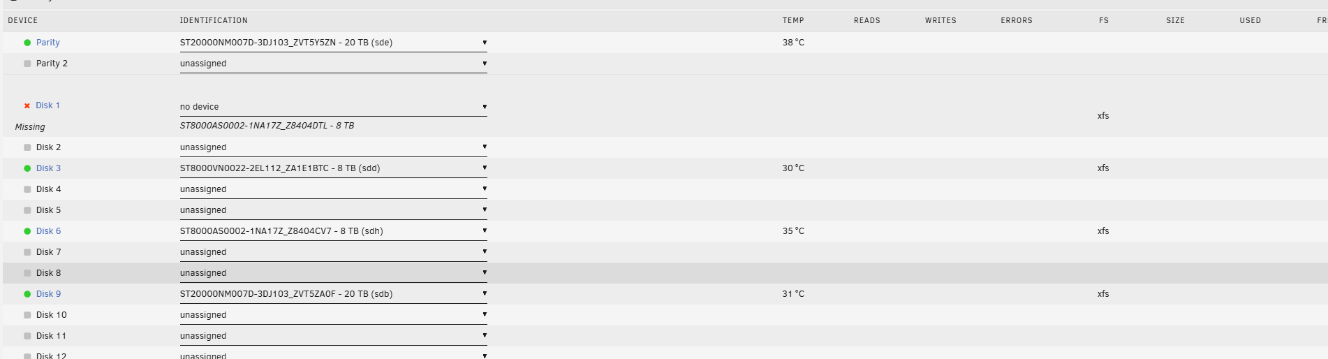

So, I am ready from now on, and a little bonus info:
I have a spare cable I can plug the 'new' disk to, so that all disks can be in the server at all times, if needed.
Install the new disk that will replace disk1.
Go to Tools - New Config, Retain All. Apply
Assign new disk1. Make sure all other assignments are correct. Reassign disk6 if necessary.
Very Important. Check BOTH Parity Valid checkbox AND Maintenance Mode checkbox, then Start the array. This will accept all disk assignments without doing anything else.
Stop the array. Unassign disk1. Start the array in Normal (not Maintenance) mode without disk1 assigned. This will disable and emulate disk1.
Then post new diagnostics.

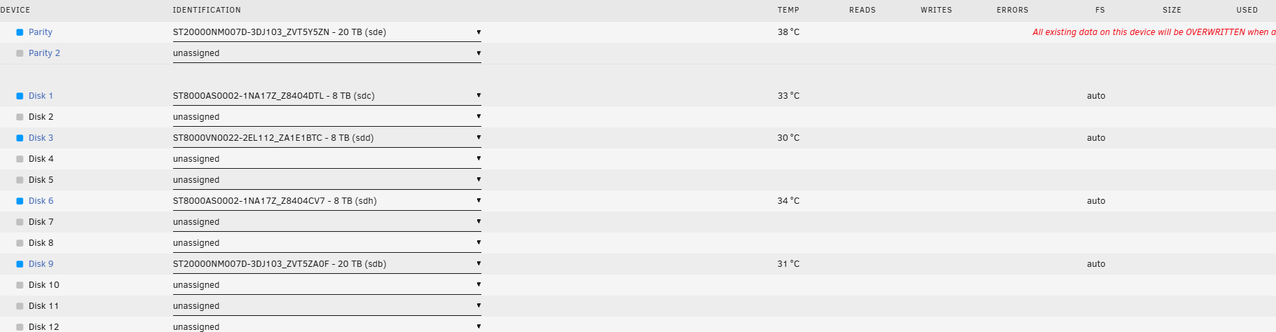

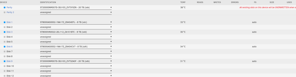

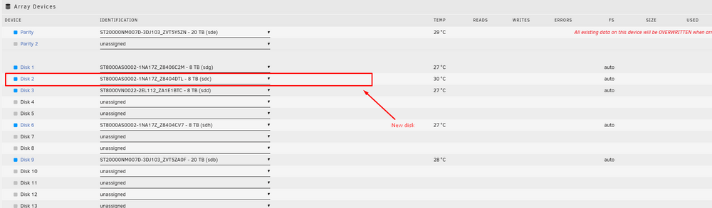

Alright
Just to make sure I have done it all correctly, ill just need a final confirm, so I dont screw this up :D
No that's totally wrong.

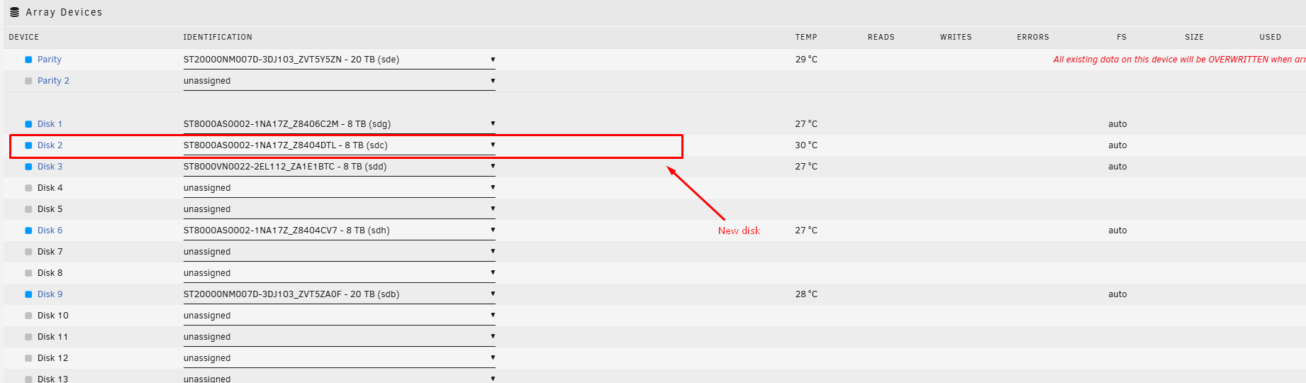

Looks like you have assigned a new disk2. Parity isn't in sync with anything in the disk2 slot. You should have only disk1, disk3, and disk6 as before, except with a new disk assigned as disk1.

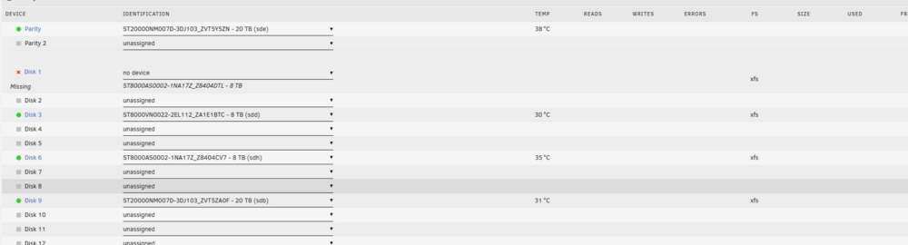

Here we go:
Disk 9 have always been there aswell, just to make sure we are on the same page on that :)
Yes, that's right. Then start from here:

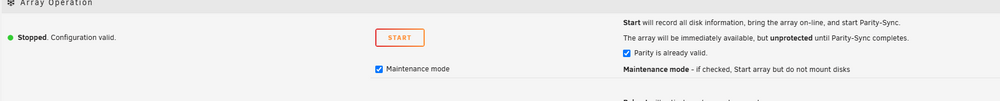

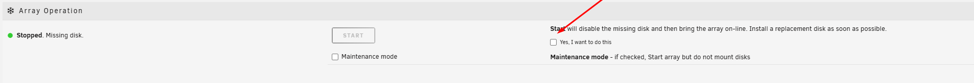

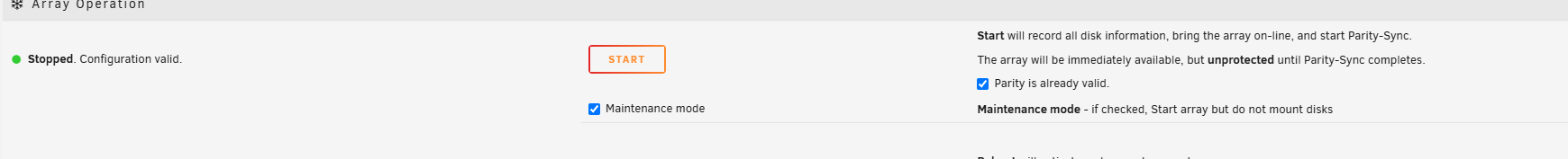

Alright - just making sure this is correct.
I have started the array with both box checked, stopped the Array and now I am here:
Im guessing I wanna check that, as thats what it needed to be able to pres 'start' - just want to make sure :)
Agian, so glad you have the time to help me with this, as I would otherwise be soooo lost :)
image.thumb.png.fee6942bbb98ba7348d731283a165782.pngimage.thumb.png.7f2873e4379fc328646ca76e751bcf82.png
Yes, that's right.
