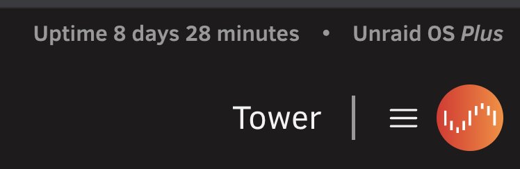

Dare I say updating it to 7.1.0 fixed it? So far seems to be running stable now again, phew. I also disabled the Mover plugin I had running which fixed the Mover issue I was having too. I guess 7.0.0 didn't like AMD systems heh.
Server hasn't been up this long since September haha.
