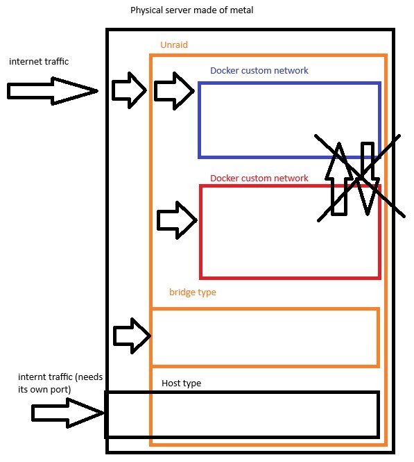

August 30, 2025Aug 30 Sorry to revive this conversation, but... reading up onOn 5/14/2025 at 2:25 AM, tictoc said:More info here: https://docs.docker.com/engine/network/I was curious to see that this documentation does not explain "custom" networks. I suppose custom networks are something that belong to each OS. So here's my question -- docs.docker.com explains that networks have a type, either bridge, host, none, overlay, ipvlan, macvlan. So is there a custom Unraid type of network? As I understand it, my Unraid server's network card has an IP given from my router's DHCP server. Usually, you'd have 65000 ports, but creating a network inside Unraid basically forwards the traffic from the NIC's IP/port combination to a virtual software network created by Unraid, kinda like a VLAN. This means I'd have an extra 65025 IPs to draw from, each with 65000 ports? So I create a new container, I choose this custom network, and Unraid auto-assigns an IP within the range created, correct? And this Unraid network doesnt allow Docker containers to speak to each other outside of this network, correct?I'm just trying to validate my understanding of all this.

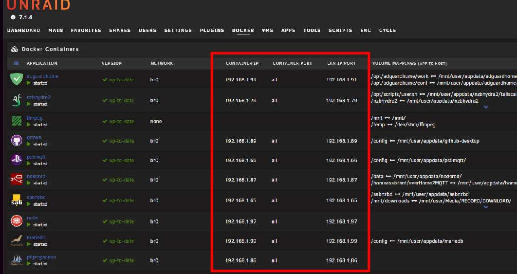

August 31, 2025Aug 31 8 hours ago, Squid said:ipvlan / macvlan - Basically the same as Host in that the container has access to every port except that the container is on it's own separate IP address instead of being the server's.little extensioncustom br0, eth0, ...ipvlan > all dockers with individual ips on the main subnet, with the SAME mac addressmacvlan > all dockers with individual ips on the main subnet, with the UNIQUE mac addressesdespite on recommended using ipvlan, depending on the network hardware in use @home, ipvlan will result in conflicts reaching services as routing can rely on mac address, if all using the same mac address ... services are not really usable.so when using all services like here (all services with unipque ip's, listening all on their native ports) as samplei have to use macvlan as my hardware enviroment rely on mac addressing.
