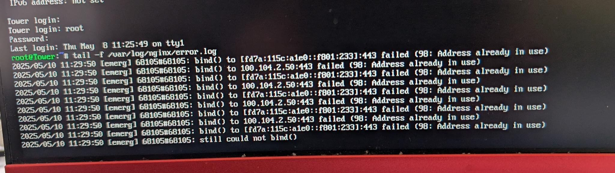

This is my Nginx error.log. Maybe a problem with IPv6 or Tailscale?

5 hours ago, JorgeB said:
Changing PORTSSL to 4445 in /boot/config/ident.cfg and restarting Nginx daemon helped. Now the unsecured port 8084 works again. Thanks, @JorgeB!
