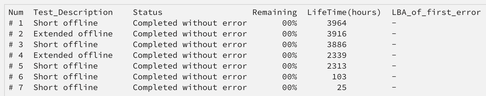

I performed one Short S.M.A.R.T. test and one Deep S.M.A.R.T. test after this warning, but it doesn't report any error:

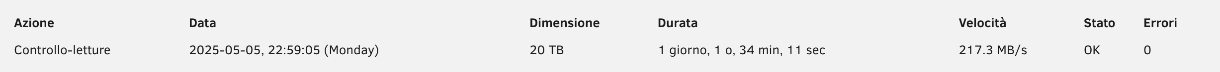

I also run a Read-check but no issue has been found:

Since the extended SMART test passed, and assuming those reallocated sectors already existed, the disk is OK for now, up to you if you want to keep it or replace now, if it were me, and the number of realloc sectors remains the same, I would keep it for now.

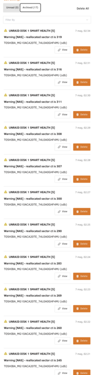

The situation is getting worse quickly, I've received 17 more "reallocated sector" notifications:

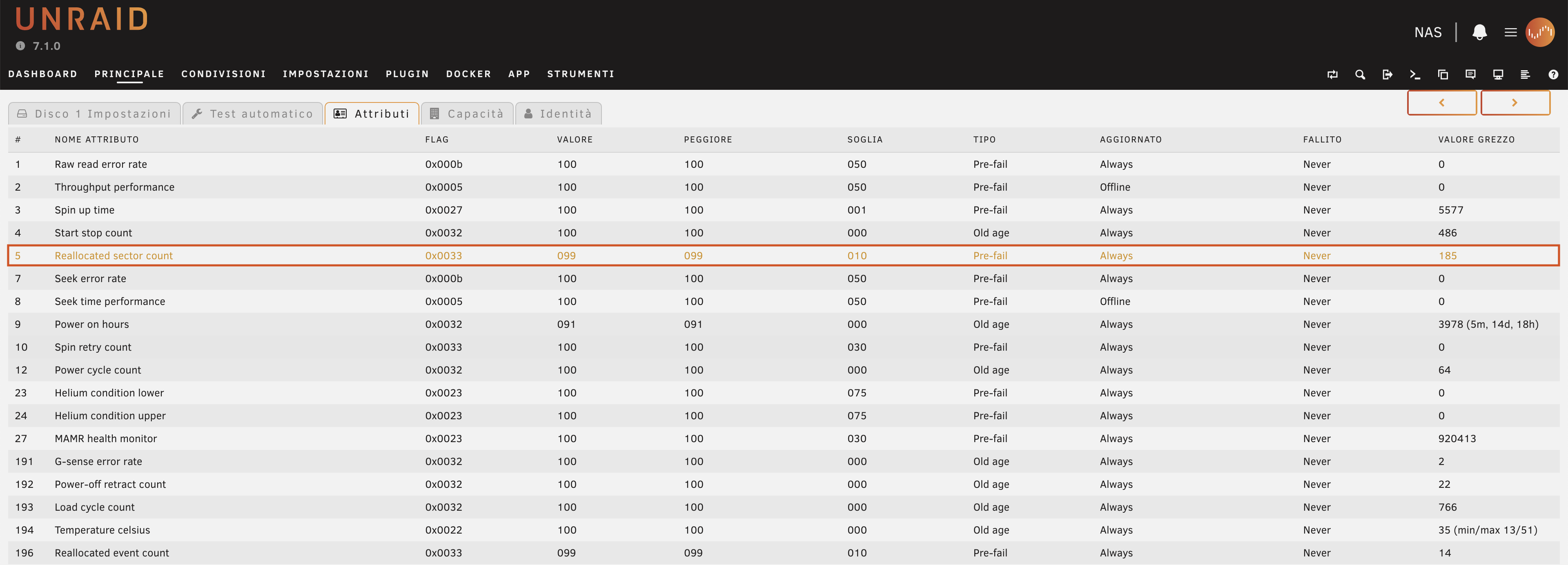

This is the actual disk status:
I don't have a parity disk so I assume it would be better to get a replacement disk.
What do you think?
Yep, ASAP
