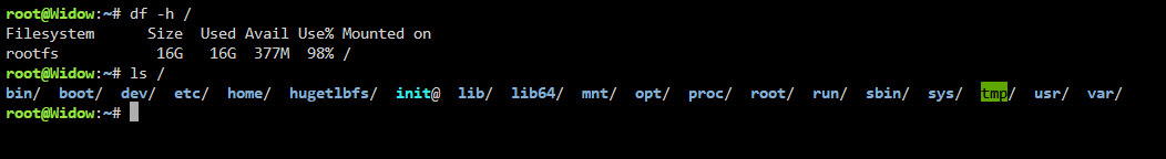

What do you get from command line with this?
df -h /
and this?
ls /
df -h /
and this?
ls /
I get this, It's been locked at 98% since I removed the ram disk.
