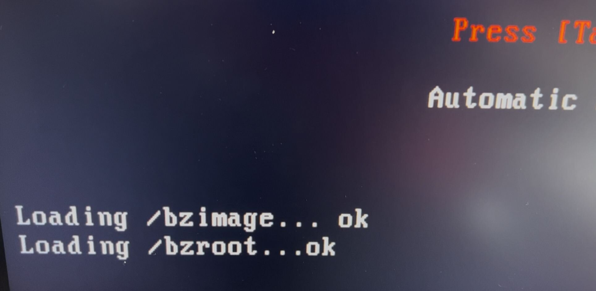

Hi, I've just tried with fresh 7.0.1 install, same issue.
I still have (see attached file)
Loading /bzimage... ok
Loading /bzroot... ok
Then nothing and it reboots indefinitely.
Look for a BIOS update and/or reset the CMOS, if nothing helps, I'm afraid that you may need to stay on 6.12 for now, try again once a new release is out.
Thanks a lot, it is working now. 😀
After updating the BIOS, I was able to update and boot to 7.1.0
