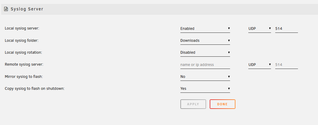

And post a screenshot of those settings

Syslog server can receive syslogs from other servers. You have to fill in the Remote syslog server field to tell it which server to receive them from. It can be localhost.
Adjusted to now show localhost as the remote field.
After crash, get it from Downloads, zip it, and post it.
You can check that folder to see that it is writing syslog there now.
