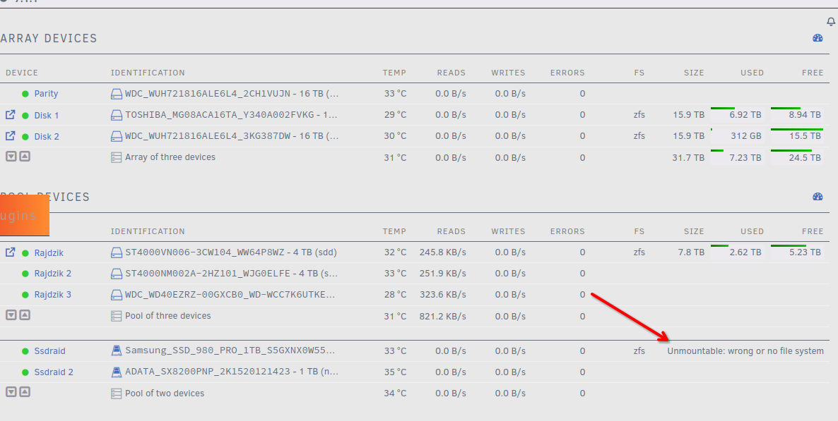

I did an upgrade from Unraid 7.0.1 to 7.1.1. Before the upgrade, everything worked fine for weeks. The upgrade went without any problems, after rebooting the server I ran the array and found that one ZFS pool was broken: "Unmountable: wrong or no filesystem".

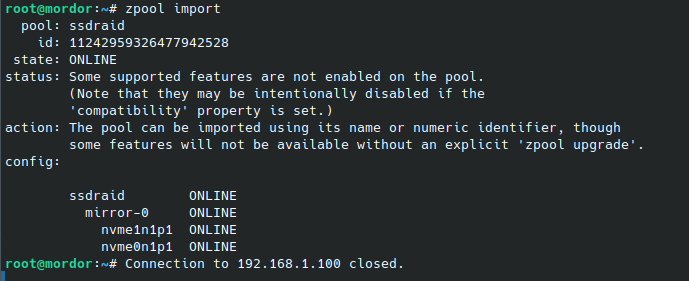

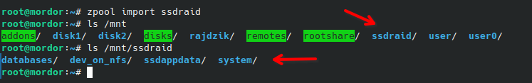

After execute import the pool:
But in IU the pool is still unmountable:

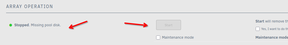

After remove drive (by echo) the device disapear but the array can't be run without it:
Check
1 hour ago, JorgeB said:
That looks normal, the easiest solution for now, and since the pool is a mirror, would be to reimport the pool degraded, then wipe the other device and add it back to recreate the mirror, if you want to do that, see below, other option is to downgrade to 7.0.1 for now.
Stop the array and offline the device with the "bad partition" by typing
echo 1 > /sys/block/nvme1n1/device/device/remove
Wait a couple of seconds and refresh the GUI, that device should now be missing, start the array with the remaining pool device and it should import the pool degraded
After start Array the pool is not degraded, it's look ok, but has only one disk now:
Is this a good symptom?

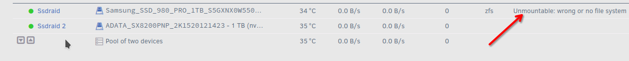

It's getting worse... strange things are happening. Suddenly the disk is too small!
How is this possible? The two drives had been stacked in an array for many months.
Edited by jaclas
Sorry, I missed one device was smaller than the other, they were both showing as 1TB on the screenshot, my suggestion would be to create a new zfs single pool with the smaller device, copy everything from the other pool to that one, then remove the larger pool and that add device to the smaller one to create a mirror.
