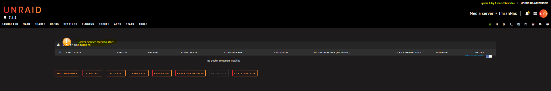

Docker Service failed to start after update to version 7.1.1
I'm running into a problem on my server getting the above error after webgui crash
all ready reboot the server and delete the docker.img file and reconfigure all my docker service
but the webgui crash and i have restart the gui using "/etc/rc.d/rc.php-fpm restart" command

after letting the nas running for 1 day,
again encounter the error "Docker Service failed to start" where all the docker is up but inaccesible
attached the diagnostics file
imrannas-diagnostics-20250518-1413.zip

Docker service appears to be running normally, not sure why the GUI complains.

5 hours ago, mrunknownpbu said:
Hi Jorge
webgui was unresponsive
attached the new diag
Can you uninstall the connect plugin, reboot and then try again.
Reason for the unresponsive gui is a file that was required is missing...  Not quite sure how though.  If that fixes the unresponsive, then see if the docker tab is working.  If / when it fails, and you can live with it until I notice a response from you, then I might have some ideas, or troubleshooting ideas that might help with what's going on...
