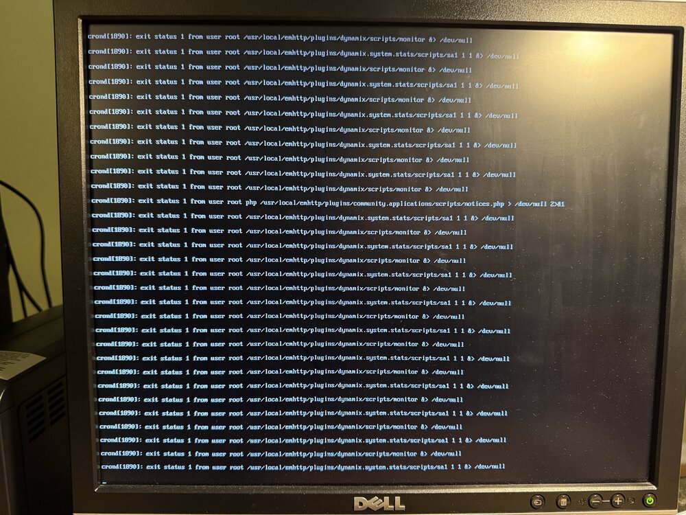

I tried to shut down the server and it's now stuck and displaying these messages:
crond[1890]: exit status 1 from user root /usr/local/emhttp/plugins/dynamix/scripts/monitor &> /dev/null
crond[1890]: exit status 1 from user root /usr/local/emhttp/plugins/dynamix.system.stats/scripts/sa1 1 1 &> /dev/null
I'll try a hard power off then try to disable the plugin it appears to refer to.

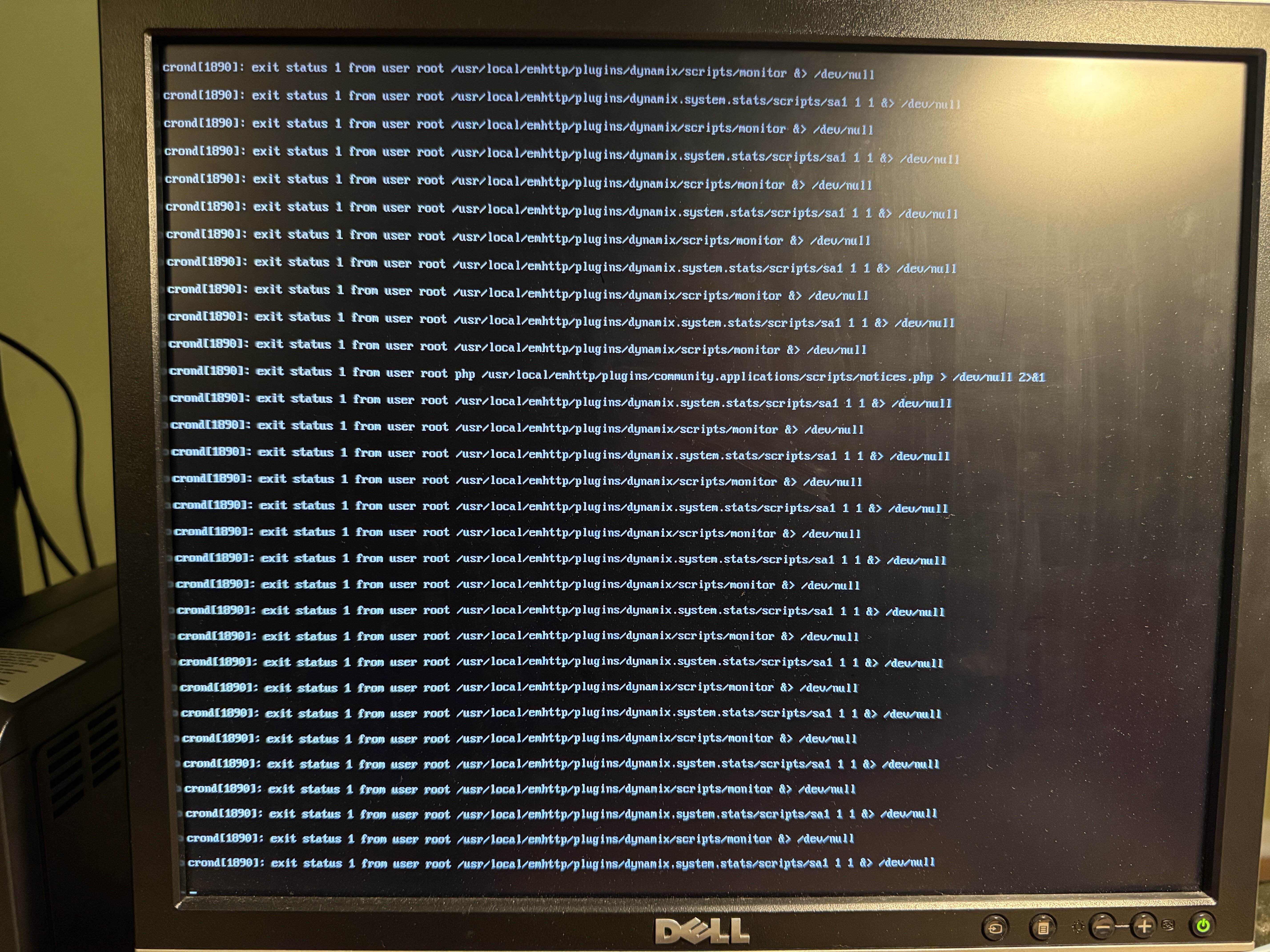

It crashed again. Some containers are running like Qbittorrent.
The console of the server shows "unraid exit status 1 from user root /usr/local/emhttp/plugins/dynamix/scripts/monitor &> /dev/null" and "unraid exit status 1 from user root /usr/local/emhttp/plugins/dynamix.system.stats/scripts/sa1 1 1 &> /dev/null.
I see that dynamix.unraid.net.plg was updated last Saturday.
Powering off and will try to remove the system stats plugin.
