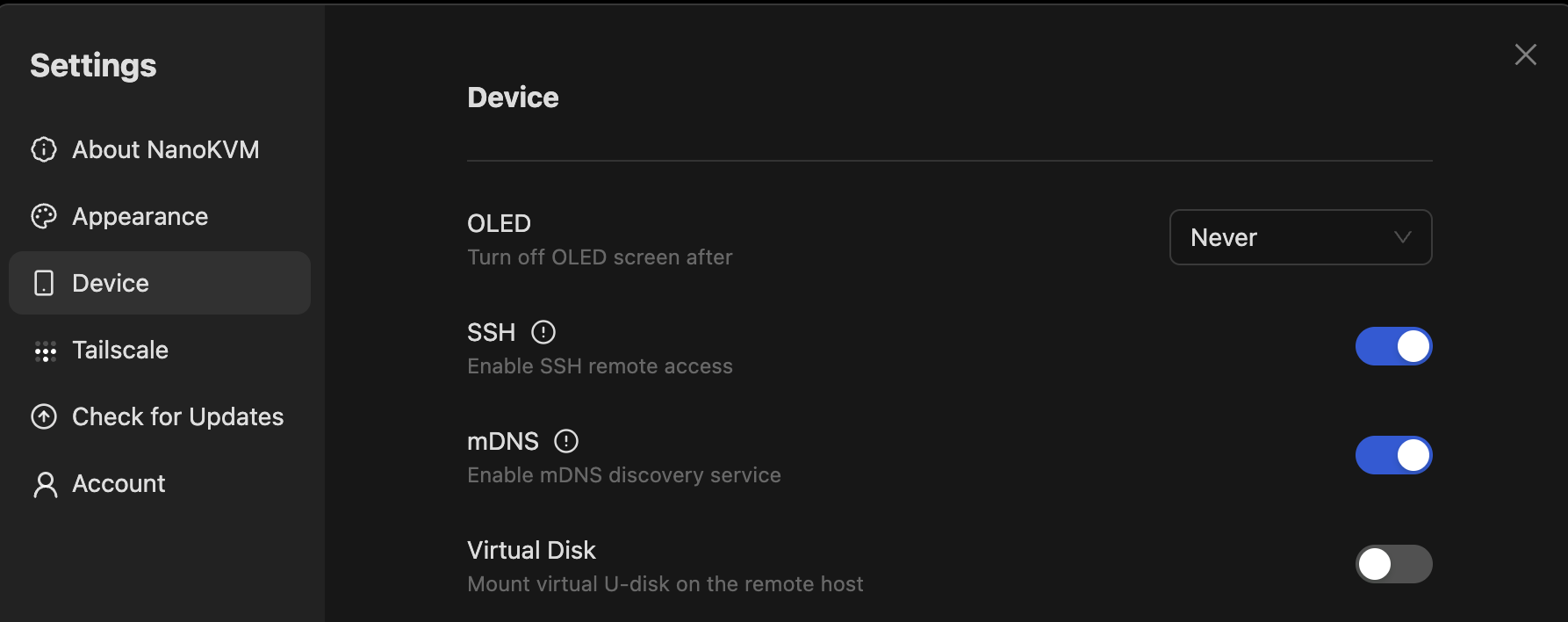

That's exactly what the problem was. Awesome.
Didn't know what this error message means. Good to know now.
If anyone else is having the same problem. You can disable the virtual disk in the settings
Thanks for the help, it works now
