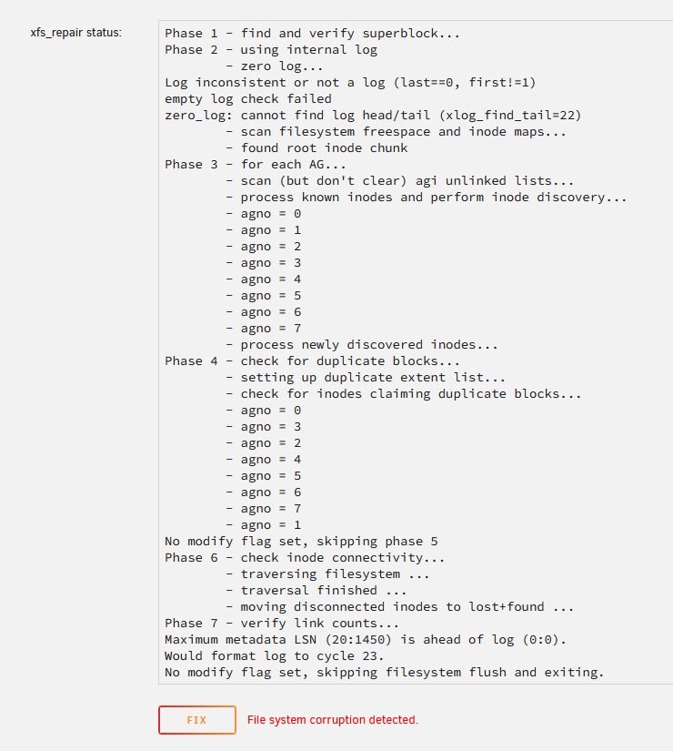

SO I got to the check filesysystem part and got this...
Phase 1 - find and verify superblock...
Phase 2 - using internal log
        - zero log...
Log inconsistent or not a log (last==0, first!=1)
empty log check failed
zero_log: cannot find log head/tail (xlog_find_tail=22)
        - scan filesystem freespace and inode maps...
        - found root inode chunk
Phase 3 - for each AG...
        - scan (but don't clear) agi unlinked lists...
        - process known inodes and perform inode discovery...
        - agno = 0
        - agno = 1
        - agno = 2
        - agno = 3
        - agno = 4
        - agno = 5
        - agno = 6
        - agno = 7
        - process newly discovered inodes...
Phase 4 - check for duplicate blocks...
        - setting up duplicate extent list...
        - check for inodes claiming duplicate blocks...
        - agno = 0
        - agno = 3
        - agno = 2
        - agno = 4
        - agno = 5
        - agno = 6
        - agno = 7
        - agno = 1
No modify flag set, skipping phase 5
Phase 6 - check inode connectivity...
        - traversing filesystem ...
        - traversal finished ...
        - moving disconnected inodes to lost+found ...
Phase 7 - verify link counts...
Maximum metadata LSN (20:1450) is ahead of log (0:0).
Would format log to cycle 23.
No modify flag set, skipping filesystem flush and exiting.

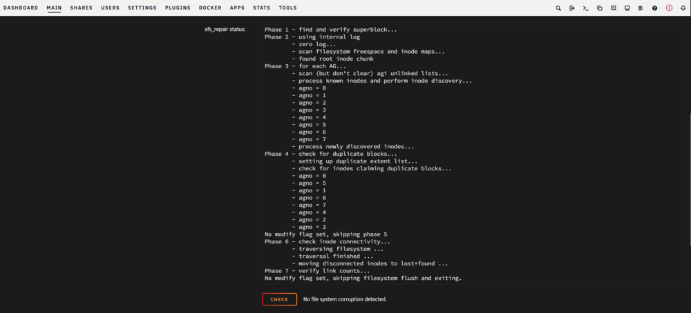

9 minutes ago, trurl said:
FIX
Awesome, So I did that and everything looked to have workout, however, that drive is still disabled, how does one enable the drive\

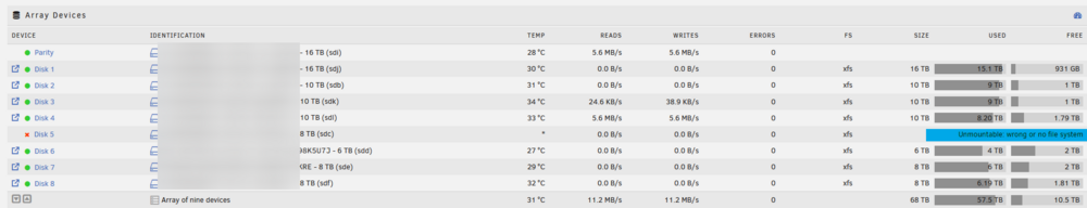

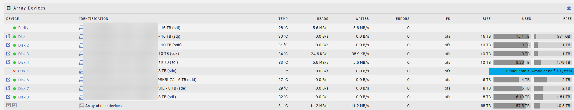

Ok so I mounted it and all seems ok! It does however have a warning icon, should I be worried about that?firefox_Lr0rKcLGjJ.thumb.png.5ec1a28ffce2905fe1811be12713e428.png

1 minute ago, Tuntira said:
I mounted it
You mean you reassigned it. "Mounted" has a special meaning. It means the OS has loaded the filesystem to allow access.
The warning icon (mouseover) just means the disk is still emulated. Emulation is how it gets the data for the rebuild using the parity calculation with all the other disks.
https://docs.unraid.net/unraid-os/overview/nas/#parity-protected-array
It will be emulated until rebuild completes.

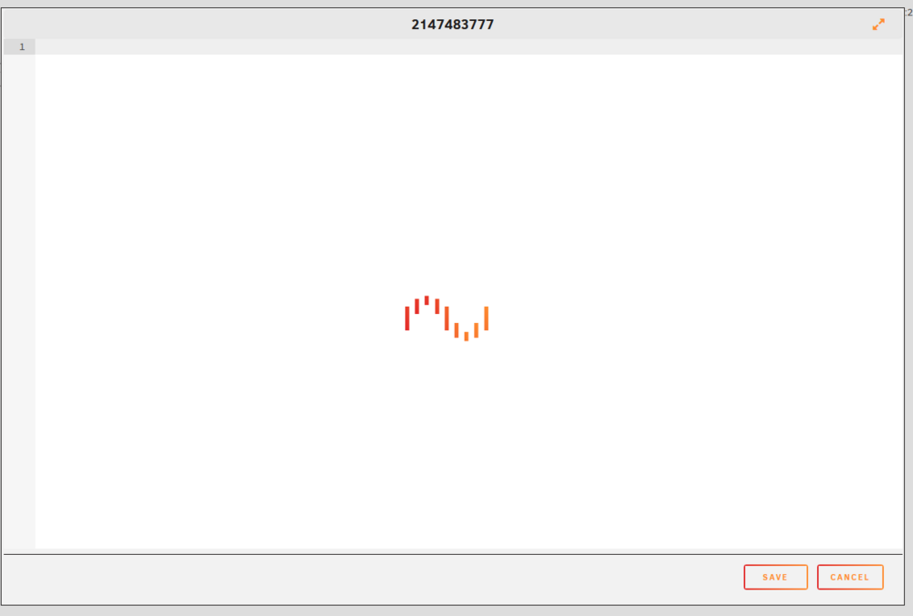

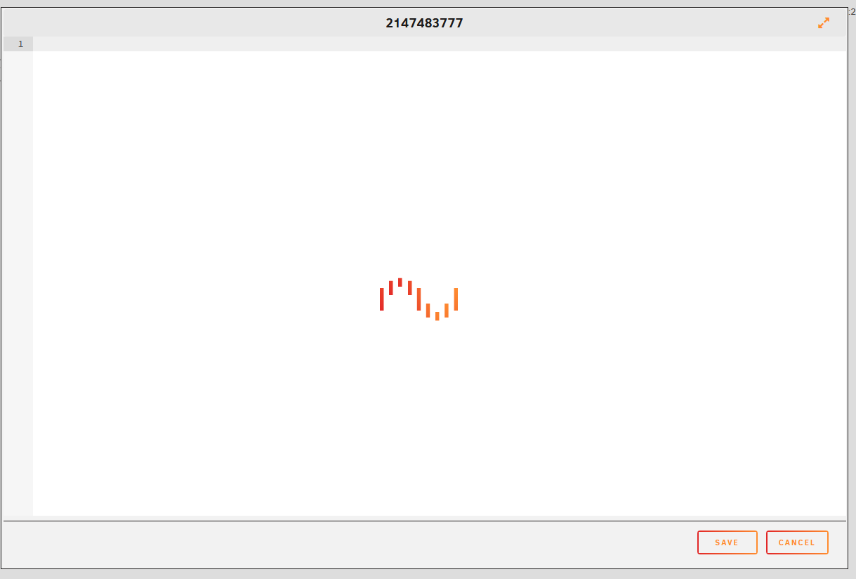

With regards to the lost+found, I haven't as yet, I went to the folder and it is currently loading. see attached

Unfortunately this didn't give any info whatsoever
