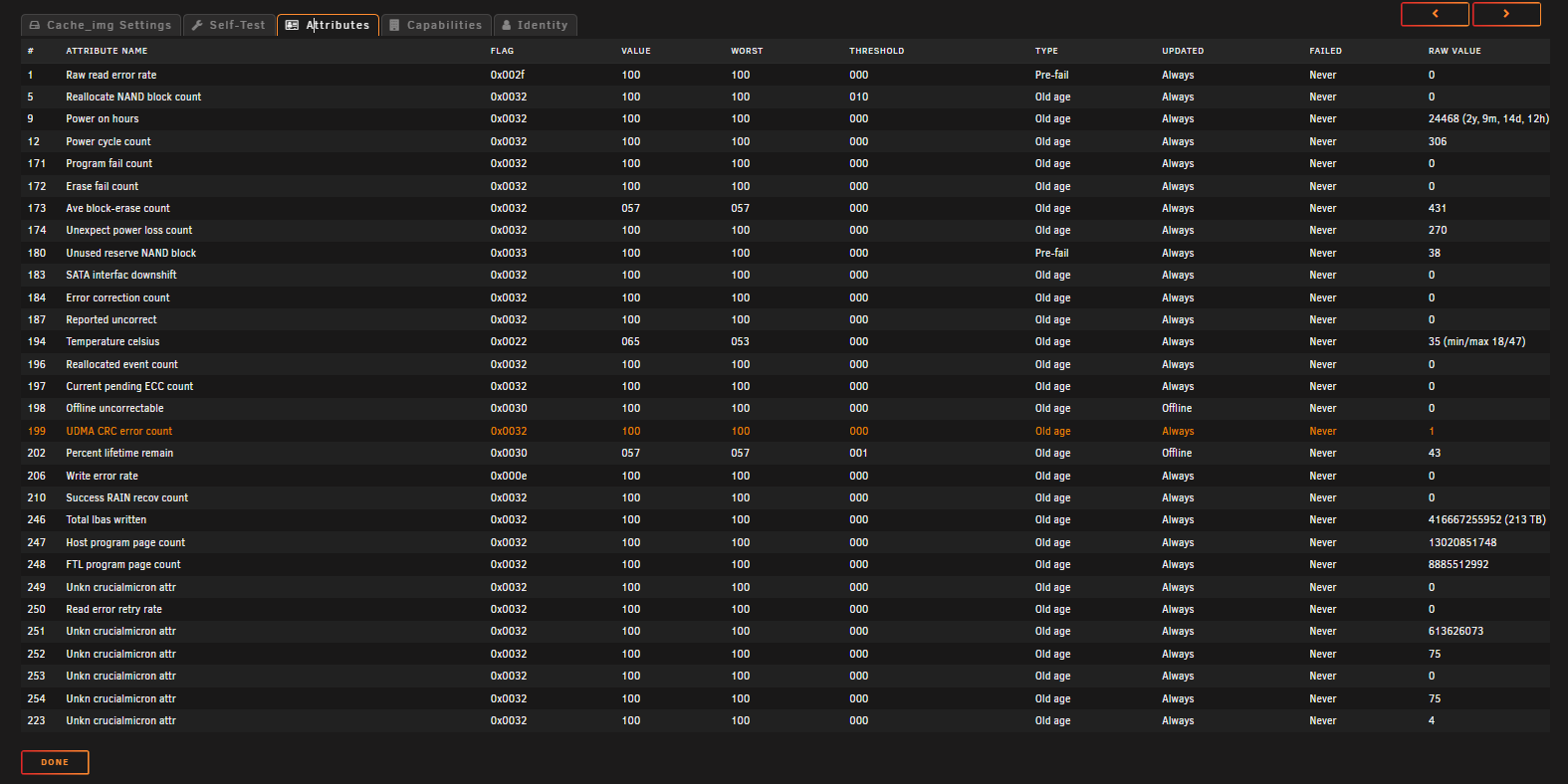

Just one other, an SSD in one of my Cache Pools, but it's had an error for ages and I assume unrelated. Need to get it sorted, but it's in a pool and a low value drive/content so not a priority.
Any point in trying to recover the failed drive do you think?
UDMA CRC ERRORs are bad connections, doesn't look like it has increased so I wouldn't worry about it. You can click on the SMART ( 👎 ) warning on the DASHBOARD page to Acknowledge and it will warn again if it increases.
